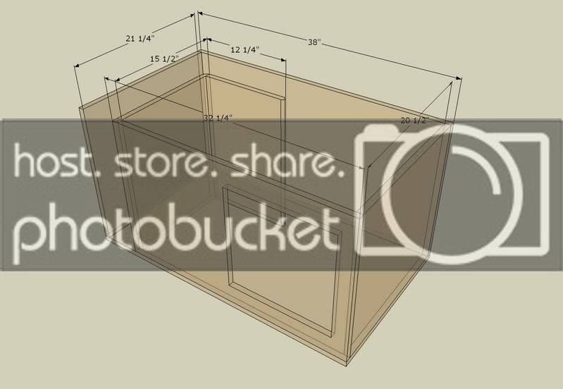

ok i was given a design for a box from fpfuror. The box was slighty wider than i am able to fit in my trunk, i was wondering if someone could help me make an adjustment to the design:
Slot Port X Y QTY
Top / Bottom 38.00 22.00 2
Back 38.00 19.50 1
Face 32.25 19.50 1
P side 21.25 19.50 1
O side 20.50 19.50 1
Port1 15.50 19.50 1
Port2 12.00 19.50 1
this is 6 cu/ft @ 32Hz with 97.50 sq/in of port (port with is 5")/
if i want to make it 2 inches shorter (to 36") how would i need to adjust the port to compensate and remain tuned to 32hz???
any help would be greatly appreciated

hmm that looks pretty **** close to the box that I made for my 18" BTL. Its 36" wide too. I'll check my cutout sheets.
im sorry my box needs to be changed...
i re-measured my trunk and the largest that can fit is within 34x17x22 (w h d)
if anyone could design me a box that large for a 15 L7 tuned to 32hz i would be eternally grateful to you
just confirming that this will be allright, i think its a perfect box design, the L7 is exactly the right size for the front baffle
my.php
^^ I was going to message you that same thing.
BTW, I get somewhere around the following w-w/o driver displacement.
without
Net Volume: 4.34 cu/ft
Tuning Freq: 32.56 Hz
with
Net Volume: 4.14 cu/ft
Tuning Freq: 33.34 Hz
