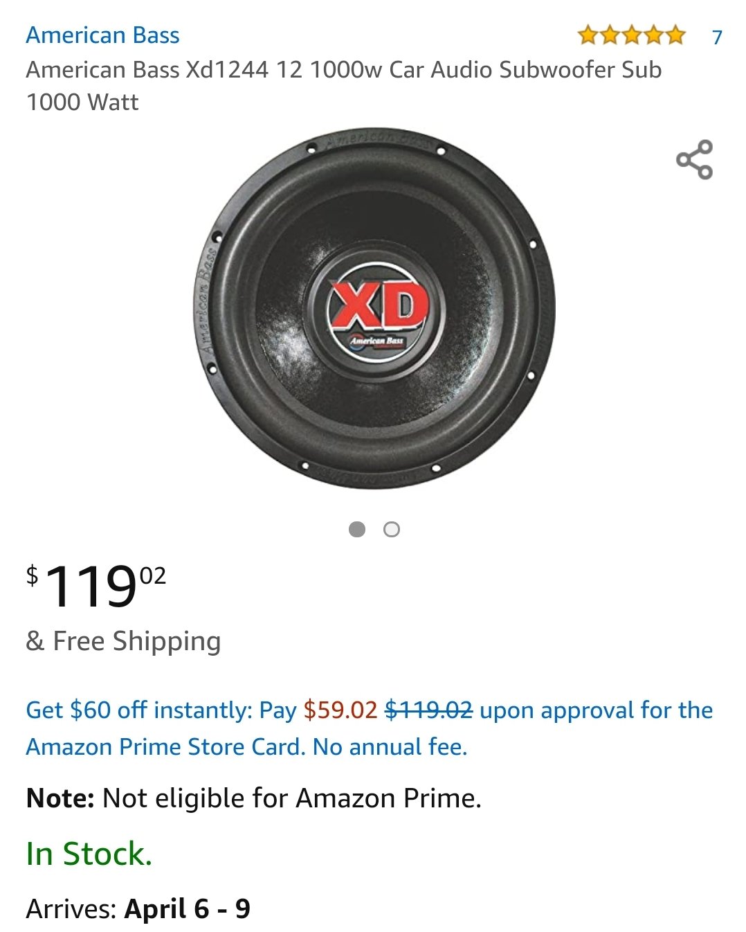

One of these in a ported box. It's a 500w rms sub.
