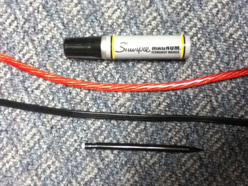

Hey guys. Recently, I purchased some wire from a friend who retired from car audio and had some (what he claims to be) 1/0ga wire running for his power wire. Well, I haven't paid for it yet, but I didn't think it looked like 1/0ga wire. After looking at it, it reads '5+ GA High Current Oxygen-Free wire". I've never heard of 5ga wire, much less 5+ga wire - what does this mean? Will this be enough to run 1000w through from my amp for my power? How does the oxygen-free part play a role? Thanks for the input, fellas.
The red one's the wire. Beside it are, from top to bottom:
A Sharpie Magnum marker
The wire
A typical outlet cable
A typical mechanical pencil
Was it Scosche?
I have both 5 and 4 gauge mid-90's Scosche wire. The 5 gauge is actually comparable to other companies' 4 gauge wire, while Schoches' 4 gauge at the time was huge, almost the size of 2 gauge.
Meh.... never heard of it. Assuming it's actually Oxygen Free Copper and 5+ GA is close to 4 gauge, then it should be fine for 1kW.

Yeah, it's made by Scosche. But it's not too big, I could post a picture if you want a size comparison. Then maybe you guys could help me on the judgement..
I have some downstairs, it is exactly the same size as my Rockford and Cadence 4 gauge wire.
Well, if it's 4ga, it should suit me fine, I'm only running about 950w RMS through it down the length of my car. I posted a picture in case you wanted to see some size relevance.
