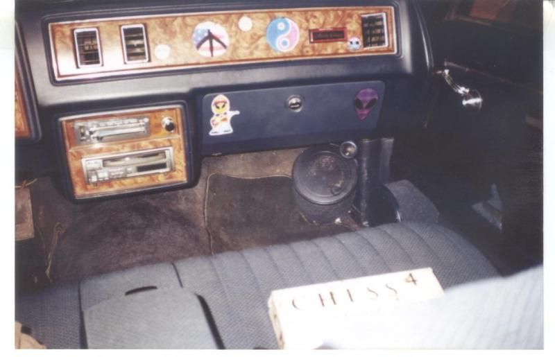

Speaker installation in a 1982 Malibu. Did this in 1999. This was my second vehicle and first attempt at a decent system.
Front
Stock: 3.5" in dash.
What I did:
6.5" Massive Audio CK6 in/on kicks - sealed
6.5" Orion XTR midbass in/on doors - vented to door
Rear
Stock: 4x10
What I did
6.5" Alpine components on rear deck - sealed
Subs
(2) of the Hollywood HSL's in a custom enclosure (by me) that fit on top of the tray under the rear deck (had to remove rear seat and remove metal to insert from the front). it was angled to match the rear seat angle and be in front of/under the torsion bars. no pics of this.
Amp
xtant 3300x (ran all of it with passive crossovers) mounted in a custom false floor with a door and ventilation. no pics of this.
HU:
several. pictured was the 3-disc in-dash changer. i also ran the 7930.

The good stuff. I bet it sounded awesome.
yes it did. less bass than the Regal, but a ton more musical detail and music volume.
the funny part, and the reason i haven't posted this before, is how i made those mounts.
cardboard tubes. reinforced with chemicals for water resistance and hardness. speakers were foam sealed to the ring and secured from behind with screws. carpeted to match, painted grills to match.
oddly enough, it looked decent.
