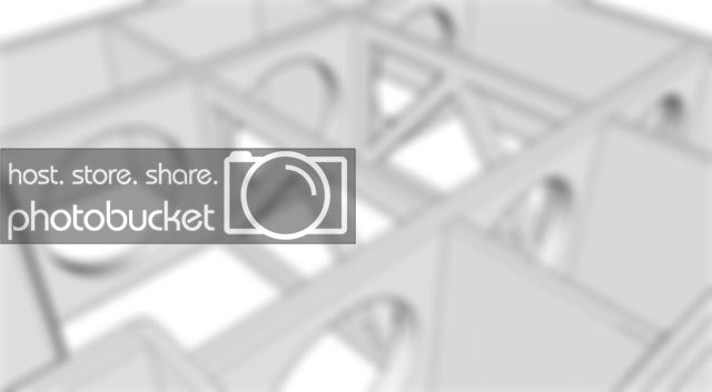

It seems the 2 subs on the right have 2 sealed boxes? AKA air cant get out?
If its just a mess up in the drawing with the subs facing each other, it looks good. Exactly how the bandpass in my van is. //content.invisioncic.com/y282845/emoticons/smile.gif.1ebc41e1811405b213edfc4622c41e27.gif
I asked a few guys on the term pro forum and on some other ones and they said the foam tape stuff ***** for sealing. Dont worry the 2 middle boards are braces that weren't drawn out completely in that box.. It is a true 4th order so no worries. Here's what it looks like somewhat:
