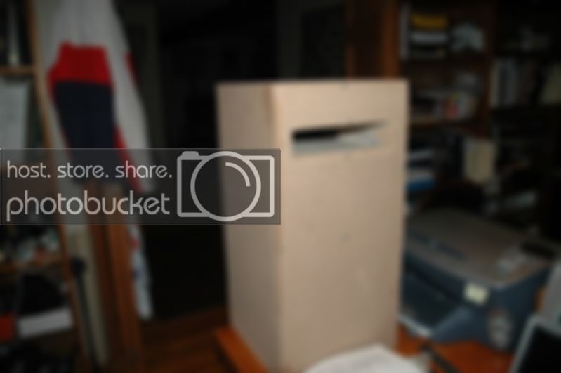

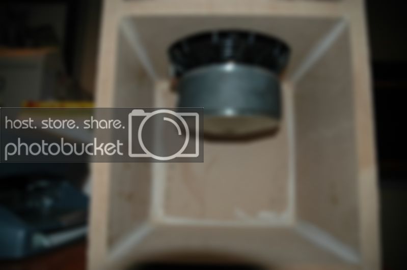

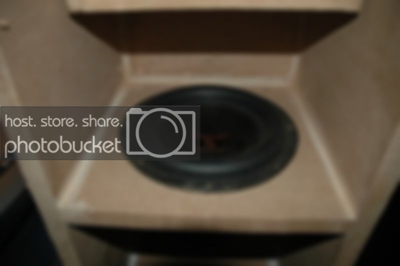

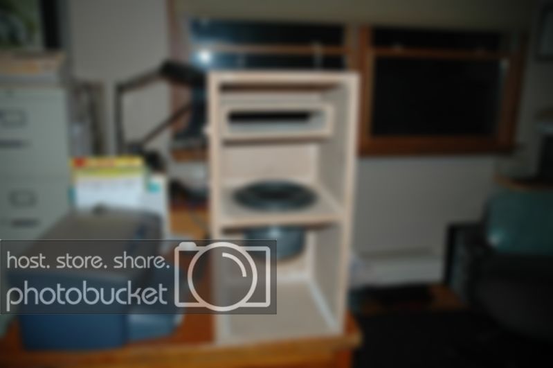

Ok i finally got around to this. I had 80 design me a 4th order bandpass for my dads Rl-i. Its gunna go in his suburban eventually. Its tuned to 83 and has a -3db at 29 hz. Heres some pics. Kinda forgot to mount the sub bofore i put the port in so i gotta work that out.
well the output is tons more than the sealed and ported on Sway by Lost Prophets. Im impressed even though its one on 60 watts playing full range right now.
just made a test tone cd and holy **** it ****ing kills from 40-100 then is still great 30-40. Its off my cheapo home stereo thats supposed to be min load @ 6 ohm. Still gotta seal it all off so ittl get even better.
