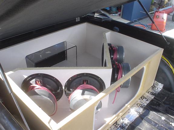

So im planning on sometime soon possibly building a 4th order for my 2 vvx-10's and Im curious what gross cubic feet would be appropriate for a 4th order for 2 vvx-10s? I was thinking 5 cubic feet gross which with double baffling would leave around 2.25 cubic feet on both sides of the box. This is the style I would like to build if i do:
Going in a '95 3000gt btw. Thanks for the help
I can't speak specifically to the Skar, but I've has great luck with .5 sealed and 1.5 ported tuned to 49hz for 10's.
I don't know how much you want to play with it, but .75 will get you a little more low end and probably a little flatter response.
