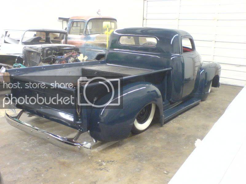

My cousin has a 49 GMC and I put 2 6 1/2 Boston acoustic components in sealed enclosures and a jl audio 8w1 in a sealed box. Running off an old 4ch MTX. For input i he uses his ipod, and a small switch for remote. The only reason I was able to run the sub was becuase he has his gas tank in the bed.
The truck is loud and being all metal with no damping material anywhere, he usually has to turn it up, but everything is still really clear and sometimes the music can hide the roadnoise ha.
He doesnt have door glass yet lol.
Everything is behind the backseat, cant be seen, which is how he and i both wanted it.
Just a small free set-up, total cost was about $30 for the sub. Everything else i had.
Dont have pictures of the set-up, never thought it was picture worthy. Here's the truck
My cousin has a 49 GMC and I put 2 6 1/2 Boston acoustic components in sealed enclosures and a jl audio 8w1 in a sealed box. Running off an old 4ch MTX. For input i he uses his ipod, and a small switch for remote. The only reason I was able to run the sub was becuase he has his gas tank in the bed. The truck is loud and being all metal with no damping material anywhere, he usually has to turn it up, but everything is still really clear and sometimes the music can hide the roadnoise ha.

I'm a weird person that doesn't use head units. You said you had an mp3 player so you could do it how i do. Only thing is you have to manually turn on/off the amp.
Yes the mtx 2 front channels running the comps, and the rear bridged running the 8. The 8 is getting very little power since its 8ohm impedance, but that amp still pushes it to its max.
If you must use factory locations i would scrap the single 6x9 in the dash and get a set of 5 1/4 comps and put both mids in the 6x9 locale and then the tweets on the a-pillar then definately run a 4 channel and bridge the rear channels to your single 8 but be sure you get a svc 4ohm.
also for equipment search the for sale forumns on here spend the same amount of money and get good used equipment rather than cheap new stuff.
