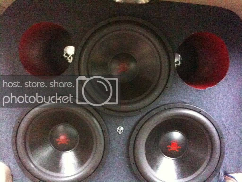

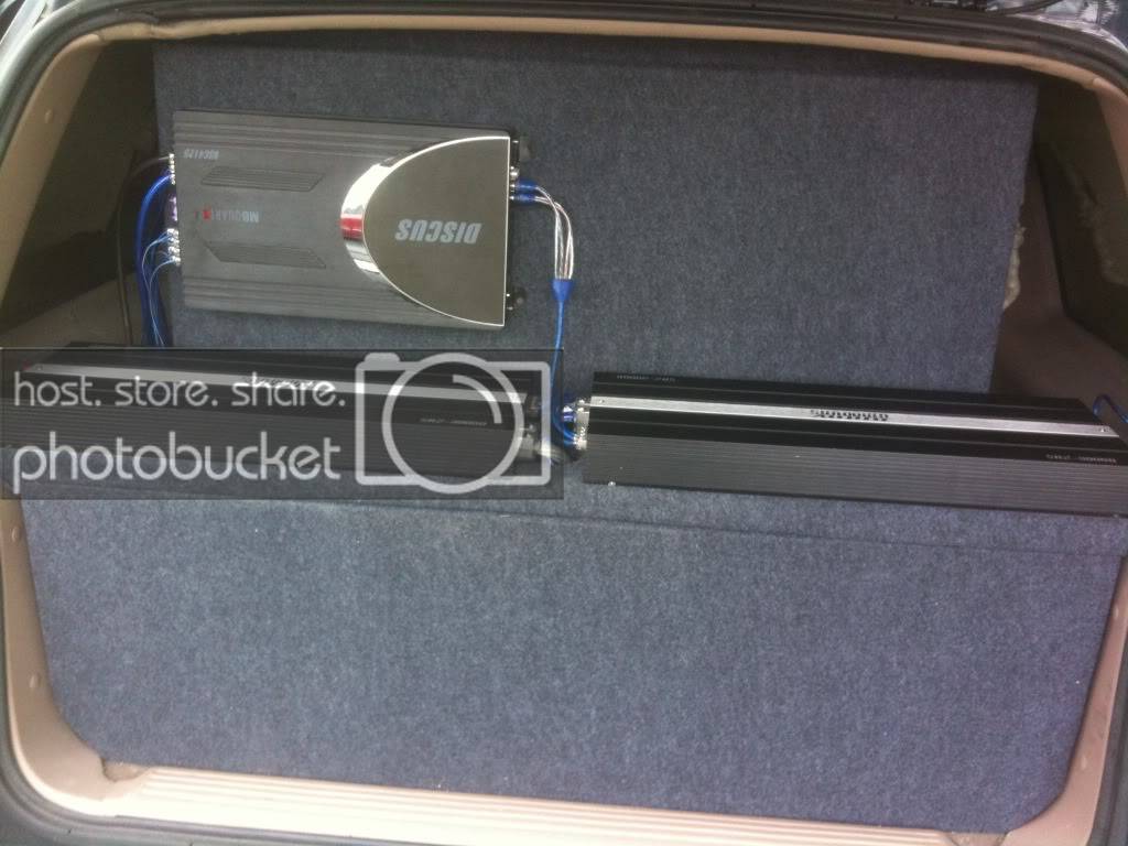

Well I sold all 4 of my 18" Fi BL's and went with something else. It was WELL WORTH IT! These subs are amazing. Box is about 14 cubes after displacement tuned to 36 hertz with two 10" ports. Hooked up to two Sundown Saz-3000D's strapped at 1.5 (.75 each). Electrical consist of DC power 250 amp alternator. Kinetik 1800 up front and three deka group 31's in the back with two runs of 0 gauge and of course the big 3.

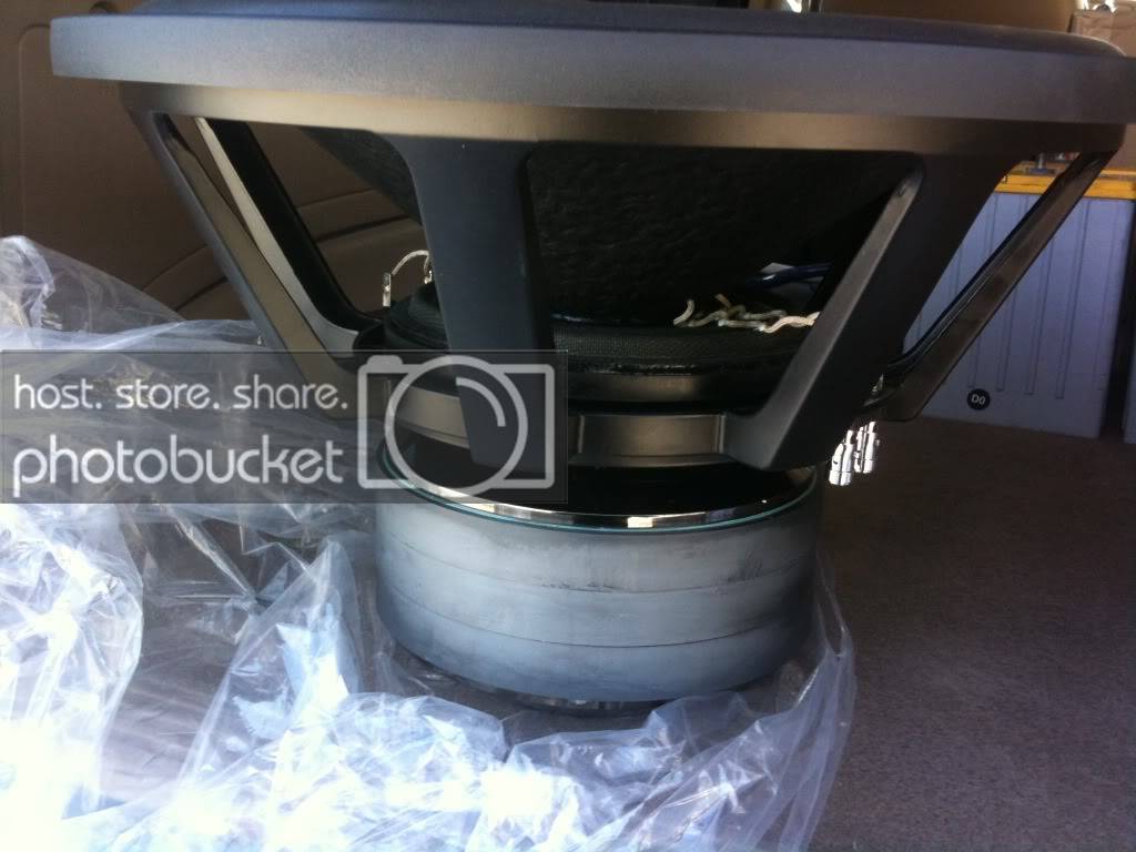

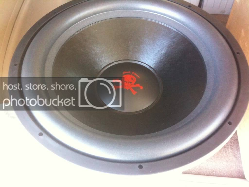

A great day when these subs came!

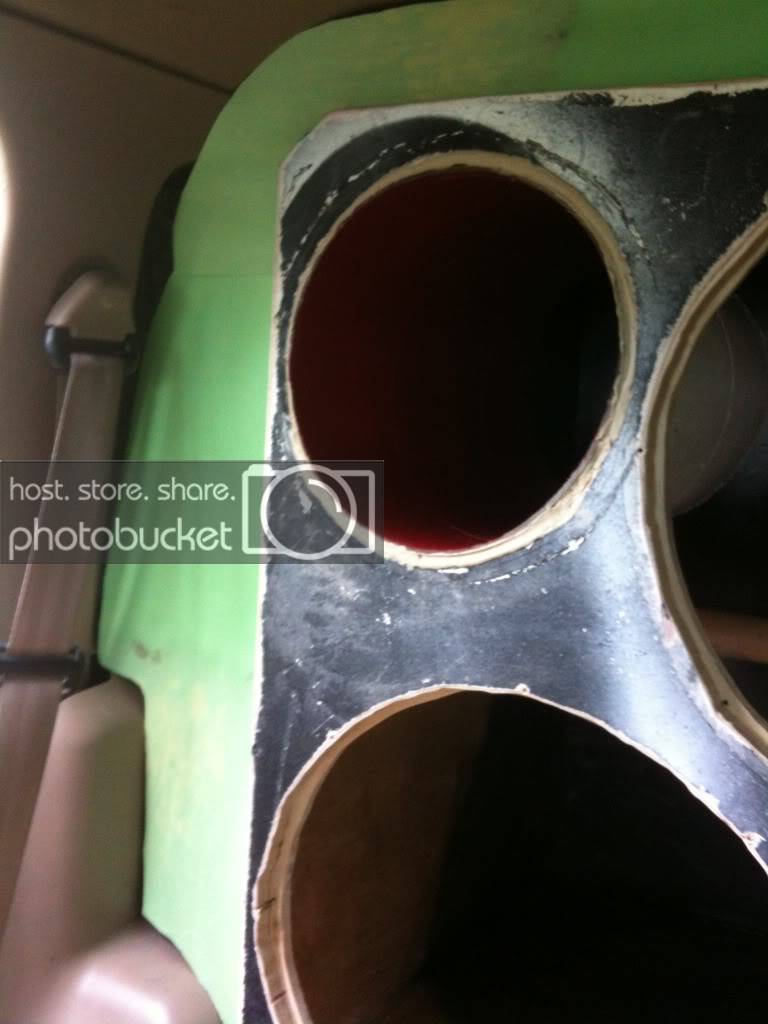

The box was an old one I had laying around which I used previously, but it got some major work done to it to make it work
Trim panels, man that job takes a while and gets frustrating trying to get it as best as possible.

how much of a difference than the 4 bl 18's? I looked at the death penalties but ended up building 4th order bandpass and just keepin the 2 bl 18's

O nice, but yea honestly a HUGE improvement. With my 3 18" BL's I hit a 152 on an epic 160 then hit a 151.1 on the termlab with that setup. Went to the 4 18's and actually the epic 160 gave me a 151 (because the box was way to small and not good) Haven't got the new setup on a termlab as it has only been playing for 2 days but on the epic 160 I hit a 154 with brand new not broken in subs and it is just so much louder to the ear and moves ALOT more air so yea I am extremely pleased //content.invisioncic.com/y282845/emoticons/smile.gif.1ebc41e1811405b213edfc4622c41e27.gif
