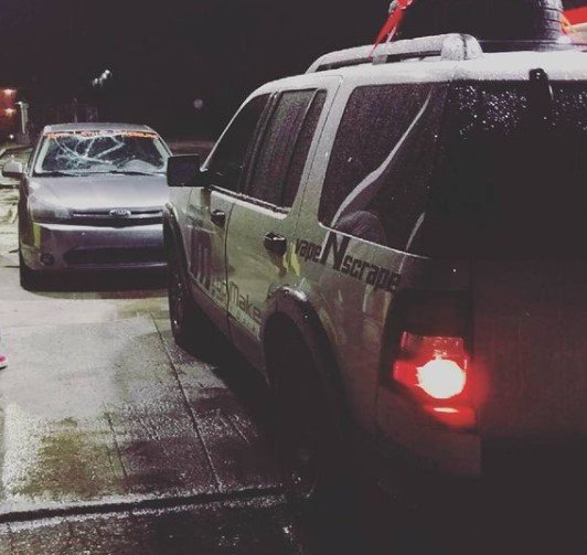

My team mate ran Taramps HV amps years ago. I was nervous wiring up the batteries but it wasn't too bad. Just have to hook up the HV charger every few days depending on how large your battery bank is.
I'll have to hook up my hard drive and get some old pictures uploaded.
