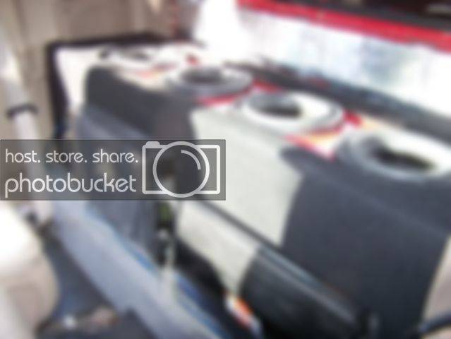

going to build a beauty panel to go over the amps out of .5" mdf with nice cutouts.
anyone seen one of these in a while? didnt think so, lol but it works great!
only way to get 4awg wire to work..... take a ring terminal and use a dremel to make a stick like figure lol. little bit of hammering and it works!

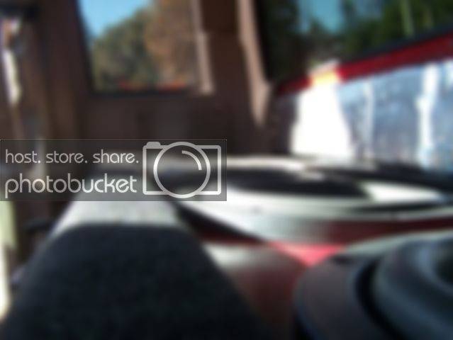

what you c with the seats up lol useless pic haha
about the amps...... they will be replaced by a sundown 3500d and a 125.4 //content.invisioncic.com/y282845/emoticons/biggrin.gif.d71a5d36fcbab170f2364c9f2e3946cb.gif eventually haha after Christmas time lol. and the amps put out the power i need //content.invisioncic.com/y282845/emoticons/biggrin.gif.d71a5d36fcbab170f2364c9f2e3946cb.gif
