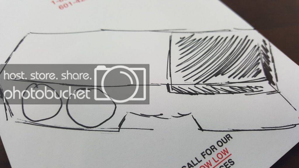

If you wind up with port noise or it just doesnt sound right consider something like this. Run the 2 subs with whatever slot port you can fit that runs along the top of the box and over the driveline hump. You can even find some thinner ply for the port walls to make it clear the hump.

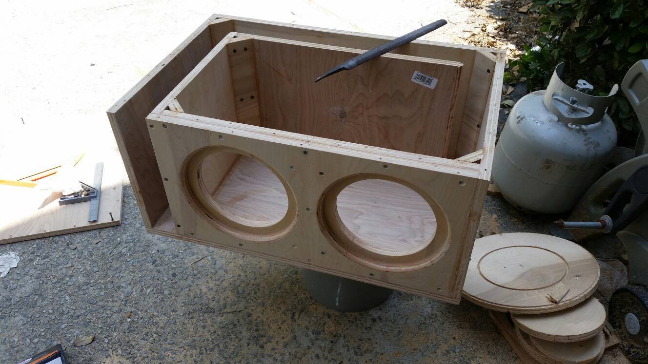

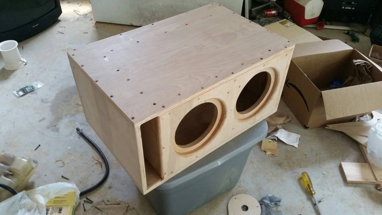

i ran my design through winisd, im trying to make the box i have work. I was thinking of splitting the box into two chambers and porting both sides. Winisd says i can use 2 ports that are 2 inches by 14.5 inches which would leave me with a tuning of 36hz and each woofer would be left with .425 ft^3 after displacement. i tried inputting a bigger port but it makes them too long and the vent mach goes up, with the 2 inch ports my vent mach is at 0.11, any ideas??

Also i could leave the box as one hole chamber, winisd states i should be able to use 3 2 inch ports that are 9.5 inches long. If i do that the subwoofers would see .45 each after displacements. The only thing im worried about if i do that the ports would be behind one pair of subwoofers, would i run into problems since the other pair of subwoofers are farther from ports? also this set up leaves my vent mach at 0.10
I would think 2" ports would be too small. Try aeroport or just a reg port as part of the enclosure.
i tried to use a single 4 inch port but i got too much port noise, i reran my box through winisd and it says i can use 2 3 inch ports, would that work?
