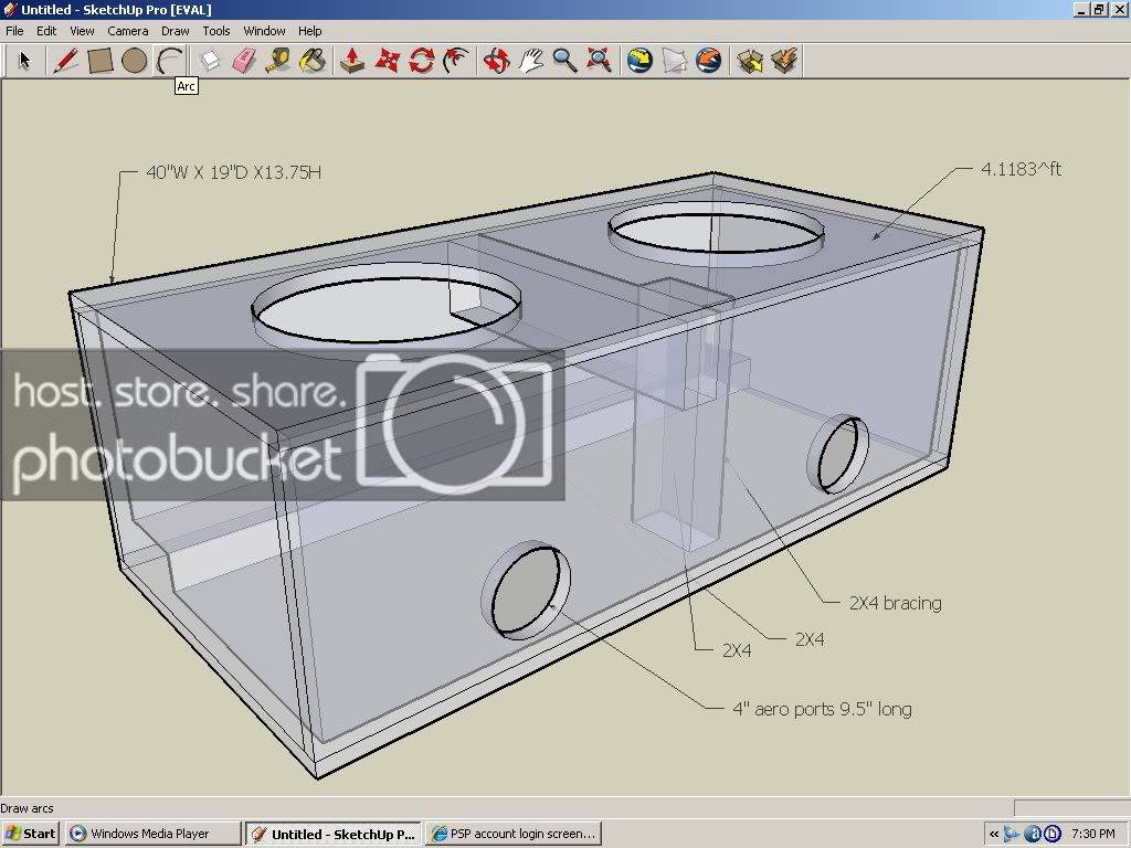

Im still working on my desinging skills but i would like some input from the regular box builders as to what they think of this design. As long as i got all my math right this box is roughlly 4.1^ft after all displacement. Any advice or suggestions would be appericated. Thank
Box External dimensions
40X19X13.75
Internal
38.5X17.5X12.25
Bracing with 2X4's
brace 1: 2X4X38.5 side to side along back wall
brace 2: 2X4X12.25 from top to bottom against front wall
brace 3: 2X4X17.5 fornt to back against top of box
2 4" aero ports 9.5" deep 3" from floor of box
Tuned to 38 hz
Subs will be 2 audioque 12" SDC 2.5 powered by a sundown SAE1000D.
Yea x2 on adding more port area...try (4) 4" aeros or a pair of 6" aeros.
