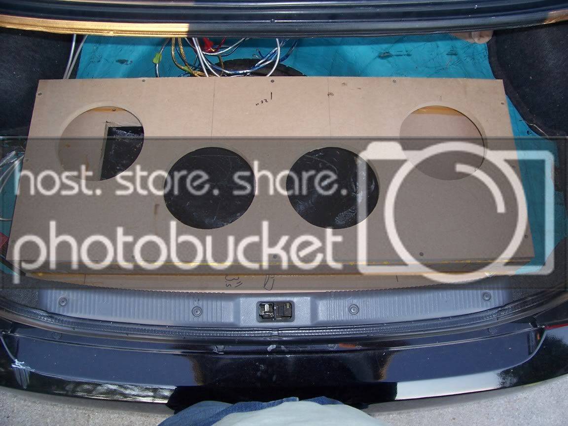

i scored 4 eD 9kv.2's from ndnbolla since i wanted to try something different.

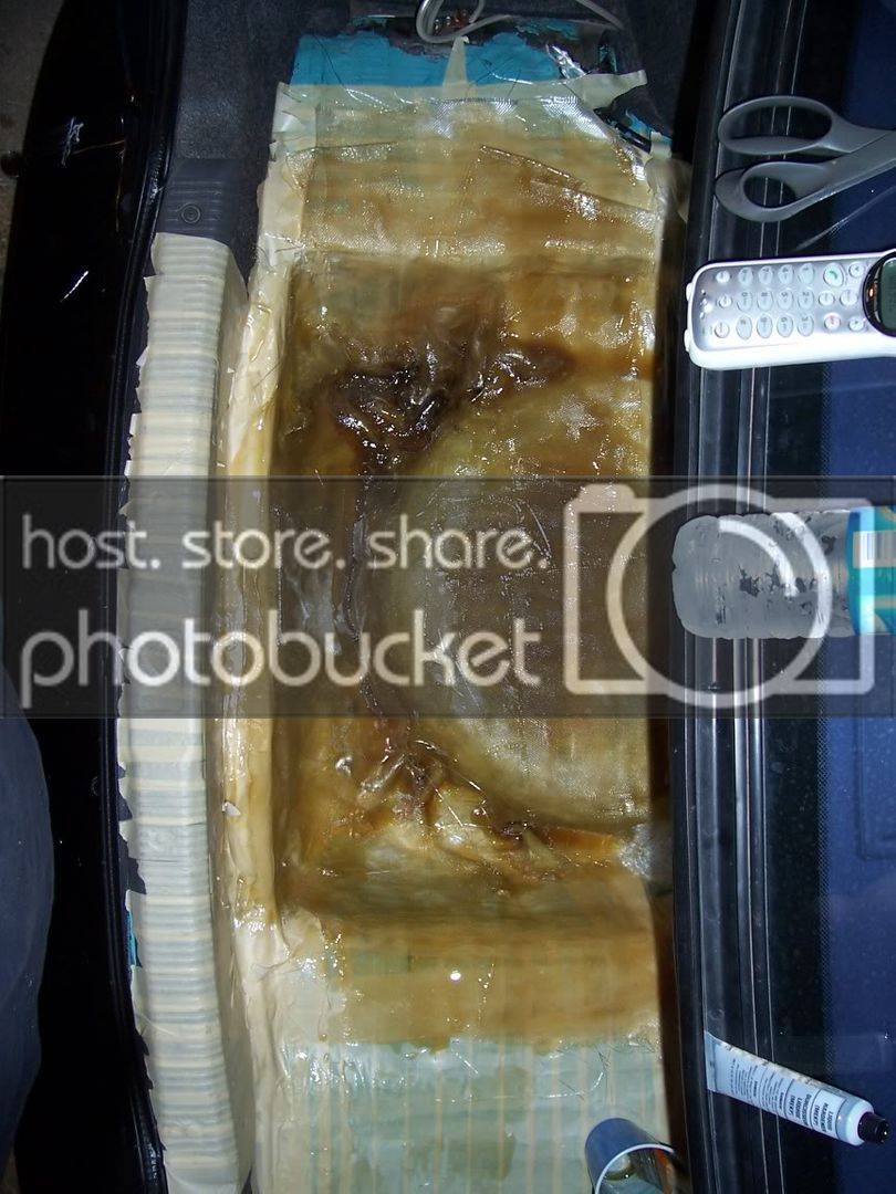

they are going in a 1.8ish cubic foot sealed box that is glassed down into the spare tire well to get extra space without having a tall box.
this is my first attempt doing anything like this and i think it went pretty well.
if i could do it over again there is things i would do differently but that is the way these things go.
onto the pics.

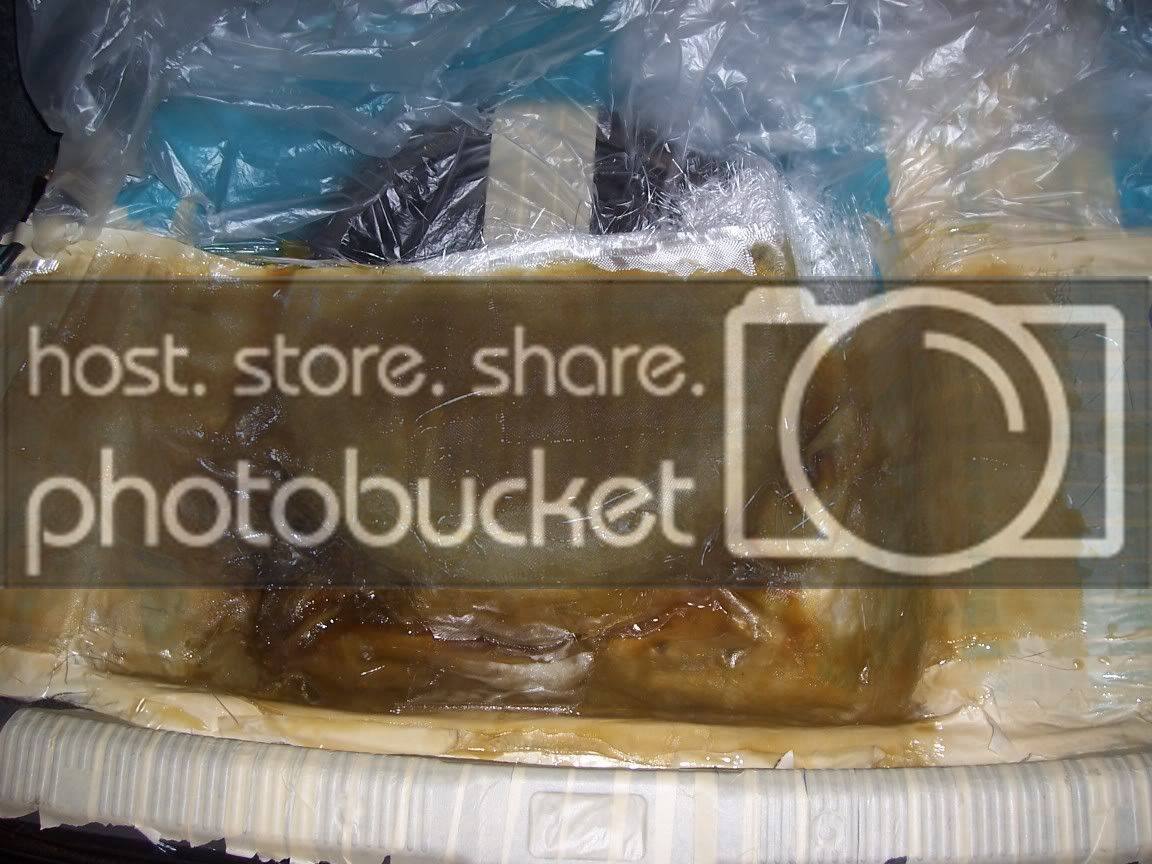

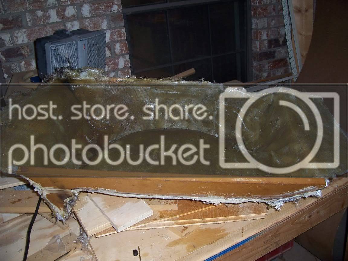

the first layer is in place

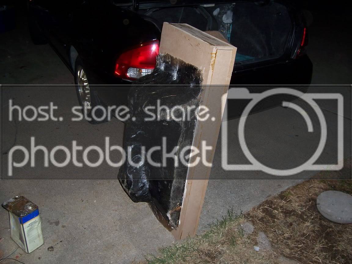

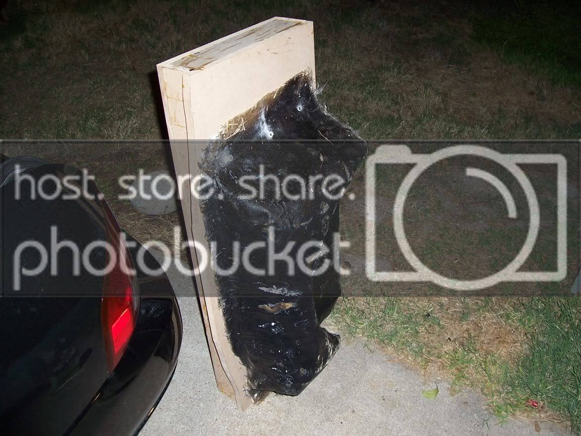

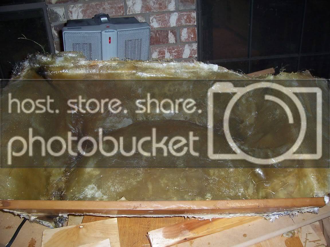

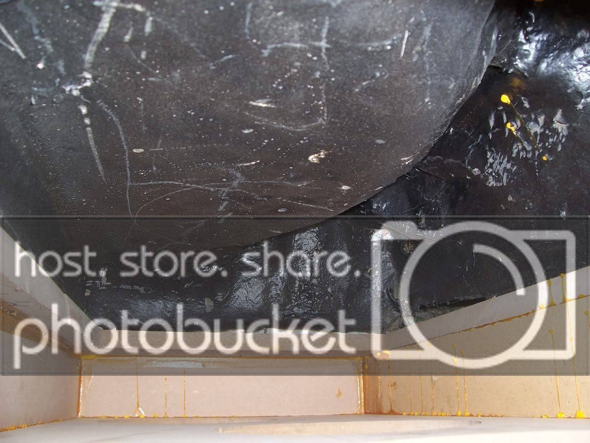

removed from the car and the back side is closed in.

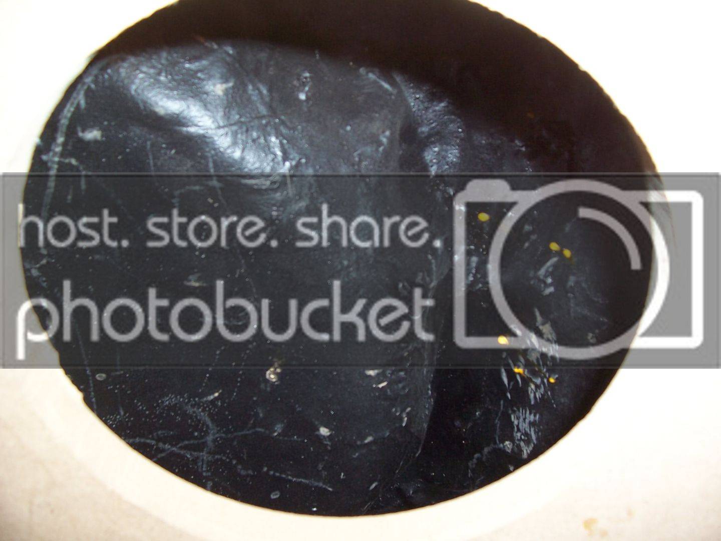

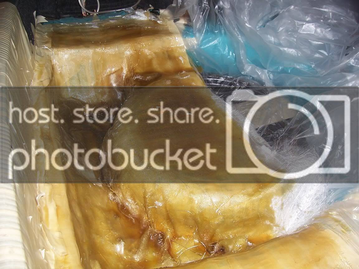

inside view of the mostly finished box

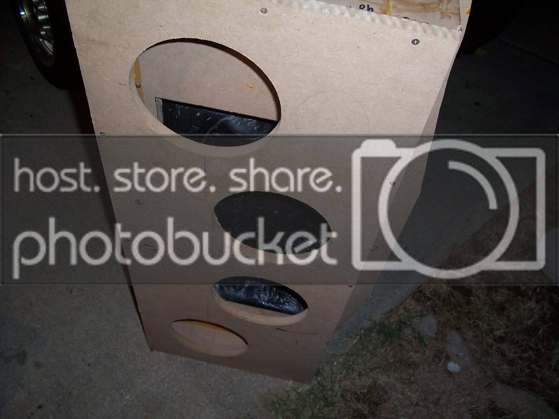

top of the box

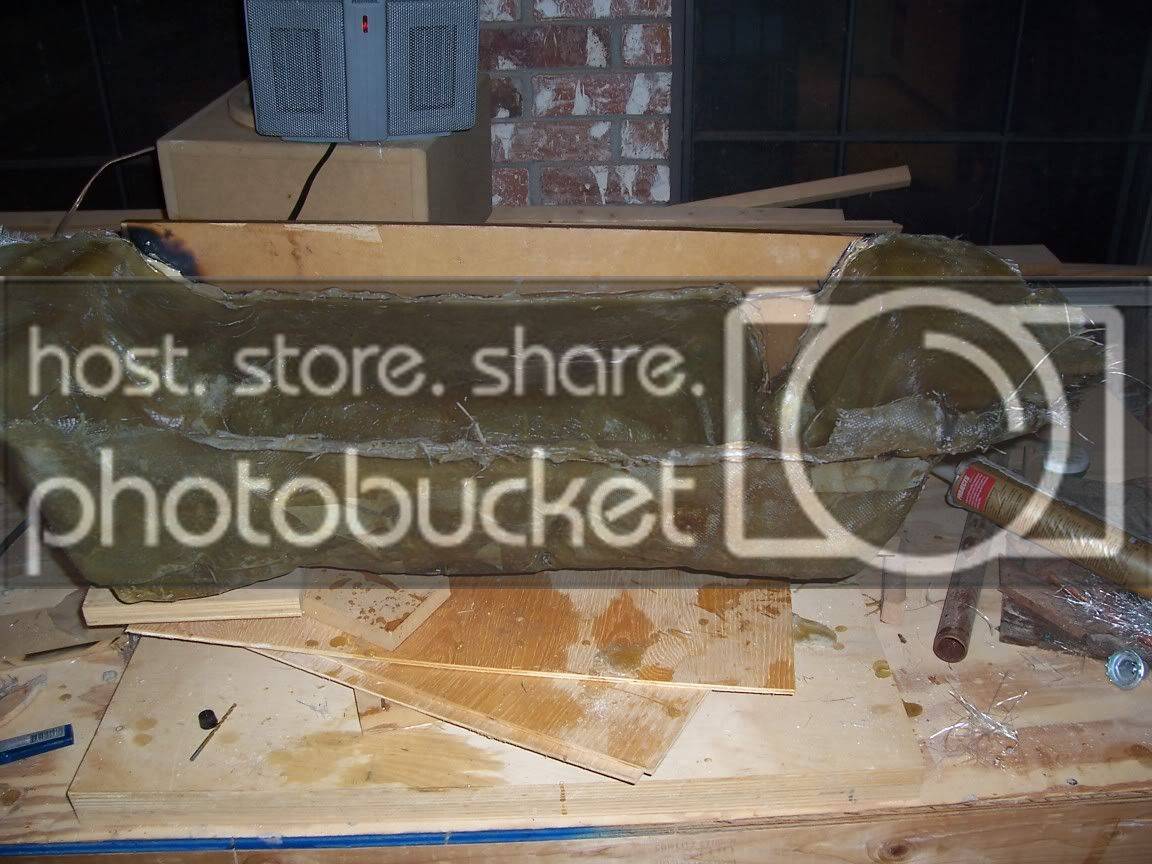

the "tub" attached to the top mdf box

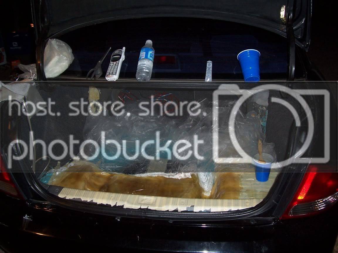

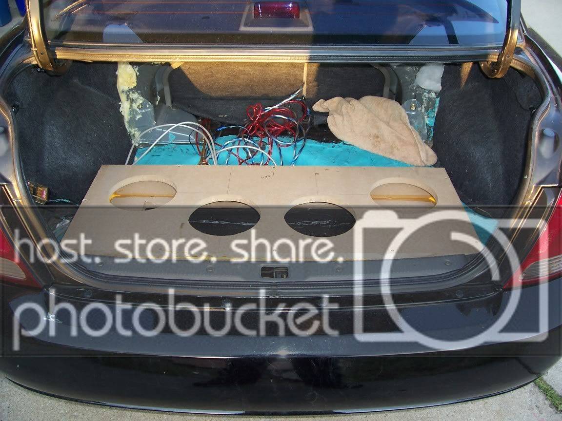

in the trunk, the box only sticks up about 3.5" from where the stock floor was.
the two center subs will be mounted regularly but the outer two will be inverted due to the box being shallow on the ends.
now i just need to figure out where i am going to put my amps/crossover/eq.
the subs should be here tomorrow so hopefully i will get them in and the top/beauty panel built to make them look a little better.
i know it isnt pretty but it should get the job done.
and the parts that will be visible will not be so ugly.
any comments would be appreciated.

wow dude its ok you can wipe away the bleed out glue LOL. Got glue booger all over the inside of the box. LMAO I would extend the box top into the sides of the wheel well for your amp racks and crossovers etc.
it adds debeeez //content.invisioncic.com/y282845/emoticons/rolleyes.gif.c1fef805e9d1464d377451cd5bc18bfb.gif
i was messing with the clamps to hold it together while it was glued and didnt care about the drips.
they will be sanded off anyways.
