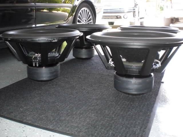

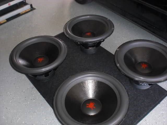

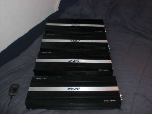

4 DP21"s

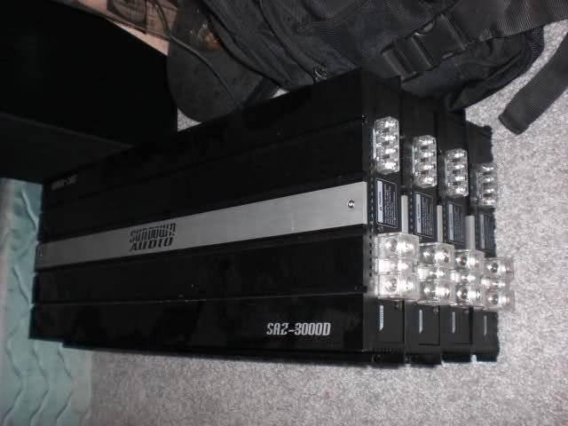

4 SAZ-3000d's (new heat sinks)

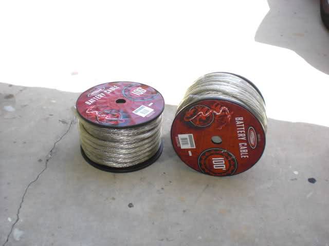

200+ ft. Tsunami Competition 1/0 (5+ 5- runs back)

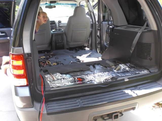

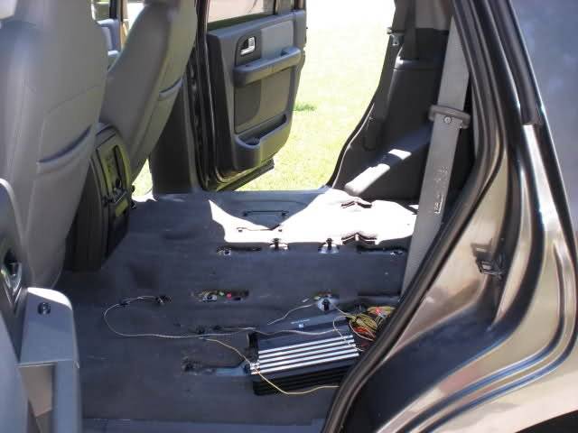

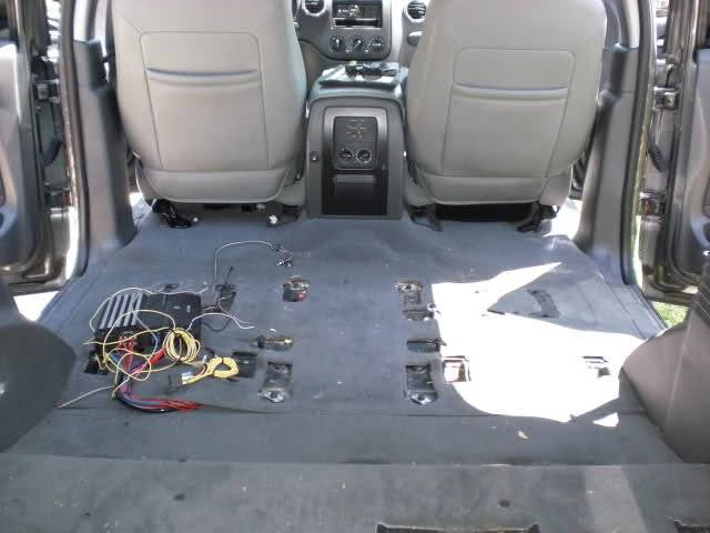

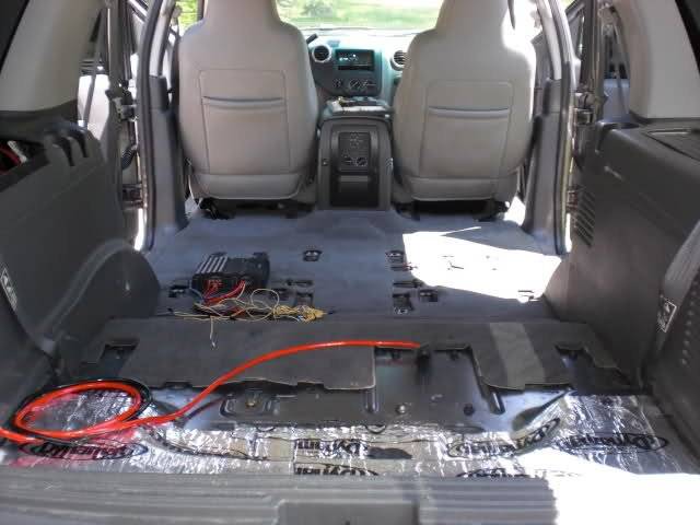

Gutting process. And my dad getting the golf cart ready for a sub lol.
I'll be so happy to get that rats nest cleaned up.

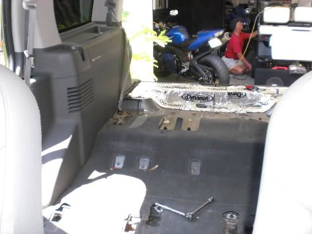

Bolting down to where the seats were bolted down to.

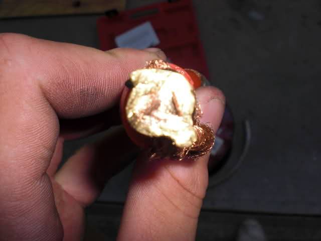

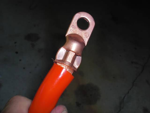

Crimping my old 1/0 for redoing my big 3.

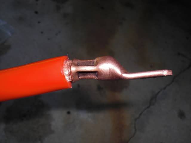

I love my new crimpers so much that I decided to hack saw a terminal in half to see how it looks (this one was actually not a very good one compared to my new ring terminals and after having some experience). Ended up hitting my thumb and slicing half way up my thumb nail lol...And sorry, the pic's crappy. But it looks like a solid chunk of copper that's fused together. Hydrolic crimpers ftw.

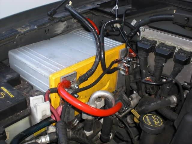

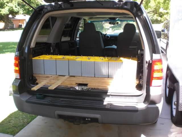

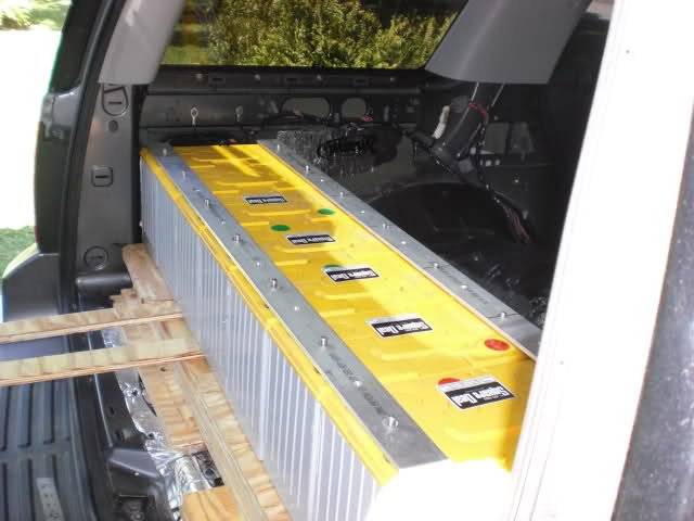

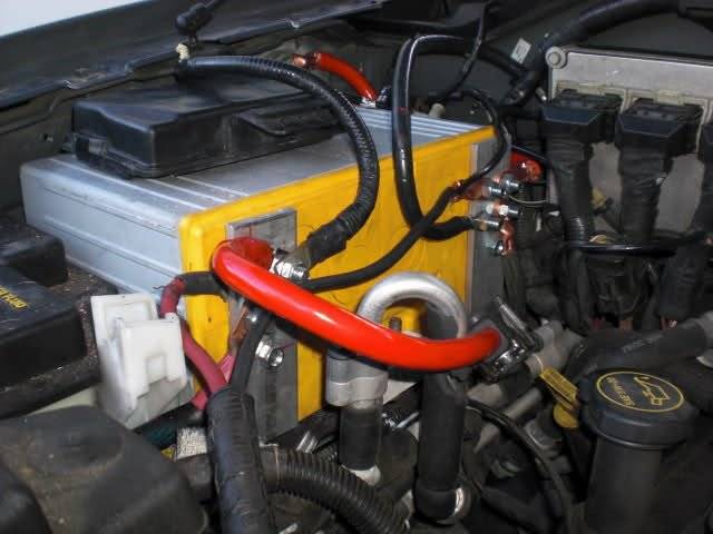

Deka up front.

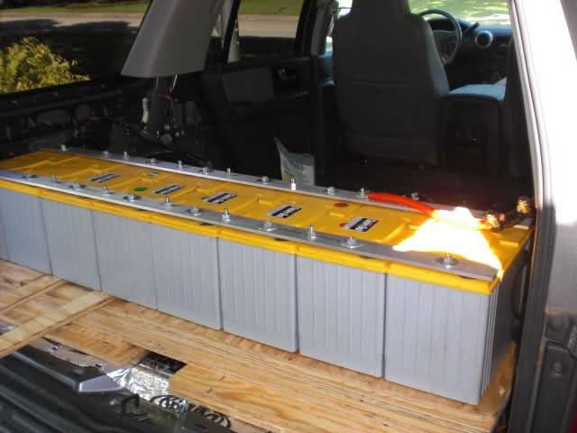

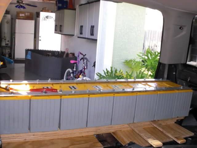

Test fit for the buss bars on the back battery bank. I kinda just wanted to see how they looked back there too. They will be in a box with a cover when finished.
Thanks to wgsj_fortvalley/PeachtreeCustomz for the front and back buss bars.
upgrading suspension?
Waiting to see. With all the batteries back there it's taking it like a champ. There has been maybe a 1/4" sag, and I'm not even exaggerating lol. I think the rear is beefed up a lil for towing heavy trailers. I was gonna use it to tow my race trailer.
Wire
First two runs back, 8 more to go.

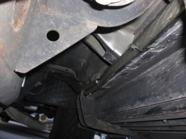

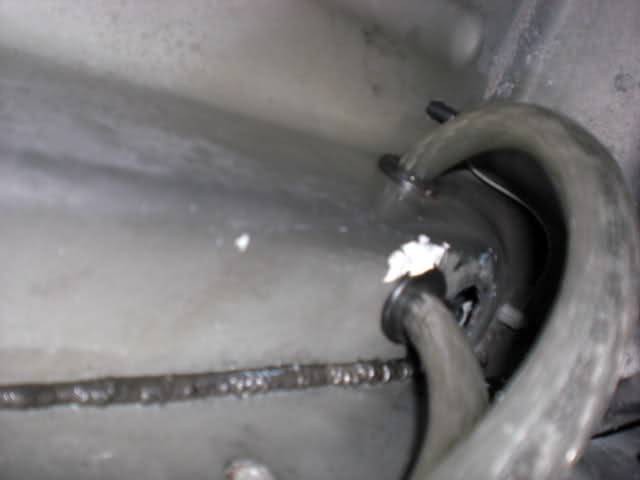

I've had my old power wire ran under like that for over a year now with no problems. No drilling through the firewall and stuffing it under carpet ftw.
