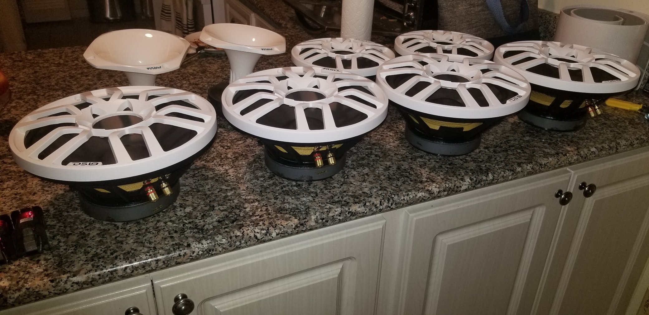

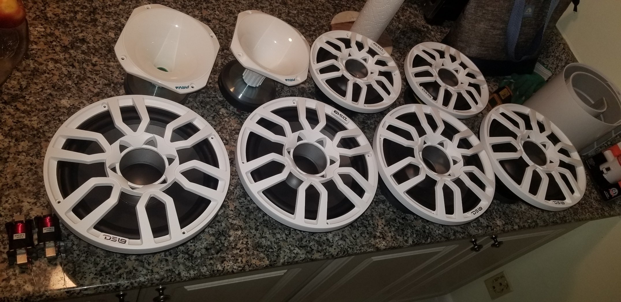

I'll let you guys know how it works out. If the horns are a dud, a 6.5" coax fits in the hole. I went with the goldwood delmar woofers and prv D290Py-S compression drivers with some 6" horns.

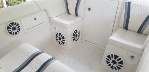

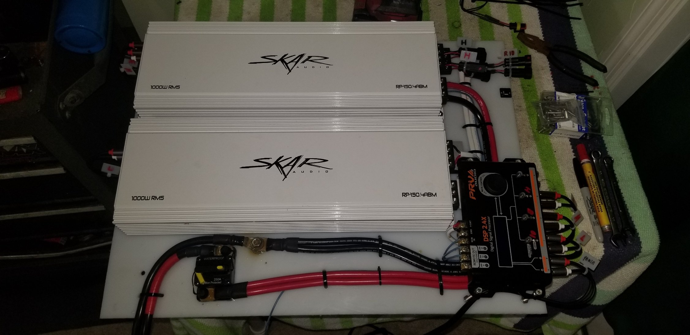

I'm doing 4 - 10" up front with the 2 horns, 2 - 8" closer to the middle of the boat, and the boat already has 2 6.5" coax speakers behind the console and 2 more at the transom running on head unit power ill just cut the tweeter wires and use them for rear fill. One amp is bridged running the 4 10s at 250w a piece, the other is running the 8s and the horns.
I'm late to the game, but those don't look like good waveguides for you application - narrow dispersion. If you aim them on-axis, they'll make your ears bleed; aim them off axis and you'll miss your mids and highs. I think a car audio horn would have been idea, but expensive and difficult to source. If those horns don't work, I'd look into something with a wider dispersion like these. Good luck with the project.
I went with those simply because they fit, the cutout is round, and the hole will take a 6.5 coax. Cutting a square hole in a boat for a speaker borders on insanity as far as resale value ect. They sound great, I will probably add a super tweeter they are a little soft up top but other then that exactly as expected crystal clear and retarded loud. Not as harsh as a titanium driver and not as smooth as a dome tweeter. Overall good sound, and unbelievably loud. I pulled wires while I was at it to throw a sub in the cabin, a project for another day.
