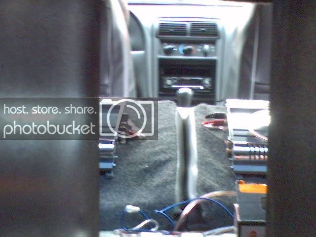

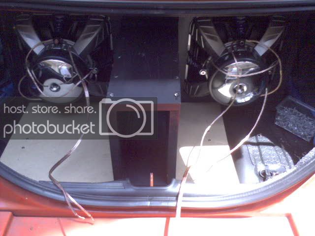

I sealed off my trunk of mine
These are during install pics
Heres through the port
And Im running them on 2 of these
Wow, that's pretty cool. How well does it seal around the trunk lid? Mine has a small gap around the weatherstrip and doesn't seal all that great. Also, are those 12's? My next step may be removal of the back seat and build a fiberglass enclosure for a couple of 15's. If it's not loud enough, put in bigger speakers right?
