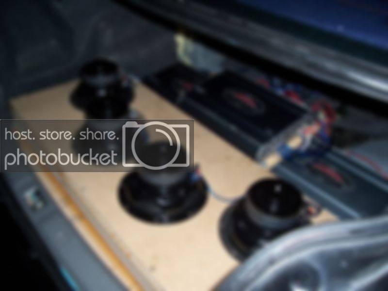

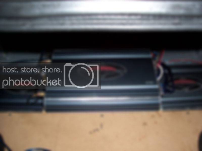

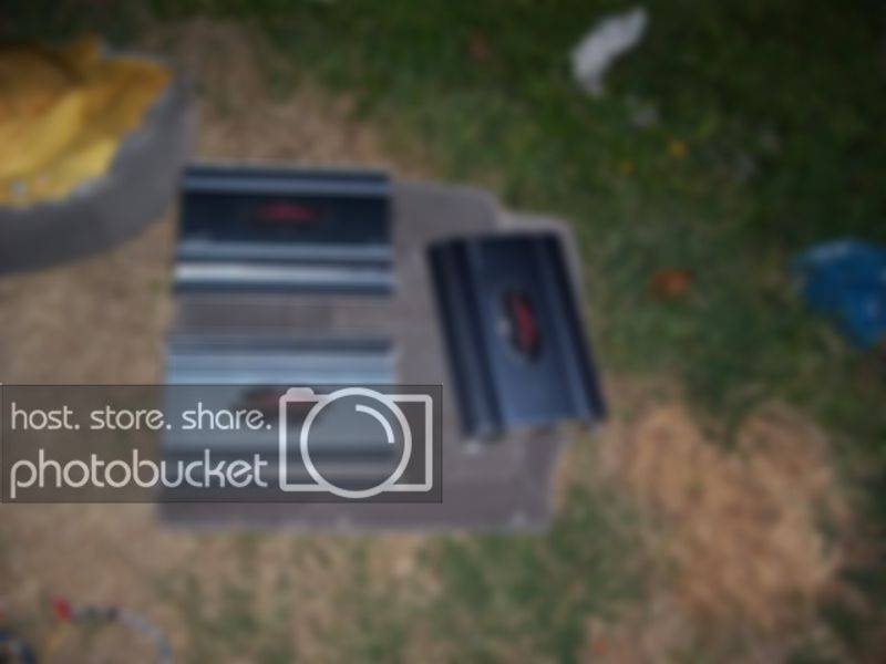

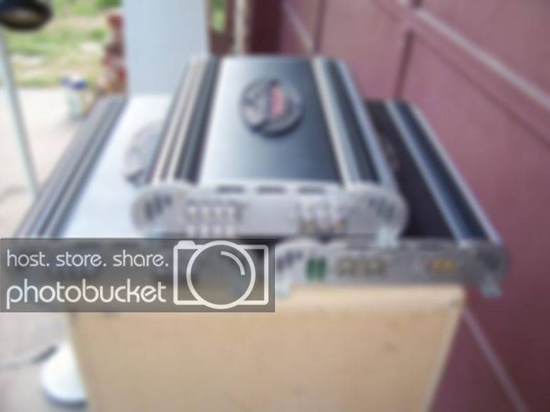

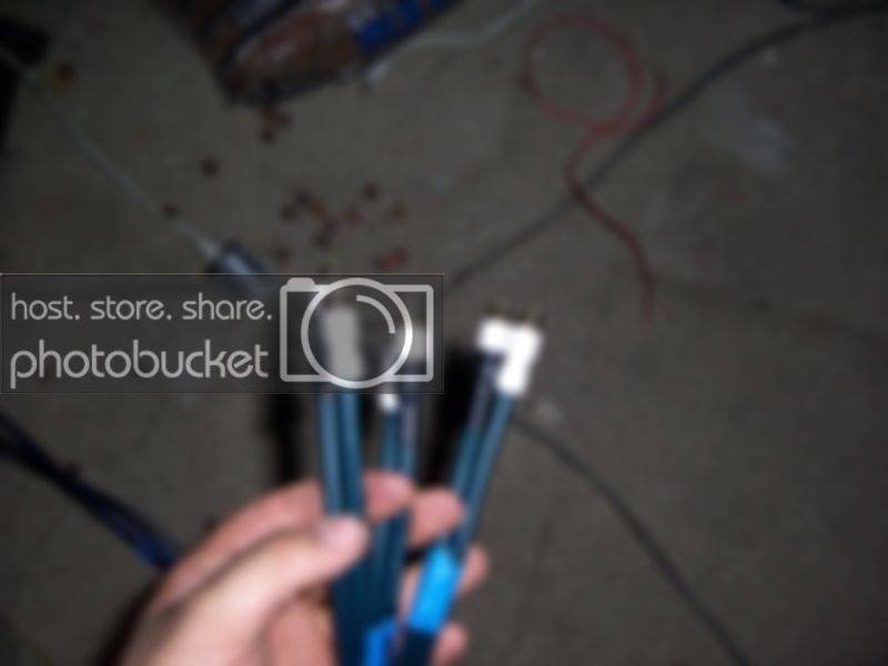

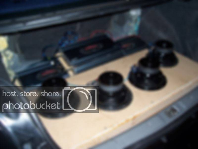

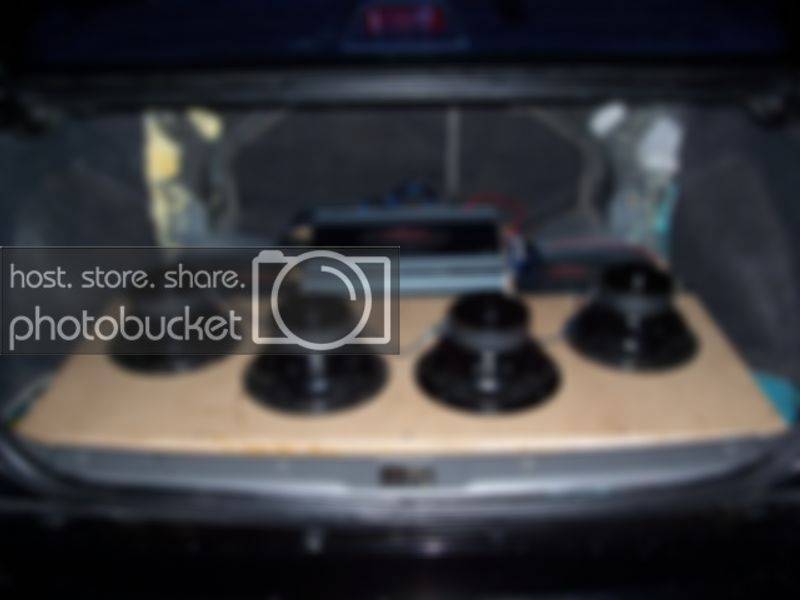

i got all 3 amps installed temporarily, ran new rca cables, all new speaker wire, and added in a mid-range to give me a 3-way front stage.

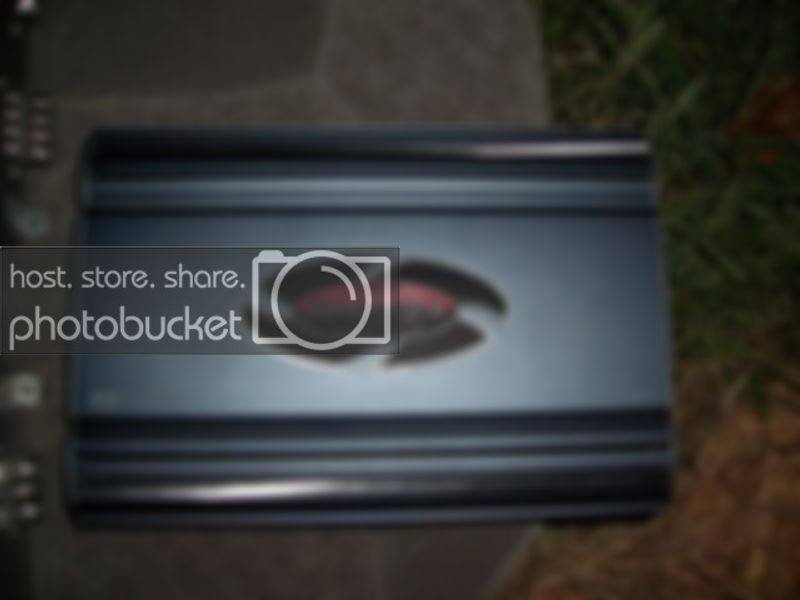

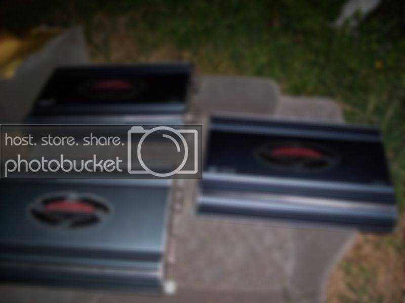

yummy avionixx amp sexiness
i came outside and a freaking bird was on my amp, WTF???

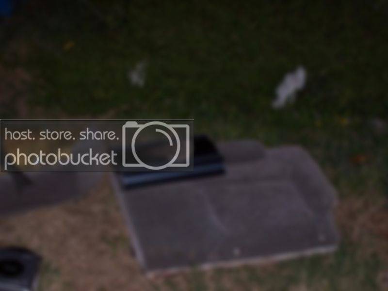

family photo

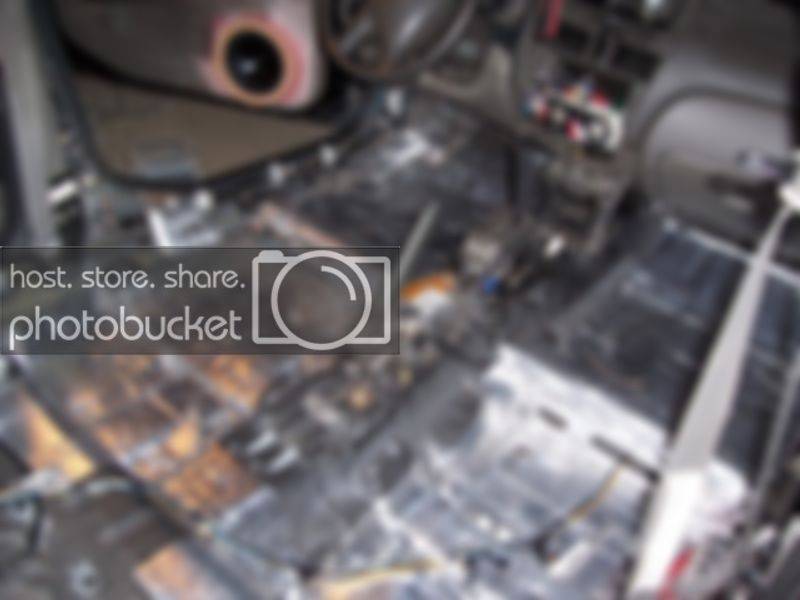

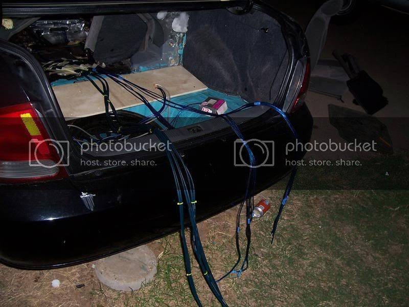

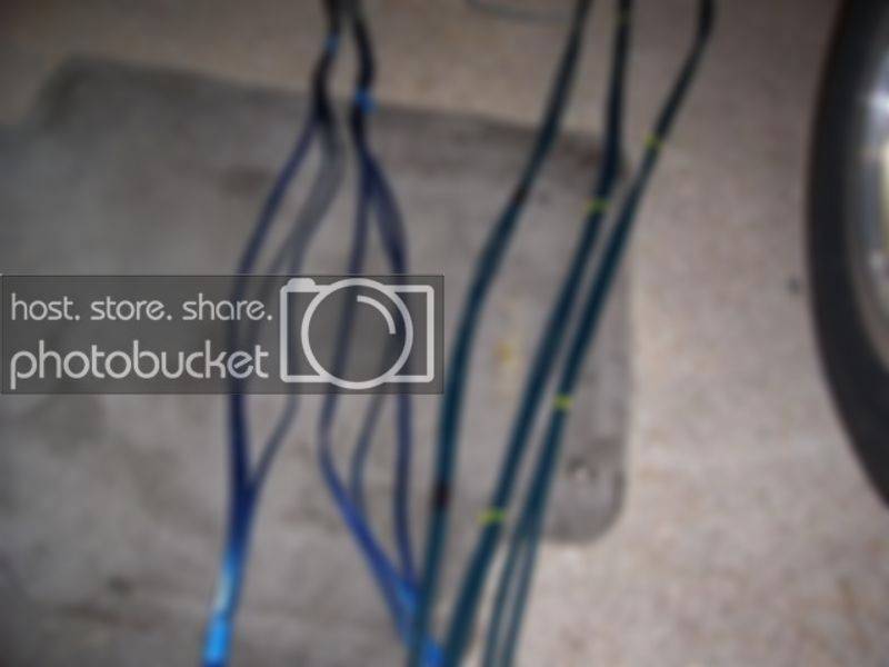

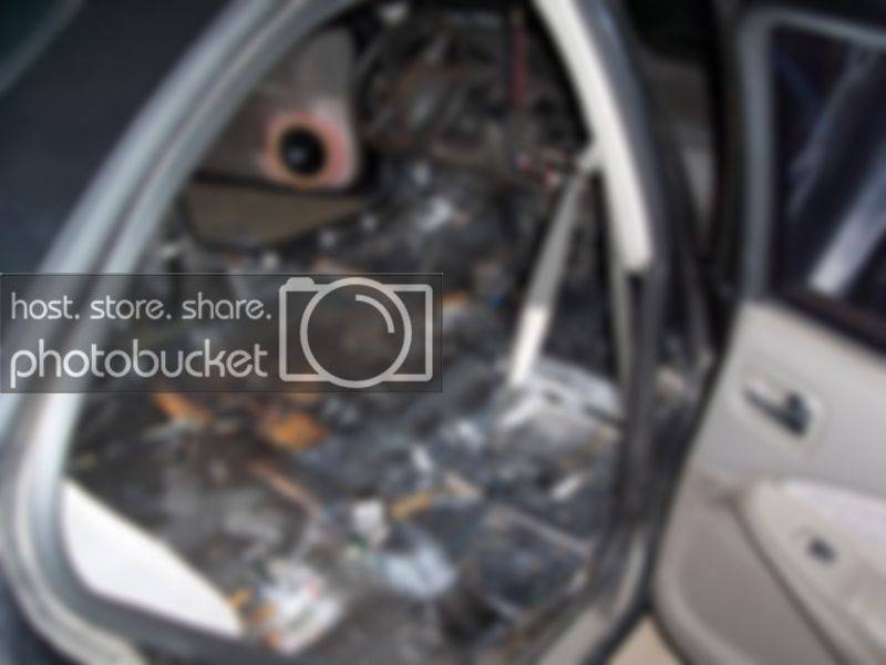

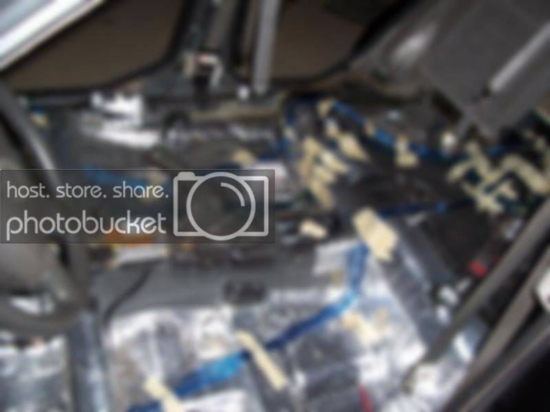

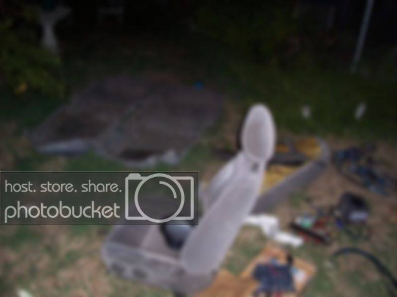

interior stripped and ready to run new wire.

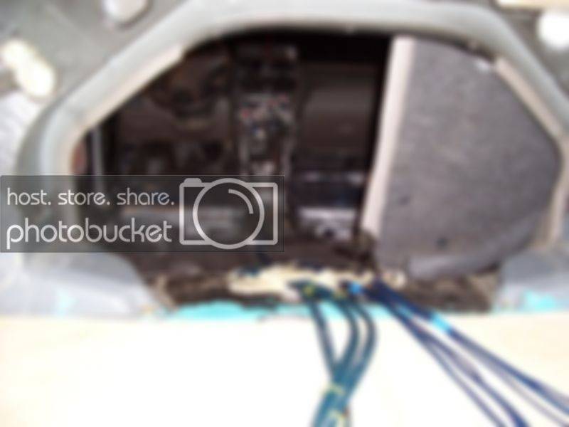

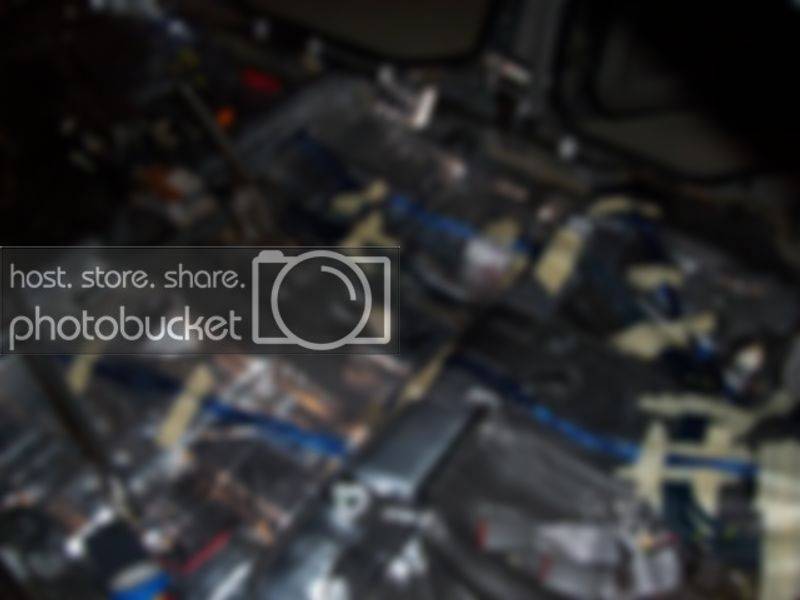

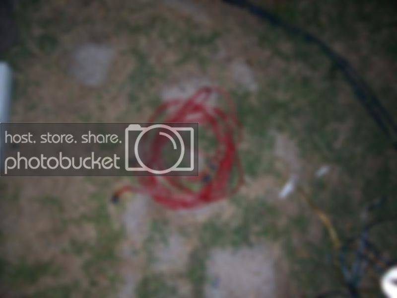

RCA and speaker cable ran.
trunk shot.

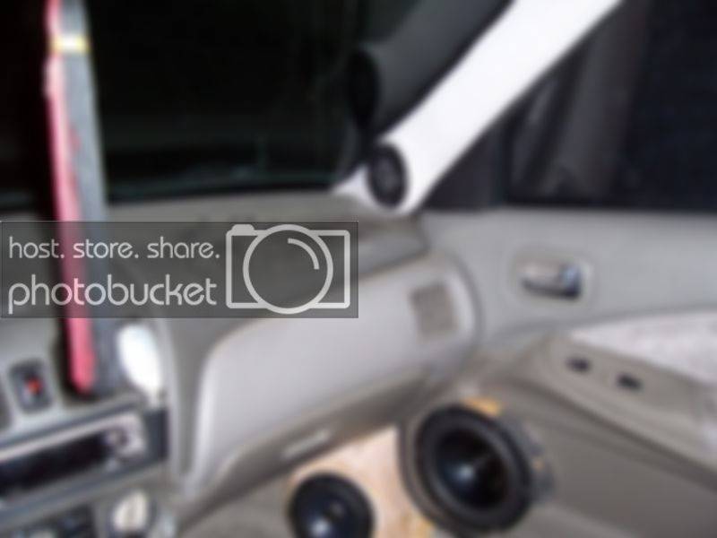

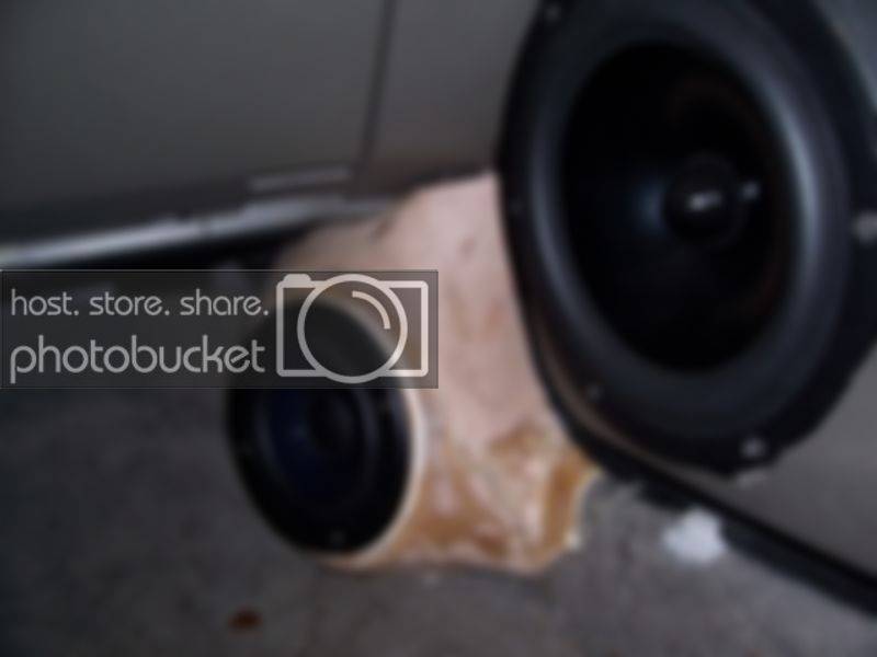

now for speaker pictures.

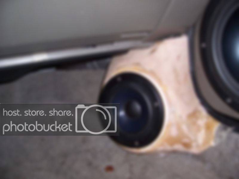

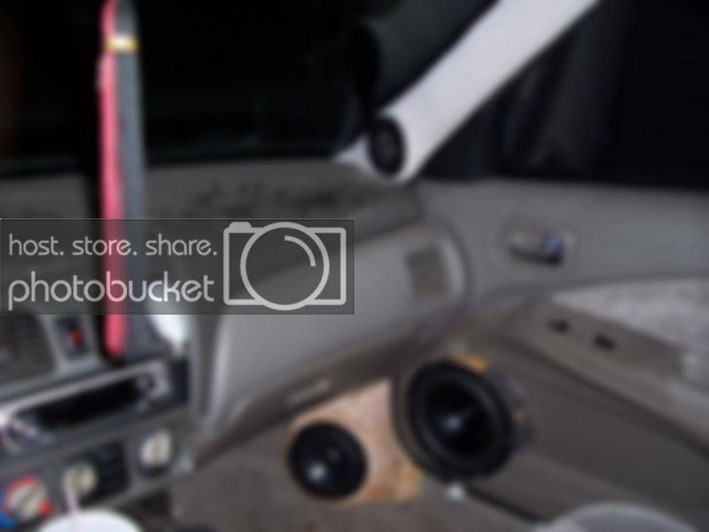

coustic mids installed temporarily in these kicks, they will be rebuilt smaller so they don't take up so much floor space.
i still have alot more work to make everything look like i want it to but it is shaping up nicely.

it will, keep up the good work,. just make sure them speakers are crossed over and set up right.....
for the moment the tweeters are playing down to 3.15k
the coustic's are playing from 3.15 to 250.
the 8" daytons are playing from 250 to 50.
and the subs are 50 down.

Do those amps look alot like eD's or is it just me?
strangely similar, and no it is not just you
but two of these are class T anps and ed never used those.
