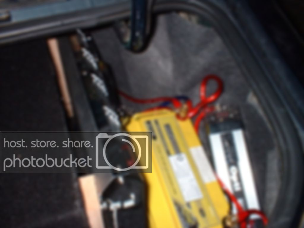

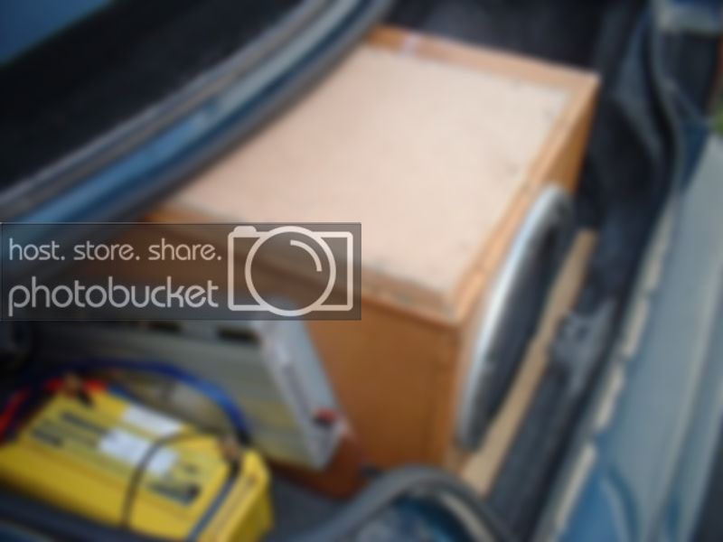

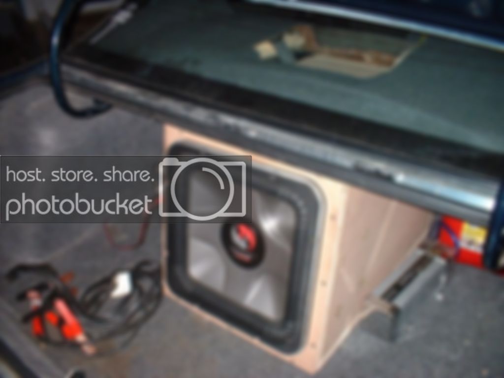

OK, we JUST got the car a few weeks ago and started installing the system. it's not done yet by a long shot. I do not have the big 3 done yet. I do not have a HO alt. however, I used to run 1 red top under the hood and 1 stinger spv70 in the back without big 3 or HO alt in an Olds Cutlass and Dodge Intrepid with ZERO problems. the systems in those were WAY louder and hit much much harder than this one, plus I had a kicker 350.4 and 200.2 in those as well. when I ran the lanzar in it, it was at 1 ohm , now only 2 ohm, and before that an inefficient Audiobahn A1500HCT that popped 100amp fuses left and right till I just ran the power wire strait to the battery no fuse.
this one is totally not ready... single 2 ohm coil on a Lanzar OPTI2000D...and it clips very easily. I can hear clipping and I back it off. Sometimes the sub starts to stink a little. The amp is rated 1100 RMS @ 2ohms, but I am going to guess I'm doing no more than 900. We first put 1 redtop under the hood and hooked up 1 of the 5 in back. With 2 hooked up, no big 3 or HO alt, I STILL should not get any headlight dimming even "full tilt" at 2 ohm, but I cant do that or I clip and cook. But we keep it real, real low because of that..and it still dims! Hooked up a second in back and took the extra 3 batteries completely out for now. Same problem... solid grounds for both of them.
What gives? 10 amp draw per battery, so 20 extra amps now from the 2 in back . Just guessing no more than 50 amps for the amp (probobly much less) so yeah yeah, maybe up to 70 amps in addition to normal current draw, but still... i never had that with my intrepid or cutlass!

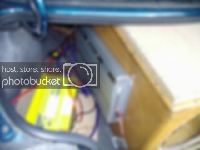

OLDs... 1 red top, 1 stinger spv 70, 1 Audiobahn A1500HCT 1 Kicker KX350.4... no big 3, no HO alt! (had that worthless cap in there for a while, oooh... 1 farad... I'd take 1 battery over 100 farads any day of the week)
http://www.cardomain.com/ride/553176
INTREP... lanzar opti 1ohm, kicker 350.4 and 200.2... red top and yellow top, no big 3, no HO, NO DIM!
even ran a XX-Colossus I bought Hexi... but it was damaged, clipped at low power, not near as loud as the other 2 amps... current draw minimal
used to use 8 guage power wire and distro blocks for speaker wire for very low resistance
