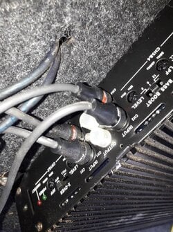

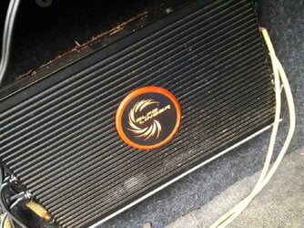

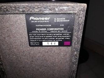

Hello all, so i have a Alfa Linear AL320.4 (4CH power amp) in my car and i have a S-BD808SW which has 3 ohms impedance. Amp outputs 4 ohms when wired in bridged. So is it possible to connect the sub to the amp? Im afraid of blowing the woofer up since it still works fine. Thanks.
you wont blow the woofer if there is an issue, if anything youll blow the amp. that amp is very low end anyways, and if it dies, itll probably do you a favor in making you get a better amp
There should not be any issues running a 3 ohm speaker to a 4 ohm, as the resistance changes with different frequencies so it should not be a hazard to the amplifier provided your amp can handle to a certain low impedance.   Speakers vary in different frequencies during music so it fluctuates when used so that should be ok mate!
key word there is should. If an amp is built to see a nominal impedance of 4 and you show it 3, the low end impedances itll see are way lower than what the amp is built to see and bye-bye amp. In his case, its probably for the best that it does as it isnt a known brand to the community and its not ideal for a sub amp anyways. Sorry to say man, your amp is probably gonna fry if you push it at all, and im not sorry to say that its probably for the best in your situation. Cheap mono amps can be had for 100 usd thatll kick the hell out of that thing for subs. Use that on mids and highs and be done with this question
