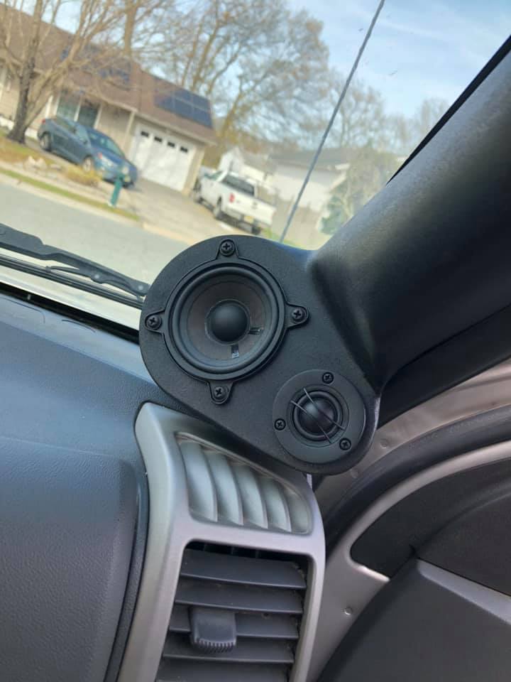

I have ordered some speaker pods that will hold 3"-4" mids and 1"+ tweeters. I have been looking for a good 3" - 3.5" mid for my 3-way active front. Is there ANY reason I should NOT get a pair of Audison AV-3.0 3" mids? $180 new. Would you suggest something different at that price or below that would be a better choice? I have 3 sets of tweeters, of which, the Dayton Ti domes are the closest in sensitivity @95db to the AV-3.0 @92db.

They are going to be on axis.
I ordered pods as I want them to be portable, as in transferable to my next vehicle (probably a Jeep GC 99-04)

I am interested. I have looked at those speakers as well, however I don't know the mounting depth of these pods yet. I am assuming near 70mm. I think the Infinitys are near 45mm deep from a top mount. PM me a price please.
