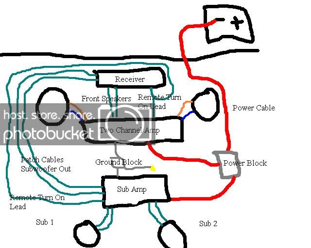

Thank you keep hope alive, but now ppl are making me worry so I'm just going to install two separate amps. If you look at the first link you gave me I wanted to do what's on pg 36 on the bottom right corner but ppl are saying its gonna take power away from my subs and I don't want that. Also pg 14 on the alpine link but like I said ppl are saying the amp won't have enough power. I know this is crappy drawing but do I have the right idea? Where would be a good place to put that two way amp? In the back with the bass amp?
Oh and those manuals helped SO much

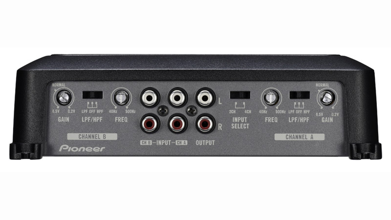

Again the only way im going to learn is if i ask more stupid questions. On this amp GM-D9500F - Class-FD 4-Channel Bridgeable Amplifier | Pioneer Electronics USAthere is 2 channels called channel A and 2 channels called channel B. Why cant I just use the two channels on channel A for the front speakers and 2 channels on channel B for the 2 subwoofers?
You can. You can also wire 2 of those subs to 4 ohm combination and bridge "channel B" to them. But that's only going to be 200 watts, which is WAY low for those subs. I don't know of a 3 or 4 channel amp that will do them justice... maybe someone else can suggest that.
