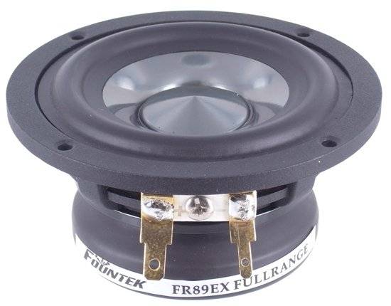

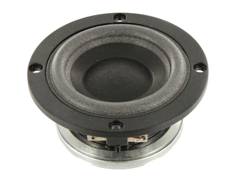

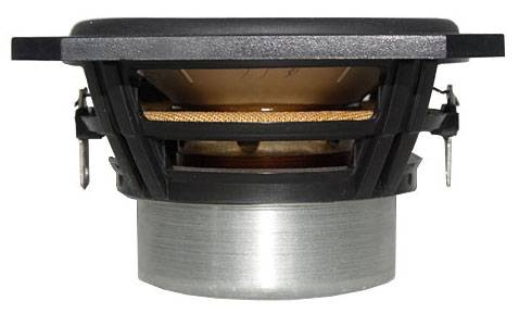

You've got a lot of flexibility with that arrangement, just depends on how you want to go. Not sure of your budget or crossover capabilities as far as headunit/DSP goes. For a traditional approach, you could do tweeters in that location and mids down in the doors. You could run a coax in that location with mids in the doors. You could also do a wideband like SB Acoustics, Fountek, Scanspeak, etc... in that location (like those pictured below) and run more of a dedicated midbass in the door. These setups can sound really good while keeping things simple.
