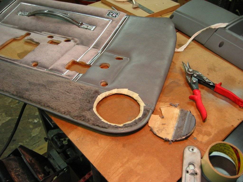

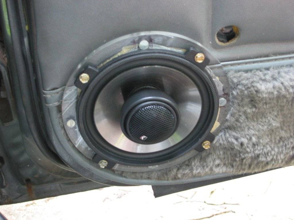

My 85 Olds Delta-88 has 3.5's in the dash and I've burned out every pair I've owned with just HU power. You MUST put bass blockers on them, at least 150 Hz preferably 300 Hz. The best I found was Boston Acoustics coaxials - FE3 or Se35, but you'll have to modify the Olds' grilles to fit them (the tweeters stick up above the woofer).
But the best thing I ever did with that car is mount 5.25's in the doors. You have to be creative:
