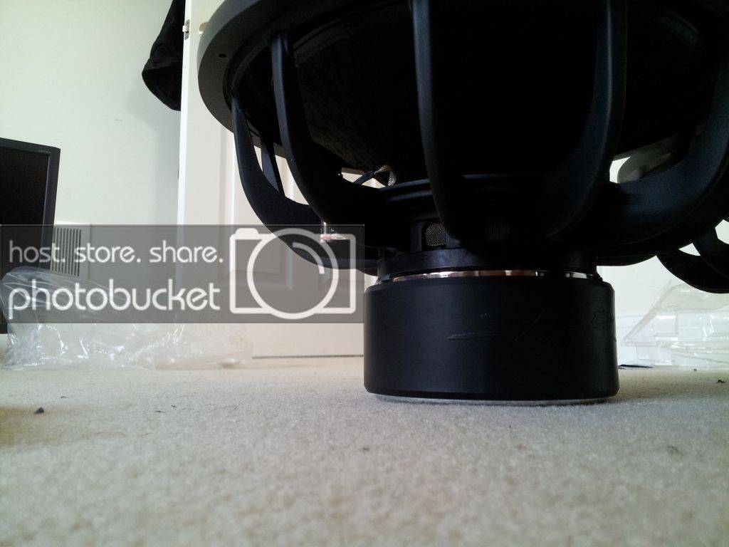

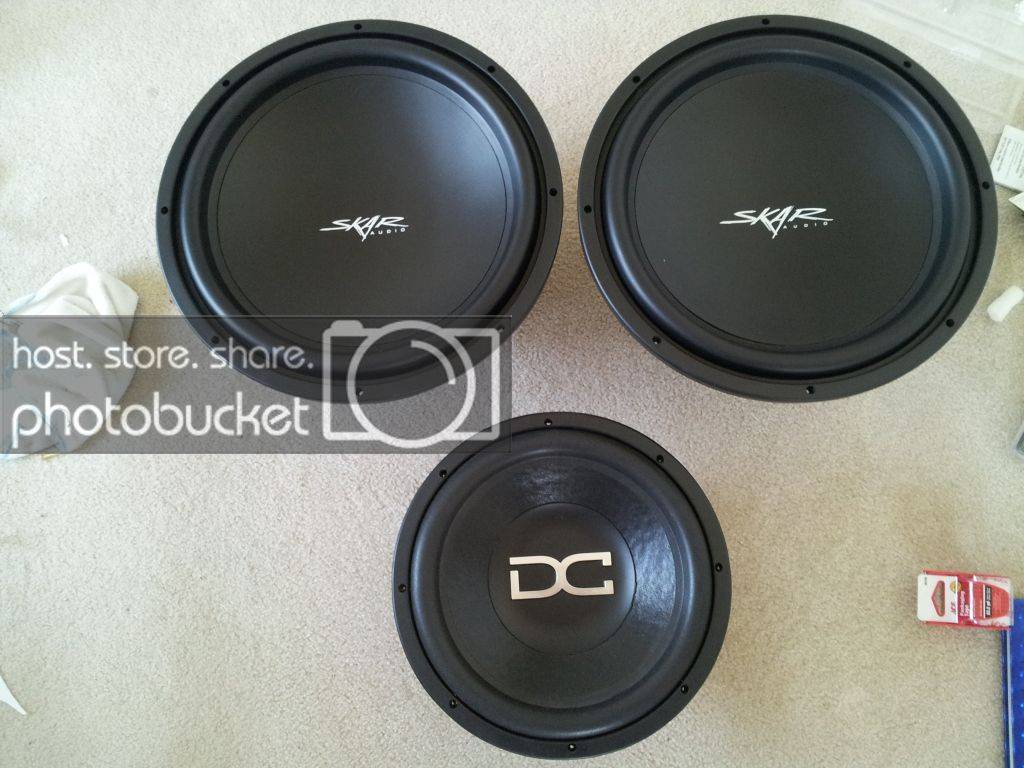

The woofers compared to the old DC Level 2 12 that was in the enclosure. Don't ask why one logo is larger than the other... I have no clue lol

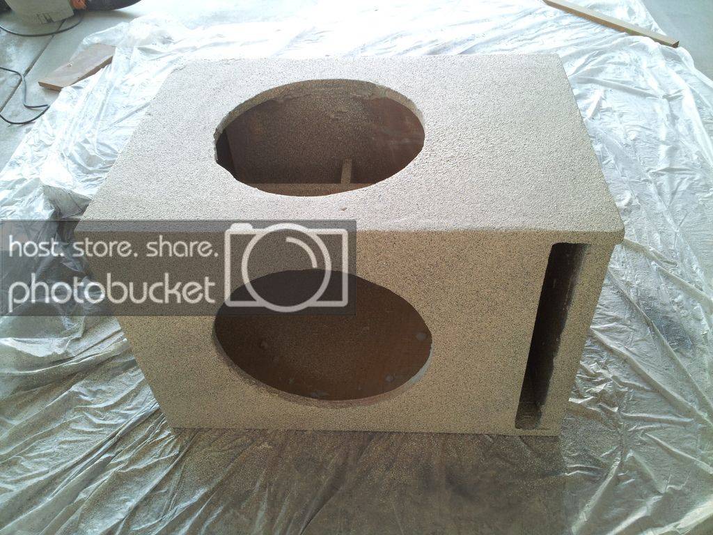

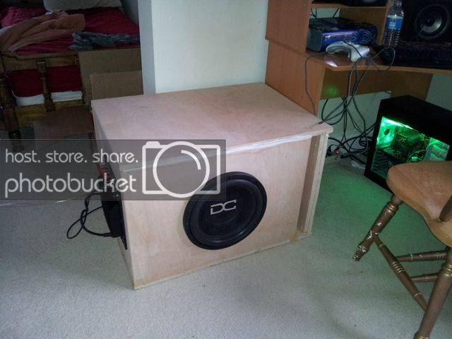

The Enclosure that used to house my dc lvl 2 12:
Before:
After:

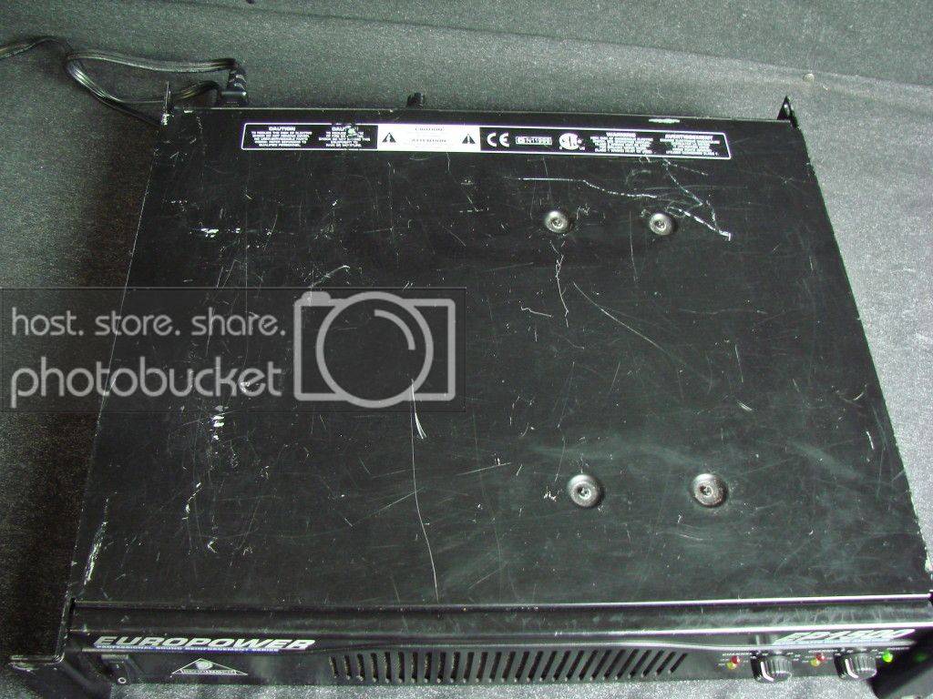

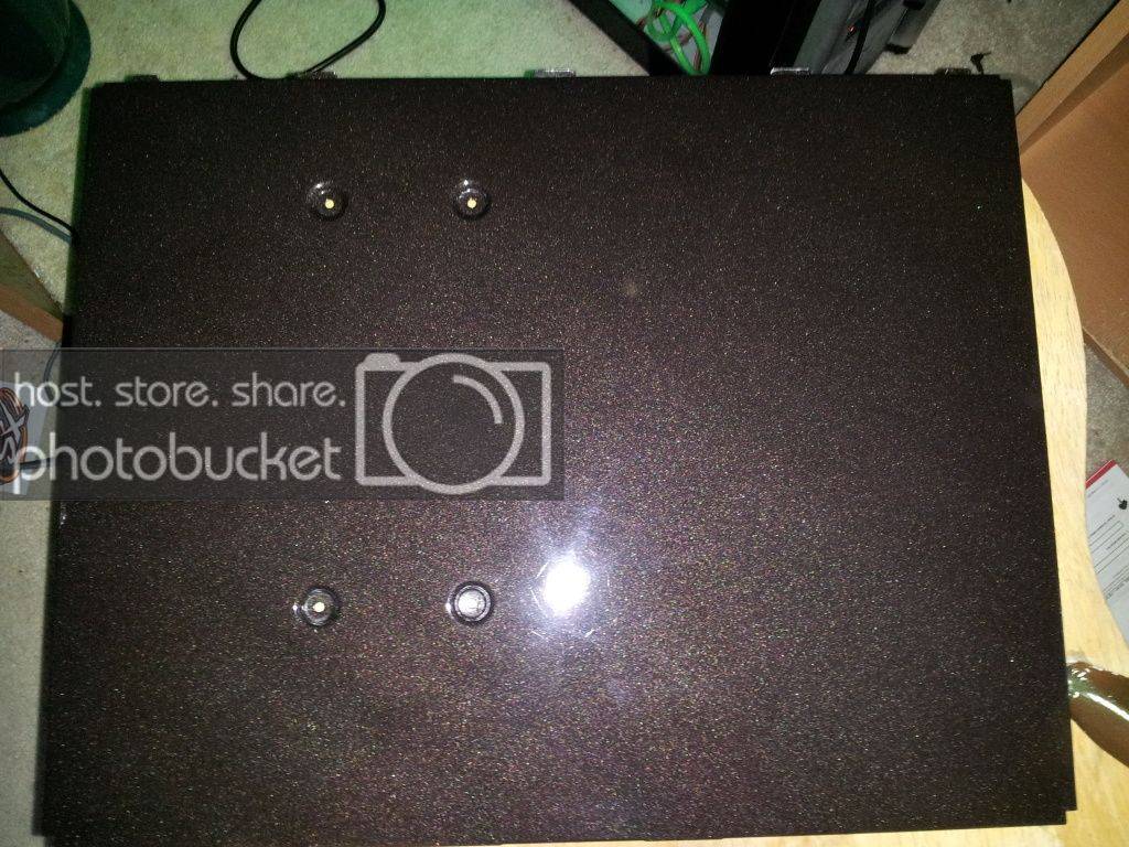

I got the amp really cheap because the top had alot of scratches... Nothing my pro painting skills can't repair! (I Joke. But Seriously)
Before:
After:

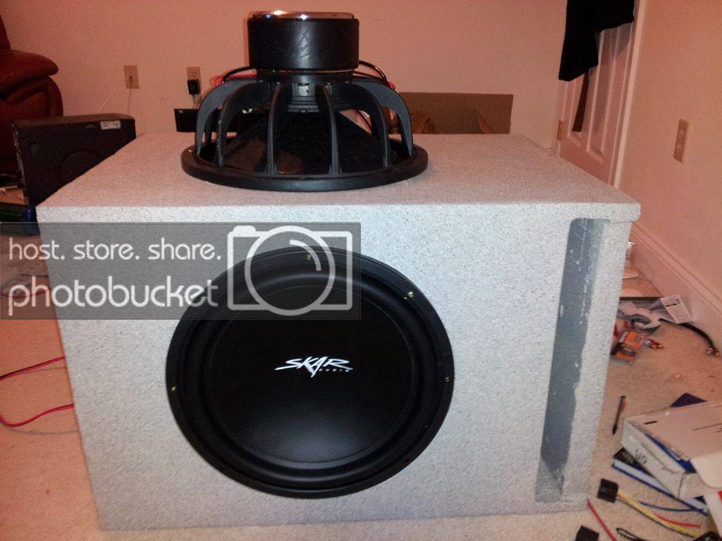

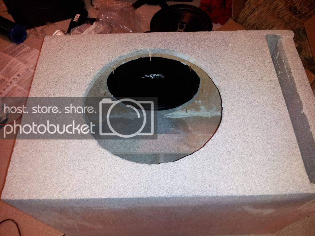

And everything is put together!
Not bad on that paint job.. On the amp. lol

Interesting choice for the enclosure. lol
---------- Post added at 12:09 AM ---------- Previous post was at 12:08 AM ----------

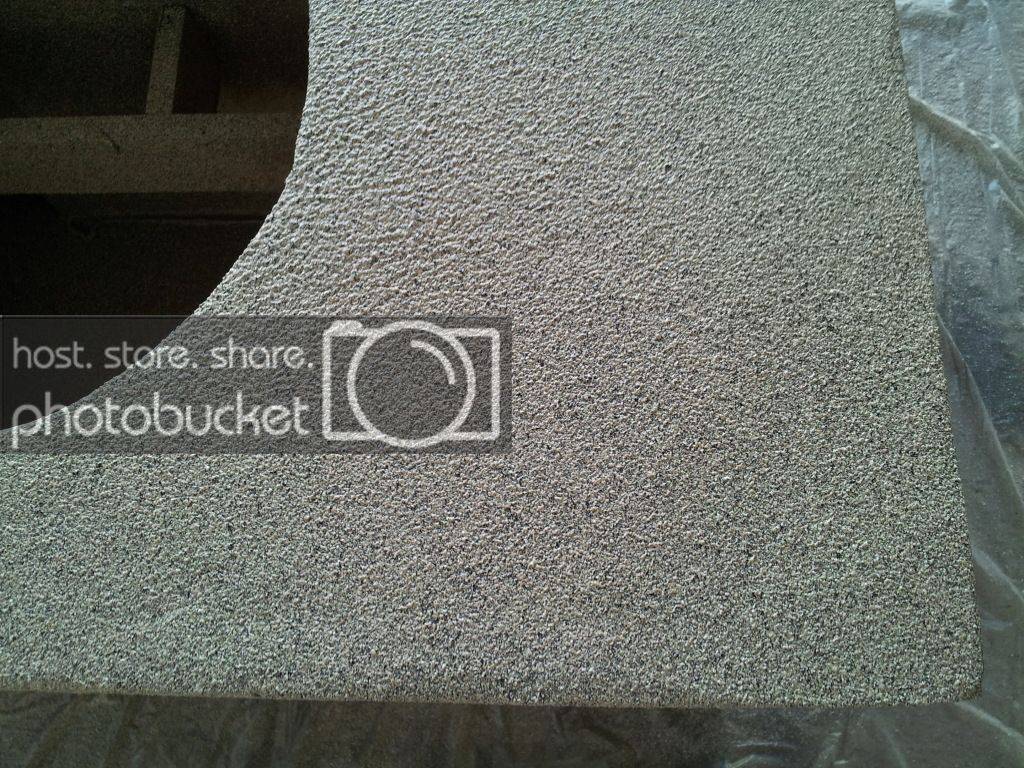

I always **** up painting wood haha, so I decided to use something that would basically be idiot proof. Painting metal however I can do some nice work :p
Color doesn't look right in the pics, its more of a gray color.
Well I hadn't modeled the woofer before deciding to buy it as Skar had a decent rep on CACO... I wish I had. It is a nice driver but their recommended box volumes are way off! Likely to increase the audience that would purchase them. The motor is way too weak for the displacement of air that it has to move.
Green: 4.4 Cubes (2.2 Per woofer)(Min Rec by Skar) - f3 = 34Hz
Red: 8 Cubes (4 per woofer) - f3 = 28Hz
Blue: 16 Cubes (8 per woofer for shits and giggles) - f3 = 20Hz! (Awesome)
Enlarge in imageshack.
Its sad that the motors are so weak that you need at least 4 cubes per woofer (more than max rec.) to get good low end from subs that are advertised as low end monsters.
