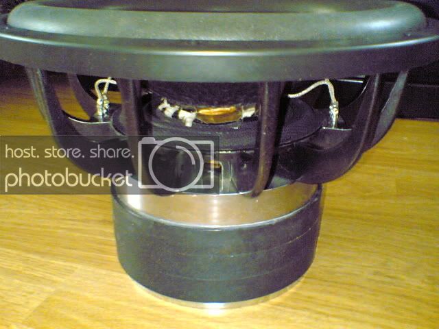

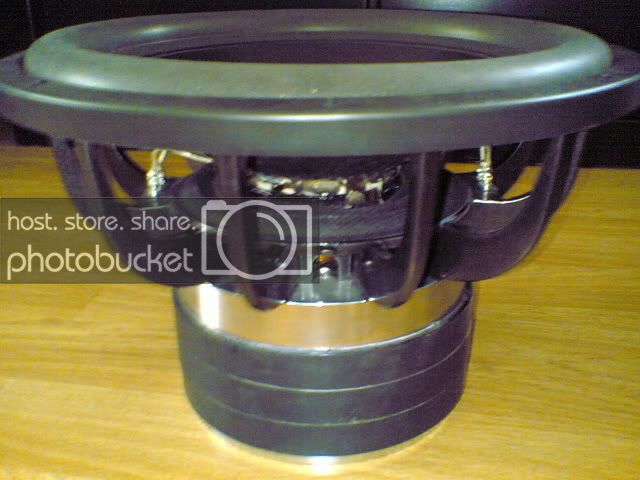

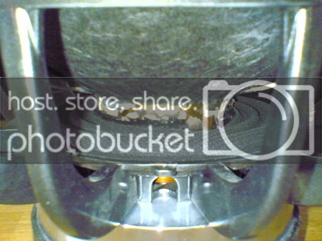

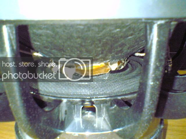

I just received my brand new re destroyer sub(well reconed) on tuesday and put it in wed and was playing it and it sounded pretty good but yesterday while i was going to work, i turned it up some more to see what it could do and it sounded almost like the VC was rubbing and few seconds after hearing that, it started sounding VERY scratchy, crackly, and slap sounding. I immediately turn it off and disconnect the sub. I took it out today to take a look at what the damage was and it seems the spider ripped apart from the voice coil(not too sure). I know this is goign to need a recone but anyone know what caused this? I am thinking it was the voice coil misaligned or not centered properly and it rubbed then got worse when it was moving more.
I have my gain set right(amp is 2500D) w/ bass boost off and i have it in a 4 cu ft box ported to about 38(high but its temp), if this matters.

Thats either a defect, or you seriously shouldnt be playing with high caliber equipment like this.
not trying to be modest or anything but, i believe i have enough experience with subs and equipment to be able to use this sub, this is just the first sub i've ever had problems with.
Thats looks like a defect. You would have to be doing something very very wrong for that to happen. Even overpowering a sub, that wouldnt be the first thing to fail. Hmm send pics to david.
yea, i'm still waiting for responce but i sent him the link to this thread so he can see the pictures.
