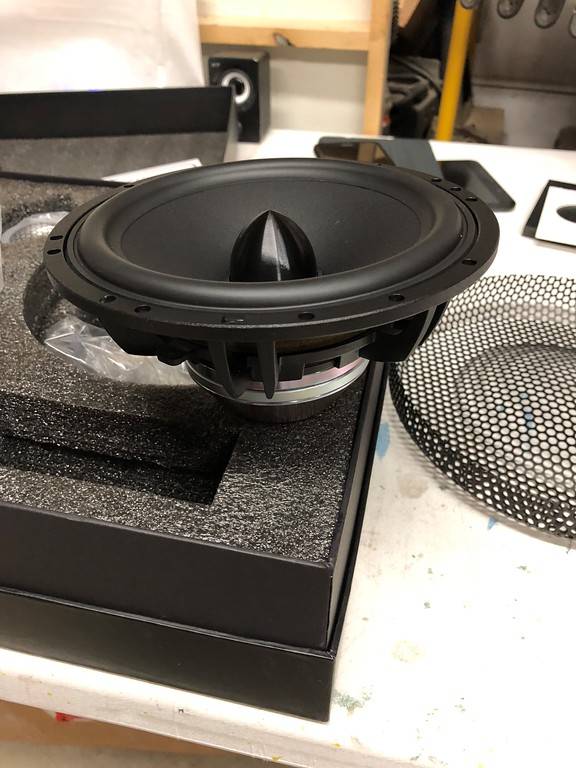

Stevens Audio SA-6CS component set (2 way full active - for now)

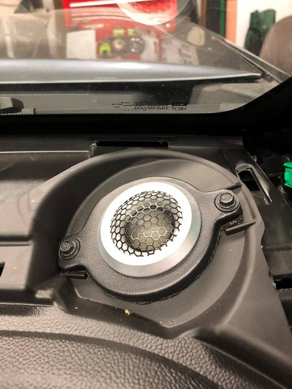

We lucked out being able to keep the factory shroud as it totally hides ALL the power wires, speaker wires, remote ons etc. Only cables visible for now are the TOSLINK cables, and those will be hidden by covers eventually.
