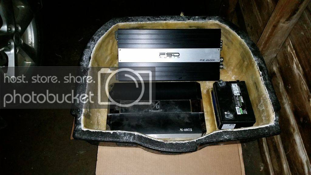

So the rainy weekend ruined my plans. So I decided to go off on a new project. I started to fiberglass my amp rack. I've ended up taking out quite a few gussets in the foam and figured a hard shell couldn't hurt. This will also give me a decent surface to thread into. So without further ado. Some pics.
So. Here I am just making sure the new amp is going to fit. Looks like it will. The 4 channel goes in the spot under the Mono. Looks like space isn't going to be an issue for the 4 channel either. The foam has been pretty beat up. The fiberglass shell will sort or be like starting fresh again.
I also decided I would make a battery tray as part of this fiberglass shell.
And here it is after the fiberglass shell has been laid. I'm not the best at this, actually my first ever go with fiberglass, so it doesn't look the best but it'll do as intended.
A few questions tho
1. So I forgot to spray pam down first and i'm having trouble getting it out. I have tape down so it isn't stuck to the foam but I just can't get the tape to come up. Any suggestions? If not its fine that it becomes a permanent fixture.
2. So after the fiberglass was laid I realized that the surface isn't really flat. Is there an easy way of making this a nice flat level surface? I got plenty of fiberglass fabric left and plenty of resin and hardener.

I'm not 100% on removing it from the original foam, but for #2 I know that you keep adding fiberglass until satisfied, let harden, then sand and add bondo until it's flat/level

Its actually on masking tape. I just can't get all the tape off the foam all at once. Like I said tho, it really isn't a big deal I can add carpet to the whole thing instead of just the fiberglass. And I was thinking of just adding more to build up a few layers and just sanding it down until it is as flat as I'd like. I didn't think of using bondo. That would probably be much easier to work with than the fiberglass resin.

Okay. So he used lightweight filler with the fiber glass resin. That seems like a pretty good idea. My problem there is 2 fold. Its not flat so when I put the amp in it doesn't sit flat. Id also like to level it out pretty well so I think I'll be able to do this as well. Its tough because a lot of these guys are doing really a very different application. Like in this one he was working on something that is going to be pretty visible most of the time whereas mines generally going to be hidden 100% of the time, so a perfectly smooth surface isn't as important to me. Plus I plan on covering this with carpet to match the trunk when its all said and done. So I guess in short, can I use the filler in a way that I can fill in the very deep spots and valleys in order to get a perfectly flat level surface? Were talking maybe 1/8 of an inch to maybe even 1/4 inch.

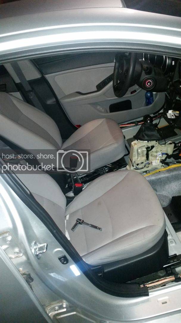

Not much for updating today. Last night I was merely prepping for work to come. So I removed my floor liner last night. Not a terribly hard job but I had removed some components that I have never removed before so there was a bit of a learning curve. Still only a few hour of work.
Here we have the seats removed, center counsel removed, most of the dash has been taken apart.
Floor liner removed
Like I said it was mainly prep work so I was just getting the floor liner out and making it driveable again. Unfortunately this is my daily driver so I can't just park it for a week or 2

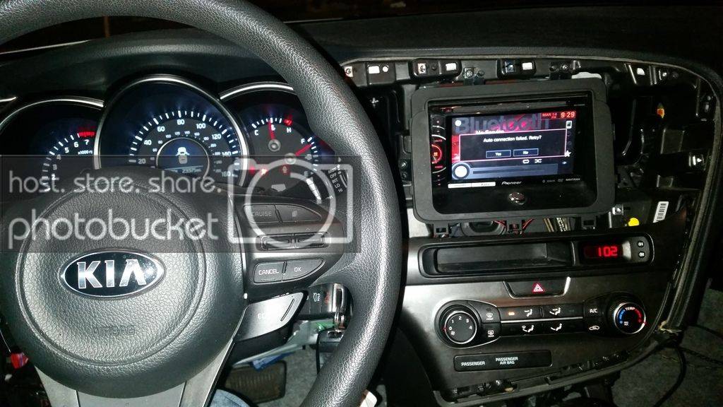

OKAY! Passenger side wiring just about done. I have some stuff that is going to need done once I get the dash completely apart and the headliner off. I'll be running the bluetooth mic and wire for the display up there. The I'm going to attempt to make a mold to fit the display in the sun glasses holder. Idea complements of KHA. So here we go!

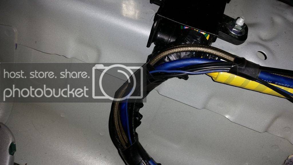

All the wires fit into the OEM loom.

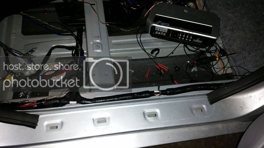

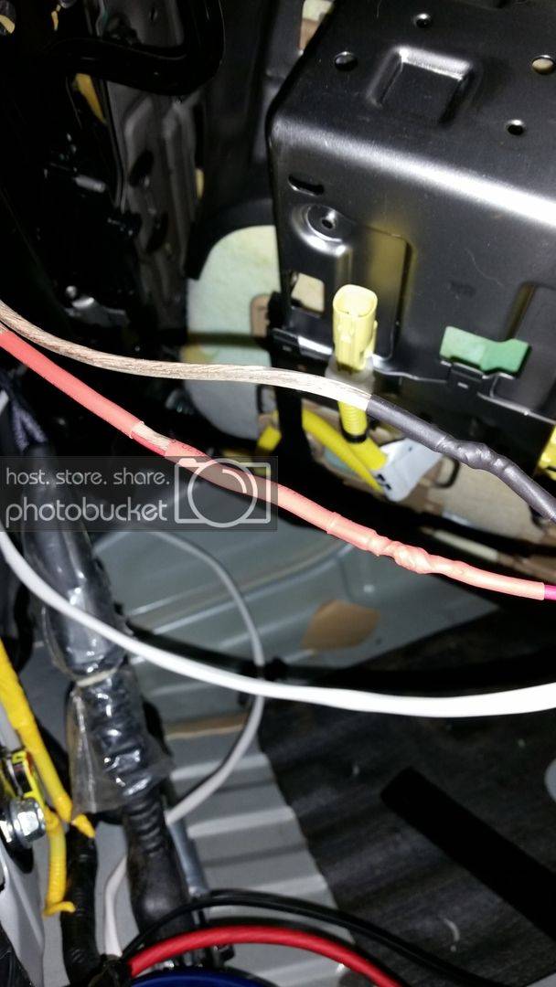

Ran some new wire for the rear speakers. Solder and hear shrink again.

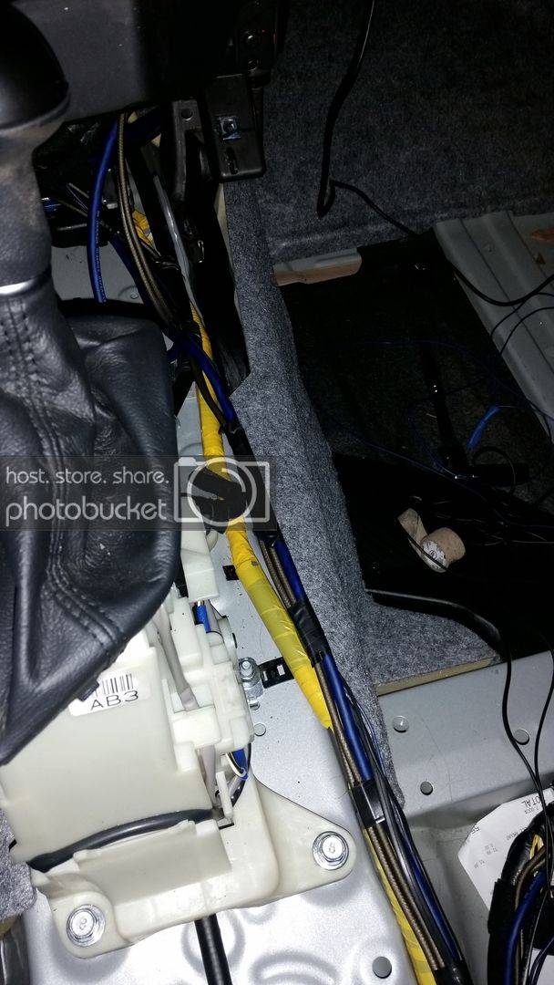

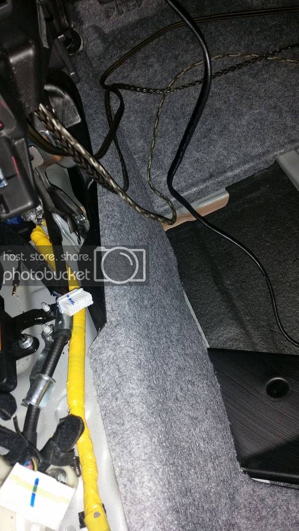

Ran under the seat belt
All I'm doing is just following OEM wires and taping mine new runs to the old one. I was going to loom it all up but I ended up covering the wires just about completely in tape. I still might before everything goes back together but I think I'll need some loom with a bigger ID.

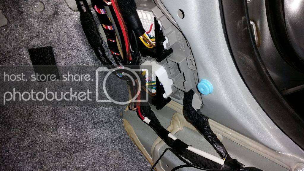

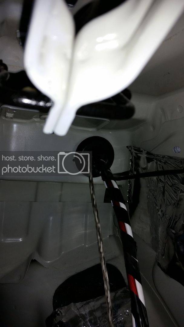

Ran them in the back through a OEM grommet. I had already cut the center out of the grommet to allow a little bass in as I try and solve my seats up problem.

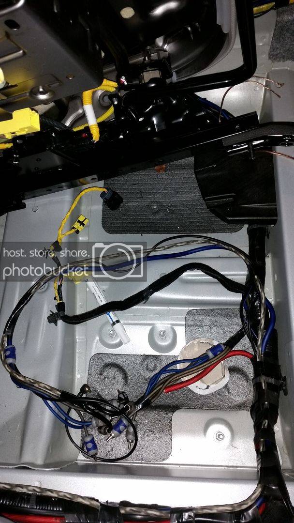

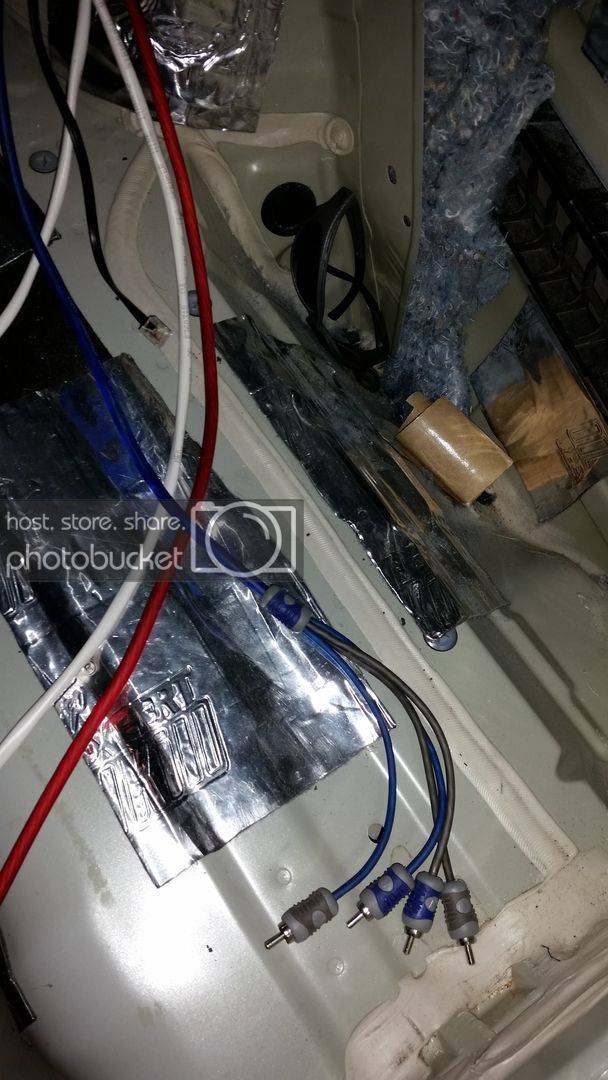

Somehow I ran into a bit of a snag... So my path to the trunk for the RCAs and the Bass knob wire should have been shorter, much shorter for the RCAs, yet I'm short about a foot, two feet to be on the safe side. So I guess I'll have to by some extension RCAs and I might just solder in some wire to extend the bass knob. I really don't understand how this happened but it did and I'll have to work through it.
I put back on the panel that covers the seat belt guts to test fitment. Couldn't have been more beautiful!
Ay suggestions on what I should do about the bass knob control wire and RCAs coming up a little short?

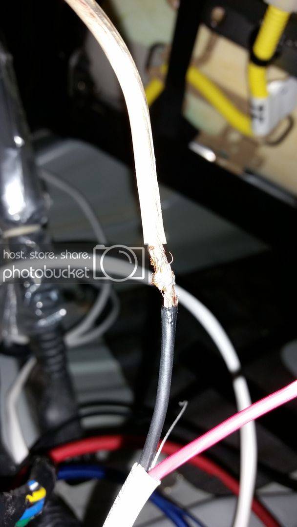

Its been a while. I've been going on with some personal issues in my life so I just haven't had the motivation to get up and do something. But anyways. I got 3 foot RCA extensions. I'm just going to solder in a 3 or 4 foot extension into the bass knob wire. I soldered my driver side speaker wires and led them to the back. Ran the 0 Guage. It was tough getting it to fit through the grommet so Im still brainstorming that. No pics, sorry. Its just been a little here and a little there when I can actually get up and get something done.
