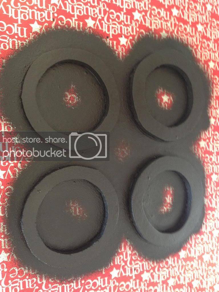

Making the templates for the speaker brackets and giving them a rubber coating so that they are waterproof. Will also be sealing them to the doors with silicone and sealing the screw holes after drilling. Had a couple air pockets. That's what the bubbles are.

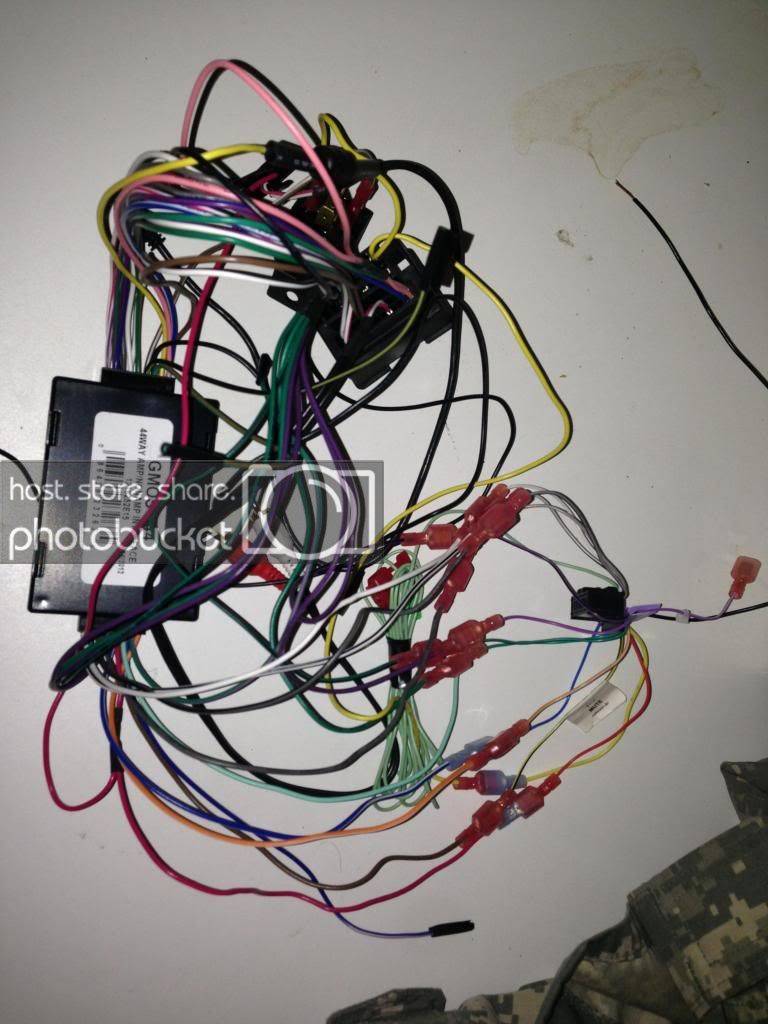

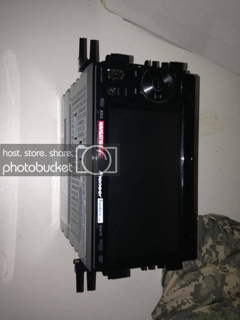

The headunit with the harness all done. These things are pretty ridiculous because of retaining OnStar.

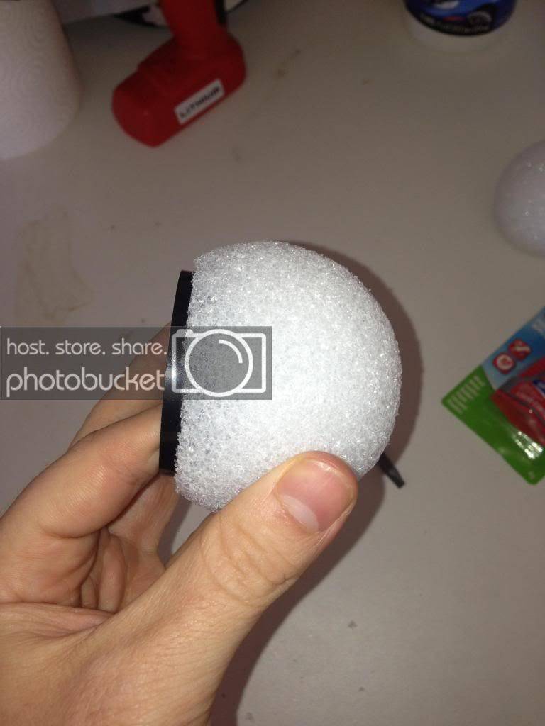

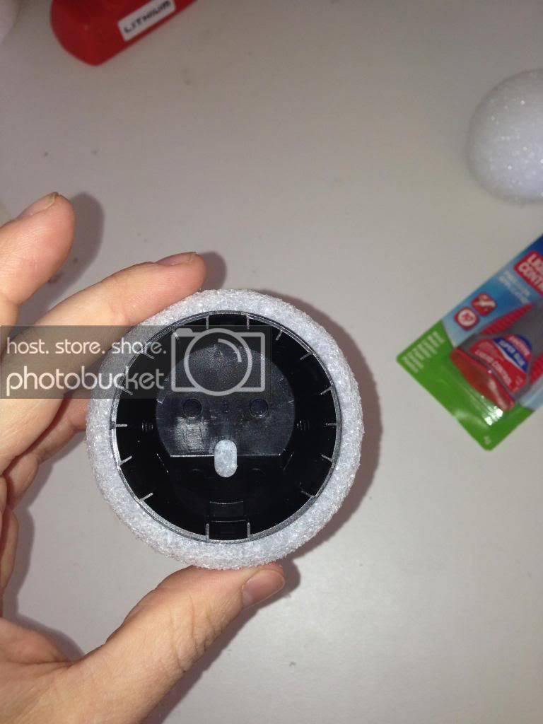

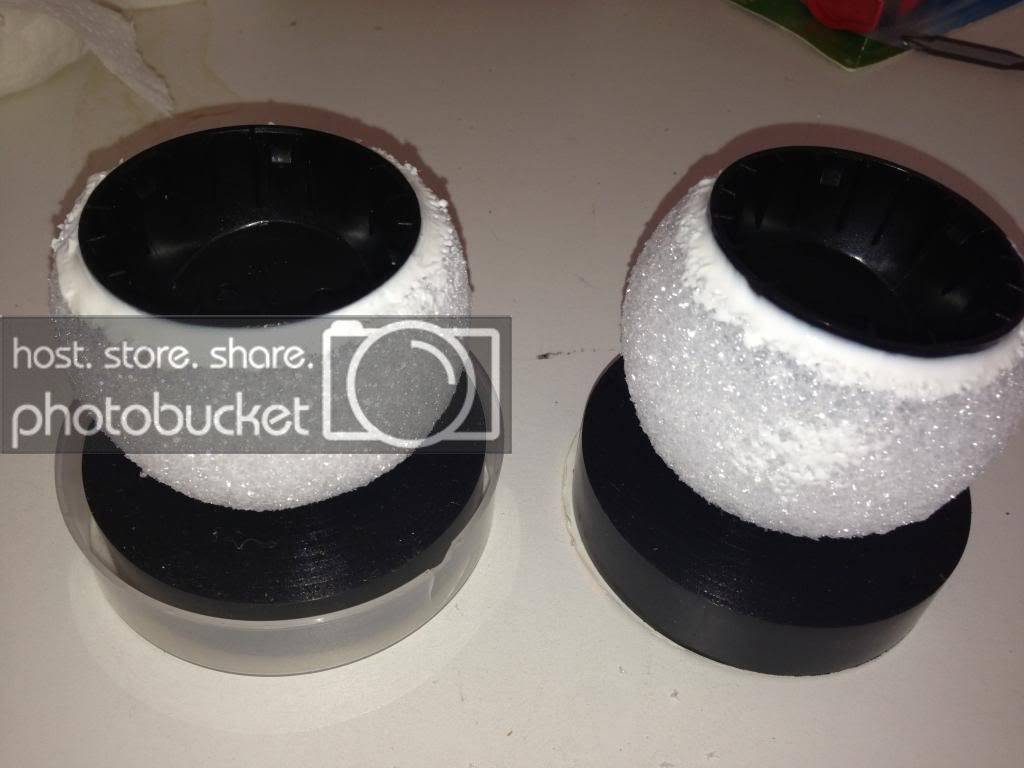

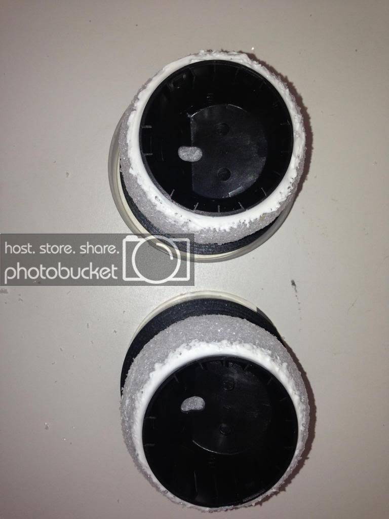

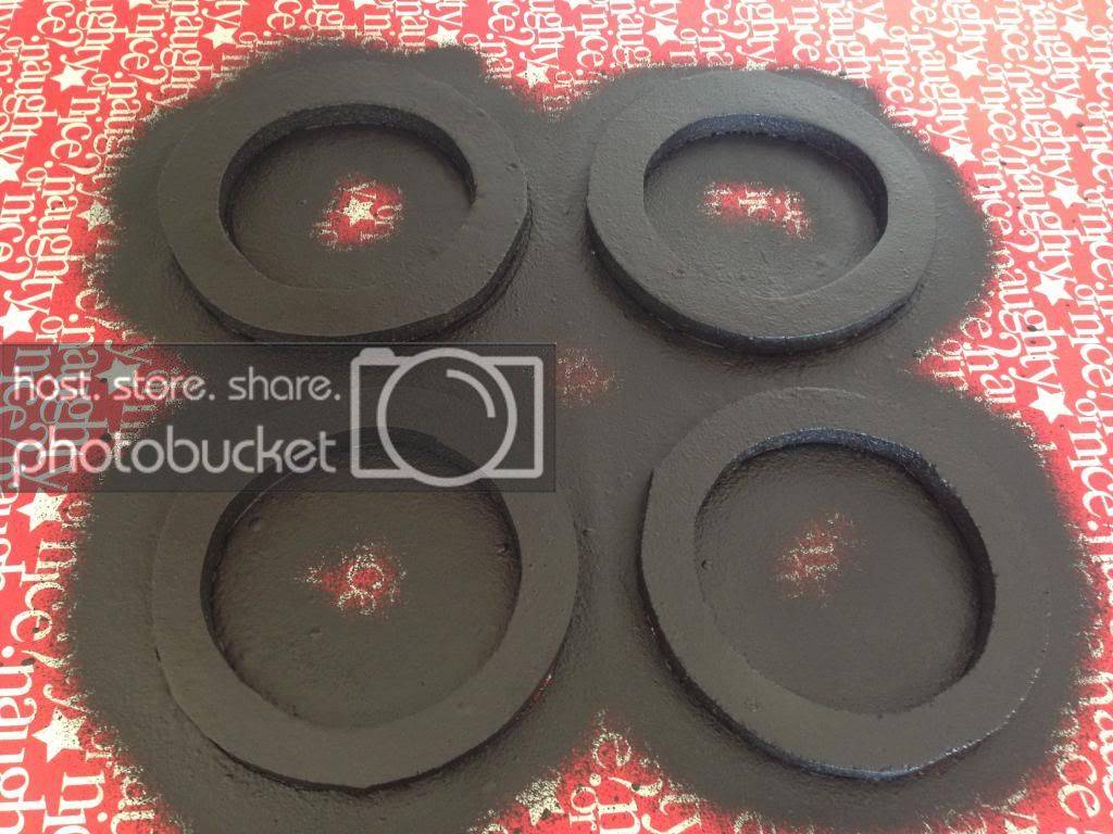

Working on the tweeter pods. Just using dense foam and using adhesive to stick the cup in. Then using silicone sealant around the edges. Once dry, on Friday I am gonna start with the plaster and then sand them down smooth. Will be painting them with plastidip so they are smooth after. Should come out really nice for my first set of pods. Here is the progress so far. Just whittled out the middle

So the build was interesting this weekend. Got started and everything was going smooth. Got the head unit in and tested it out and everything worked fine. So I go to use the bathroom. My friend was upset that he was unable to get the steering wheel controls to work. I had already told him before that he would have to buy a separate module but he didn't listen. So he plugs in a hot lead to the top of the GMOS44 interface which costs about $200 to keep onstar and when he did.... Poof. The whole thing went up in smoke. I come out and ask what the smell was. He tells me and I just laugh cause there was no fixing it. So he ended up going the cheaper route and buying an LC2i. Screwed our whole timeline trying to find a shop with one. But he gave me the DVD player as payment since he didn't need it anymore!
