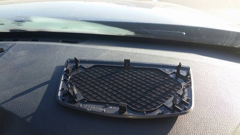

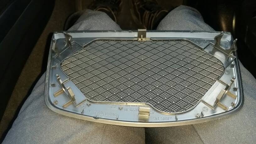

I'm riding in a 2013 BMW 328i and the center speaker is blown. This is a common issue but I didn't see any images online for what the grill looks like when removed.
The grill has plastic clips at each corner and the center on long edges. I started in the middle and worked my fingers around, carefully applying pressure upwards until they released (slowly). The clips are unique, see below.

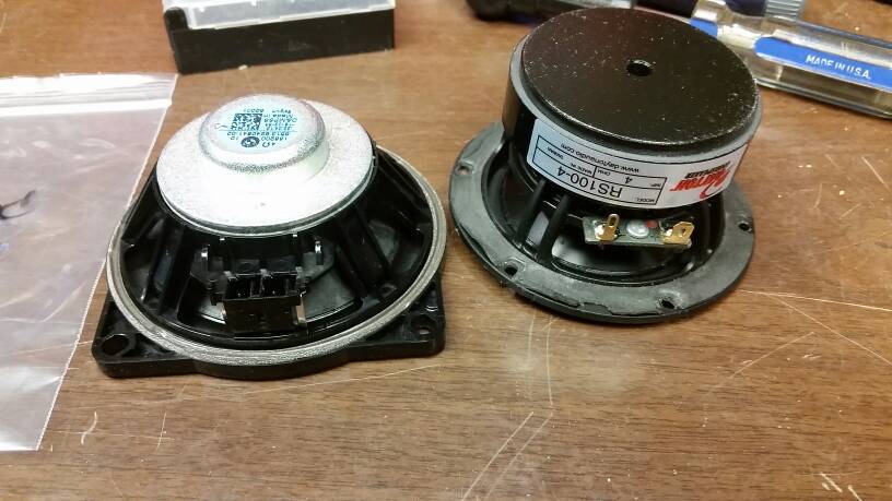

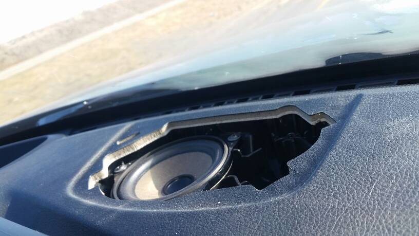

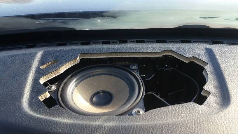

A Torx bit and 90 deg adapter will be needed to remove the driver.

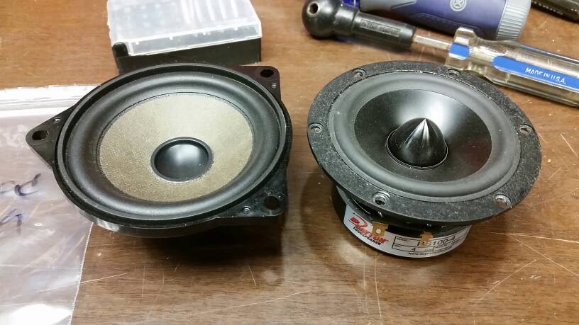

Looks like a decent driver. ITT or something? What will replace it? Don't tell me... MB Quart and an ESP-3. //content.invisioncic.com/y282845/emoticons/santa.gif.e1ec9cf2e0a0dd232ad35aa594a126d0.gif
Nice, appreciate that. Cold weather to be messing with plastics!
I pulled the grill while riding shotgun, we had a 2 hr drive for work and the center kept cutting out. It's a dvc driver but only one coil was used.
Not sure on replacement, maybe a Vifa or Peerless neo.
