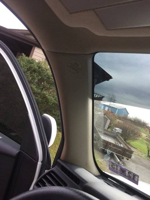

Factory pillars.

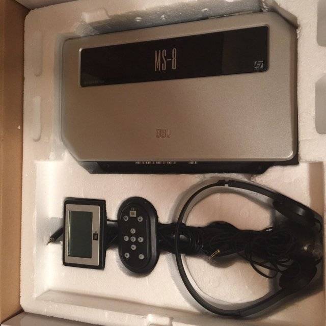

I didn't get a chance to work on anything yesterday but I did manage to sell the Sundown SA18 sub and I opened up the MS-8 to check it out. So pretty...

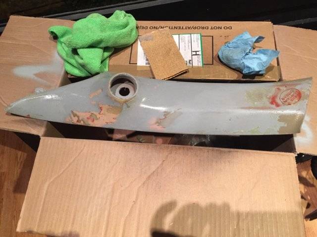

Spent another hour or two working on the pillars, mostly sanding. I have the driver's side ready for primer and some final sanding. The passenger pillar has a little more work to do.
They are getting a little closer every day. I placed the order for vinyl today, it will arrive tomorrow. I really hope it matches up.
I primered the pillars today, it really shows the problem areas. Hopefully I'll finish them up tomorrow and try my hand at wrapping them tomorrow or Saturday.

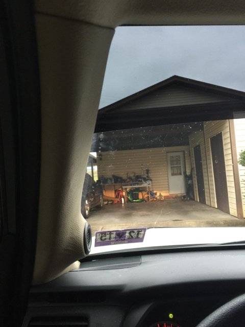

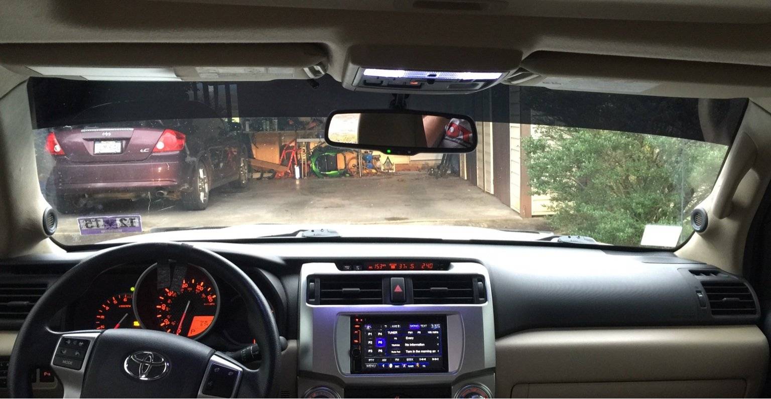

I know you are probably tired of seeing pictures of a-pillars but guess what, I posting more pictures of a-pillars.

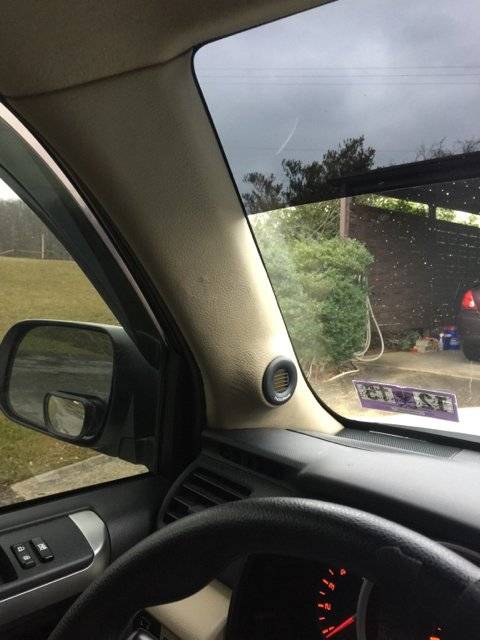

The driver's side is done. I got a couple of stretch marks but I think I learned a little something from my mistakes. Hopefully the passenger side comes out a little better.
Passenger side is installed. They aren't perfect but I will live with them for a while. The tweeter isn't hooked up yet and won't be for a couple of weeks.
