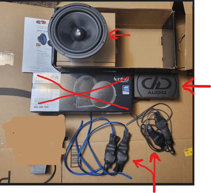

I'm also offering these as a 2-way set. CDTT HD-M6 drivers, DD Audio Ceramic tweets, 12db 2-way Linkwitz-riley crsoovers at 3.5k, shipped for $300. I built the crossovers for inline ease made of OFC copper air coils and 1% Metalized polypropylene caps, silver plated ofc copper wire to boot!
Actually, at the price of the CDT, the Rainbow 2.5 set is hard to beat. And that is the same company on eBay, they have them on sale there too. The Rainbow will move the stage up a bit from where a standard two way will get you. I bit more treble forward midrange where a 6.5" tends to provide more emphasis on the lower midrange sound. By crossing that mi/tweet where they do,
I've run both the HD-M6's and now the Rainbow Profi Crystal cone midbass. The rainbow is a solid driver as is the CDT.
