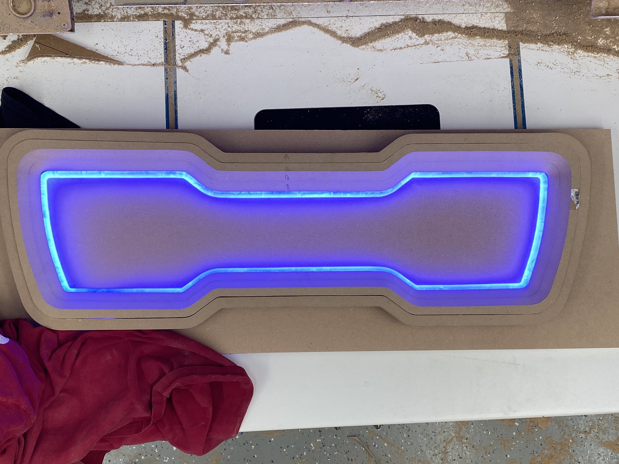

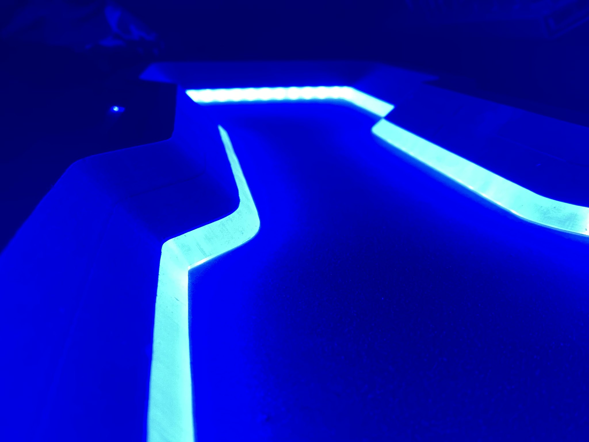

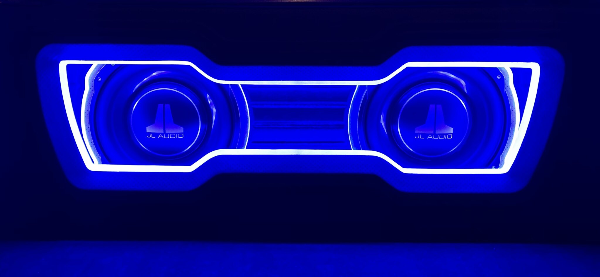

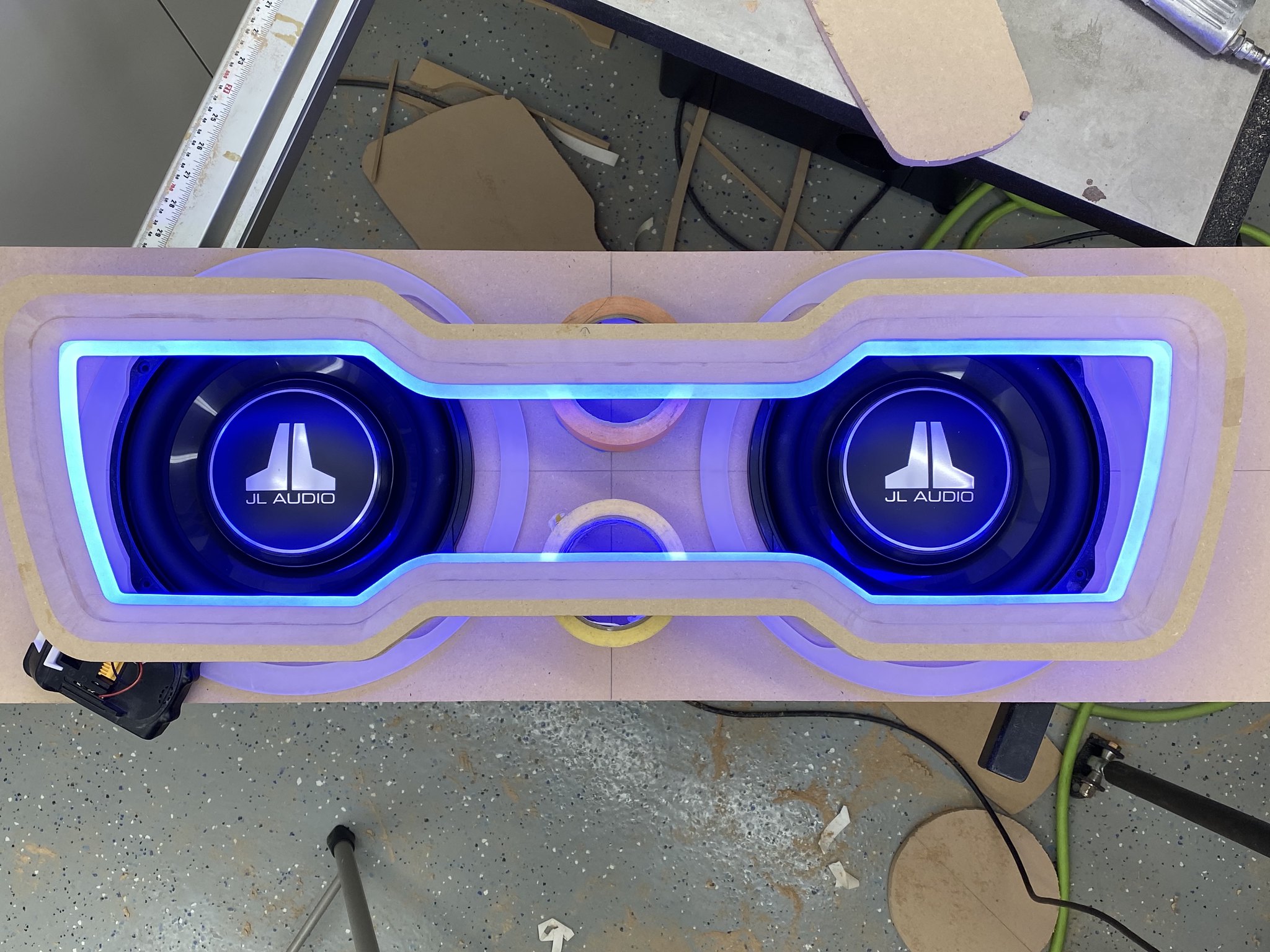

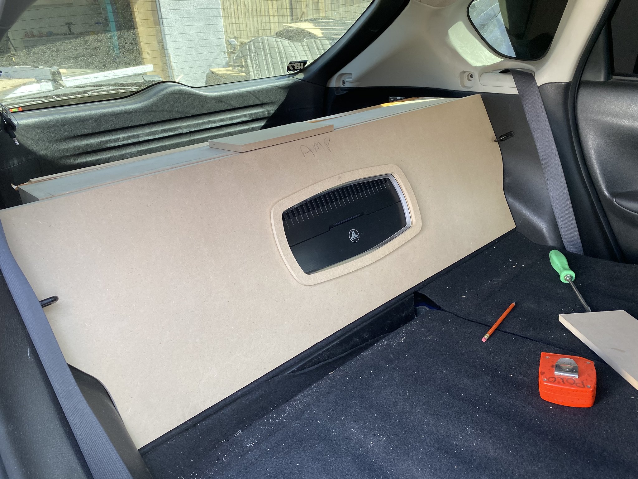

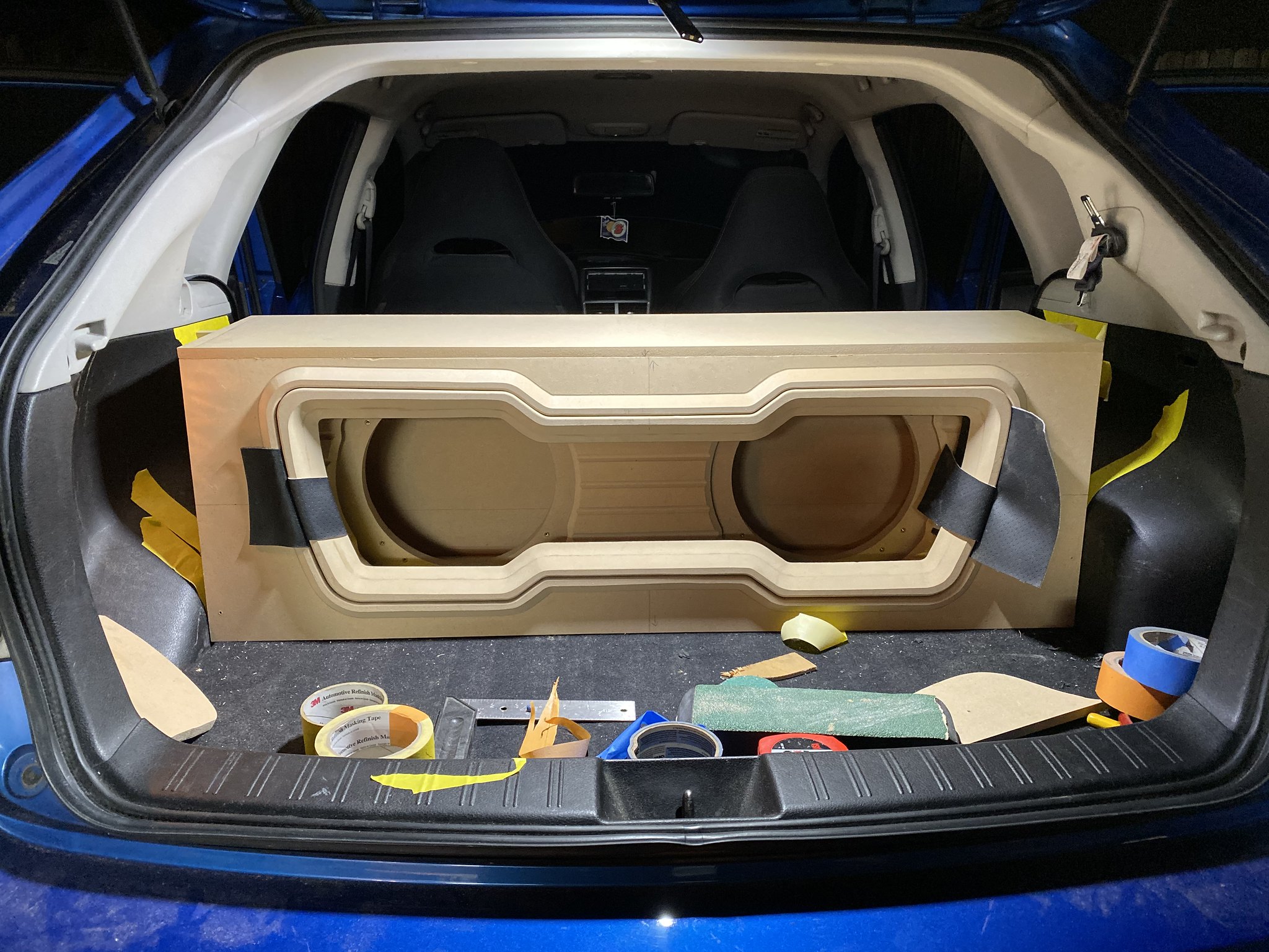

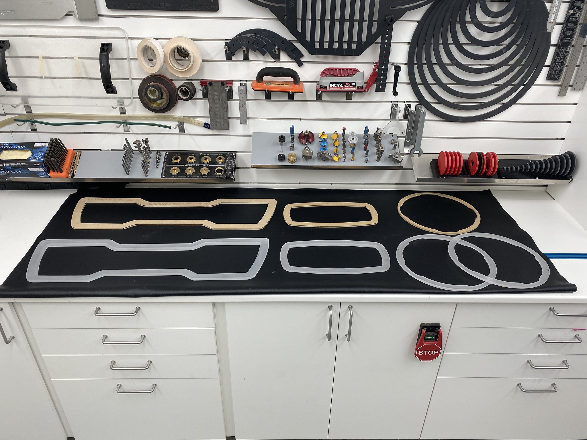

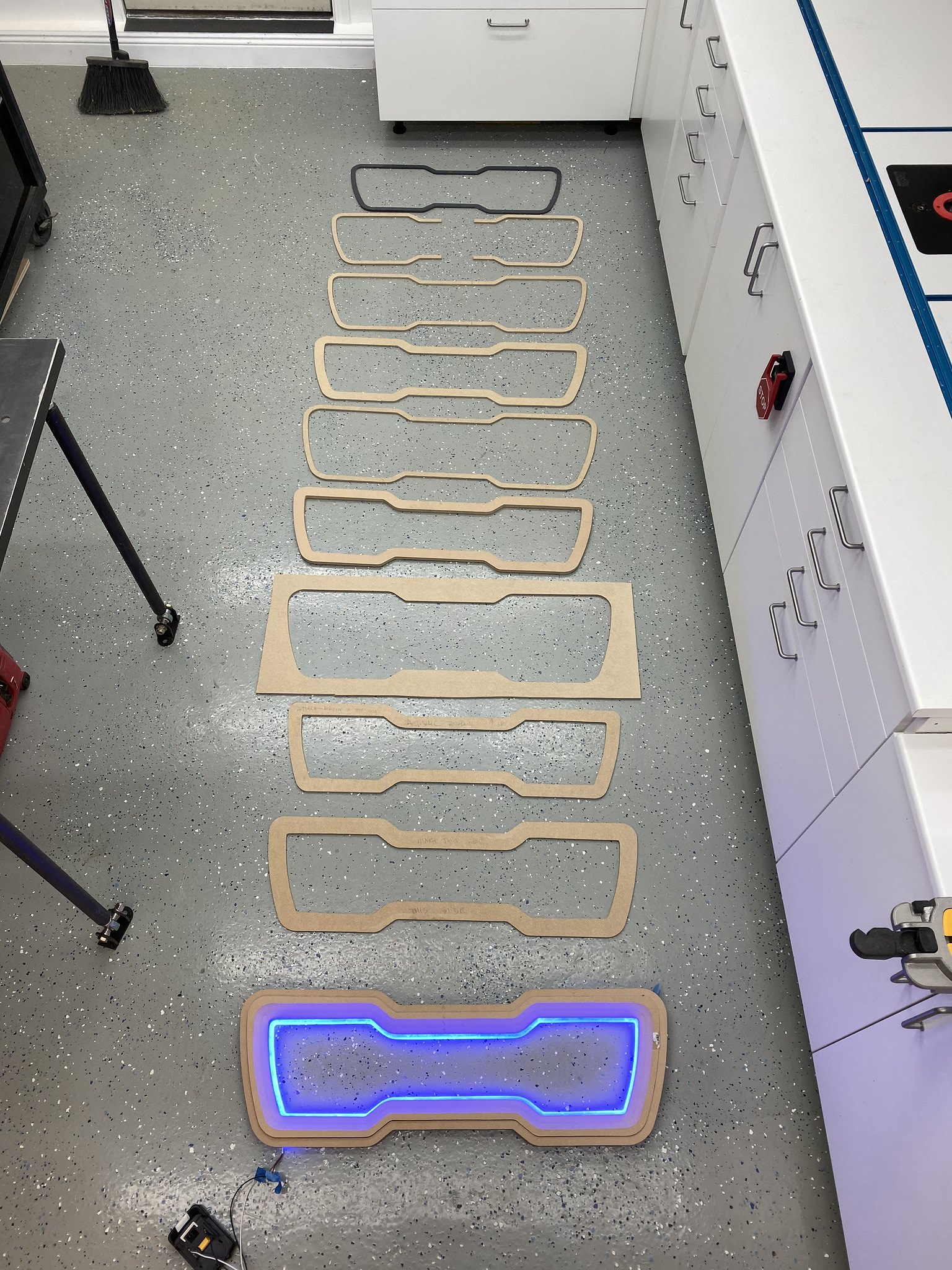

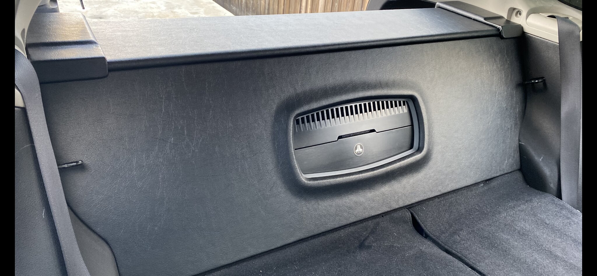

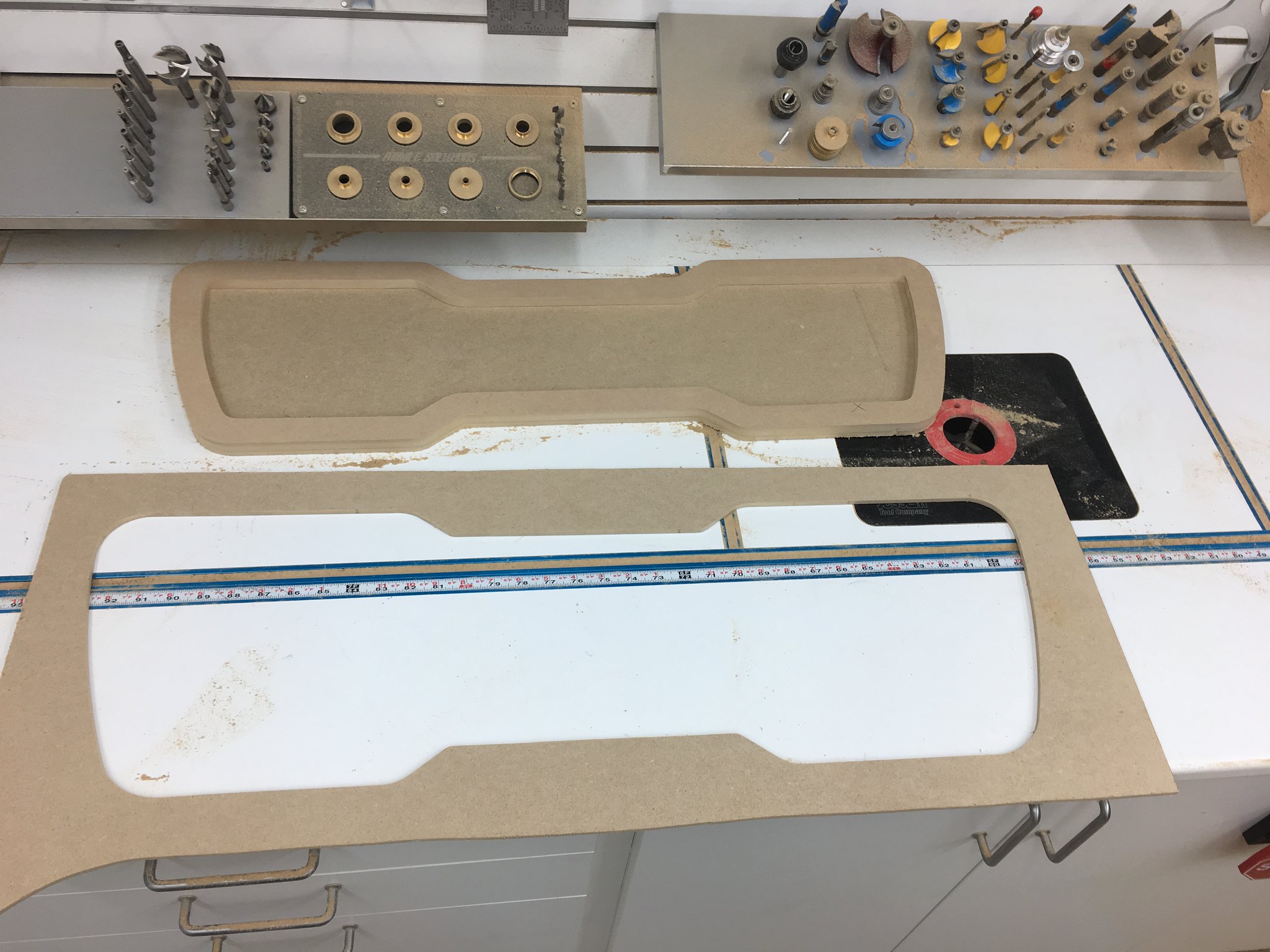

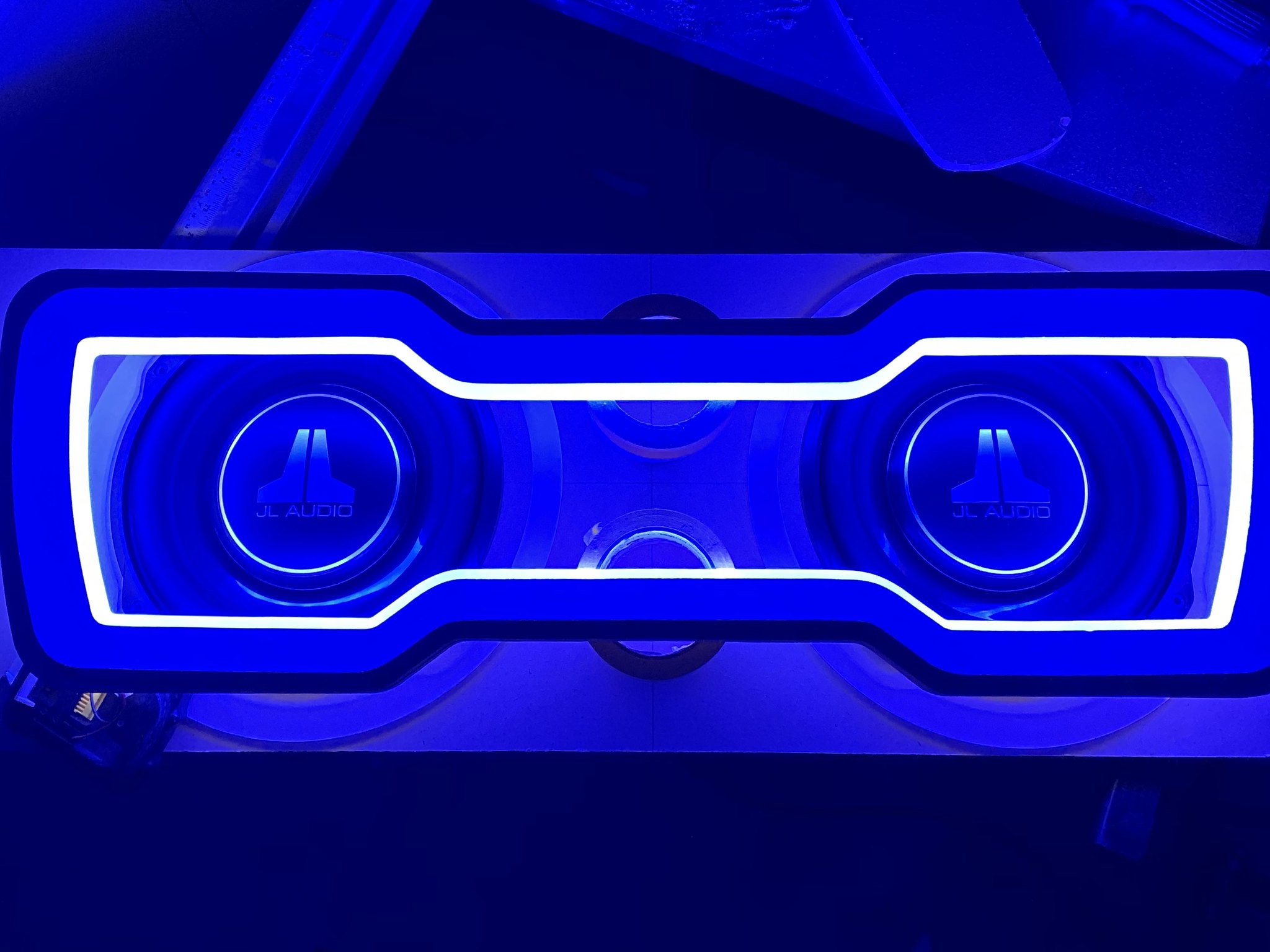

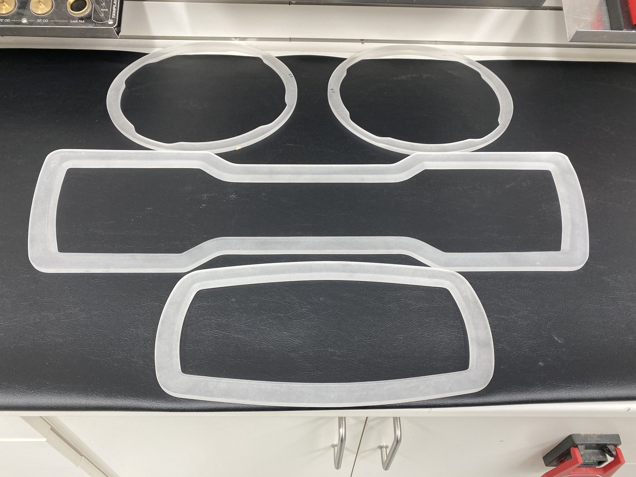

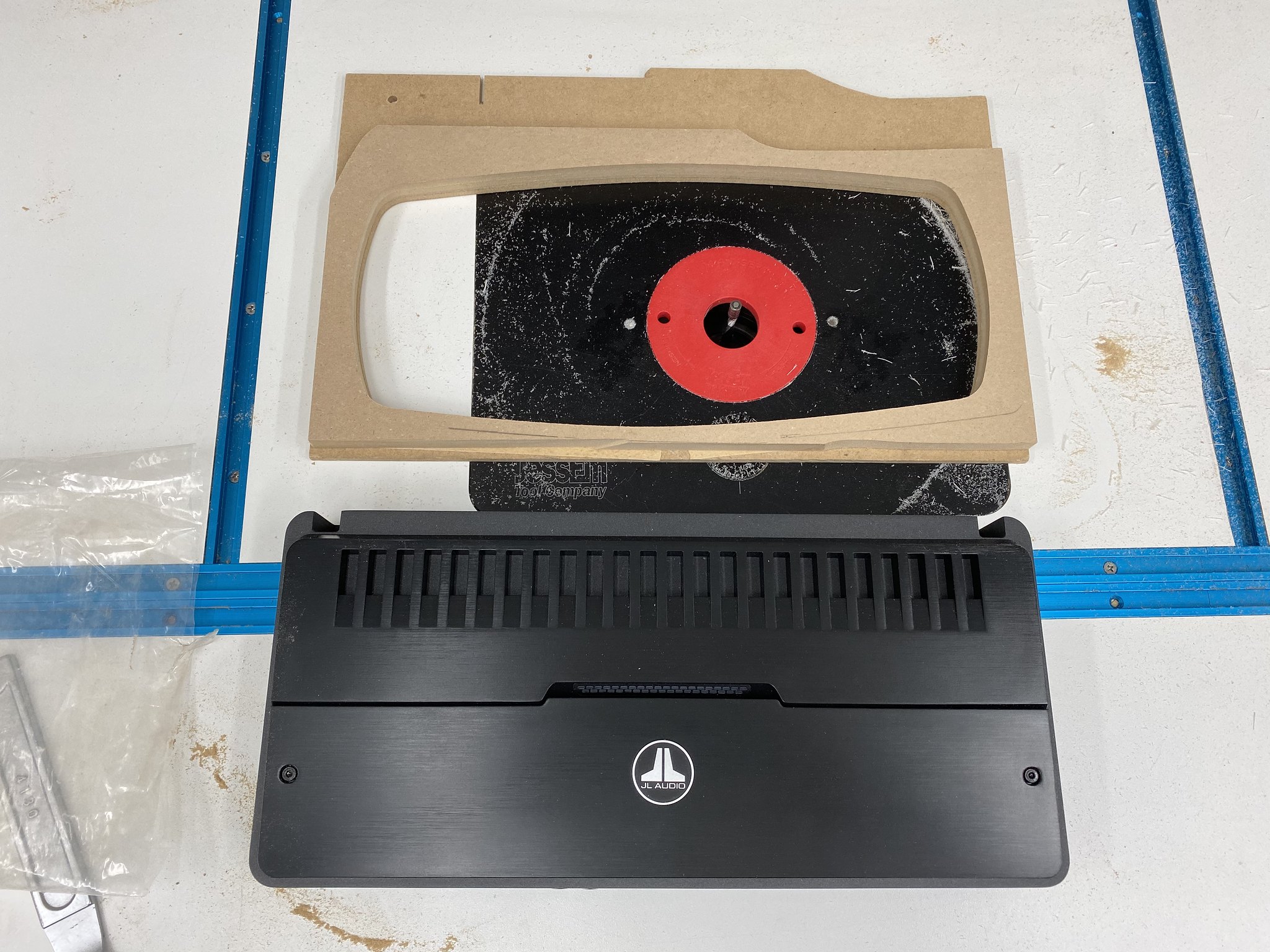

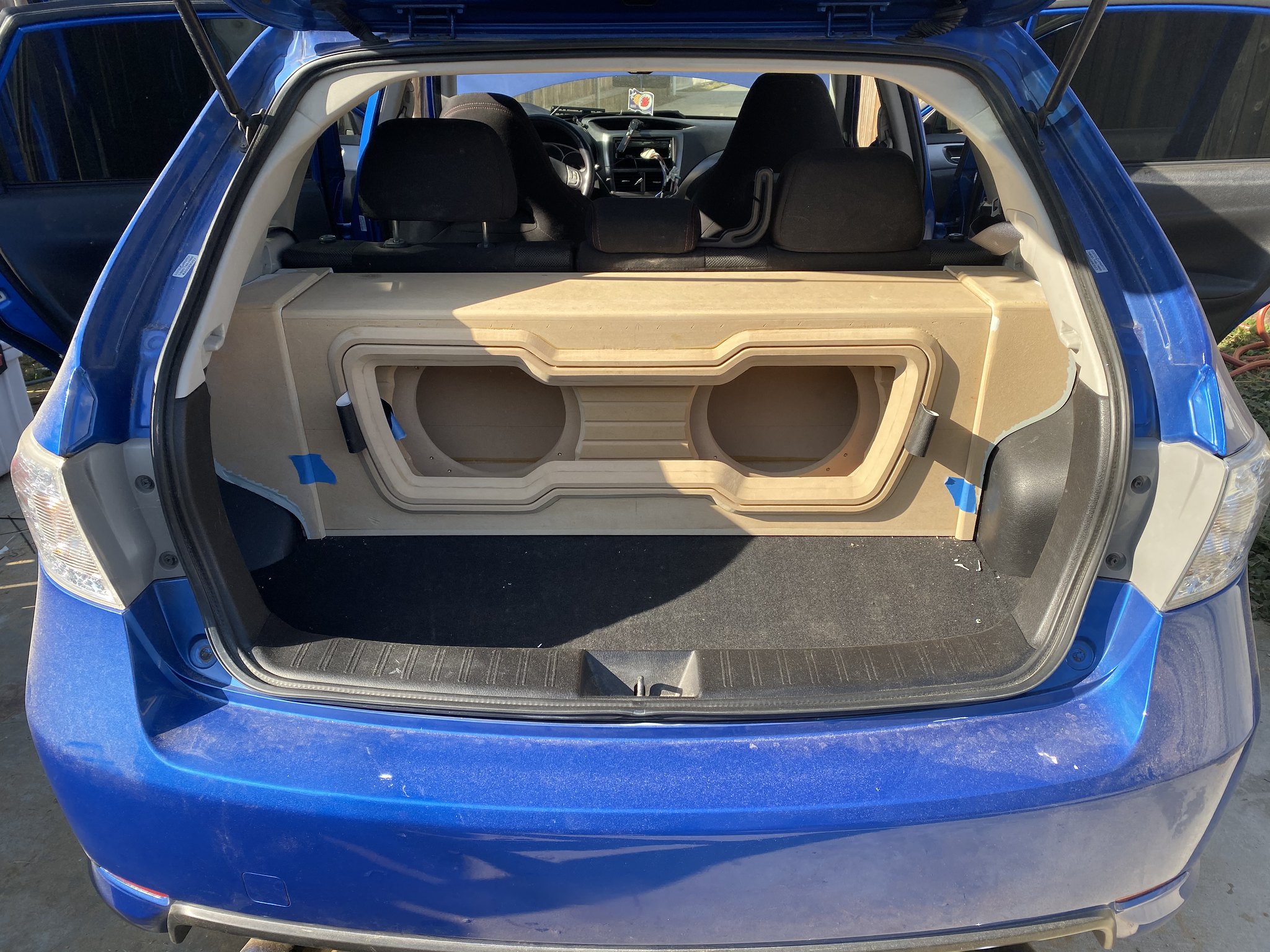

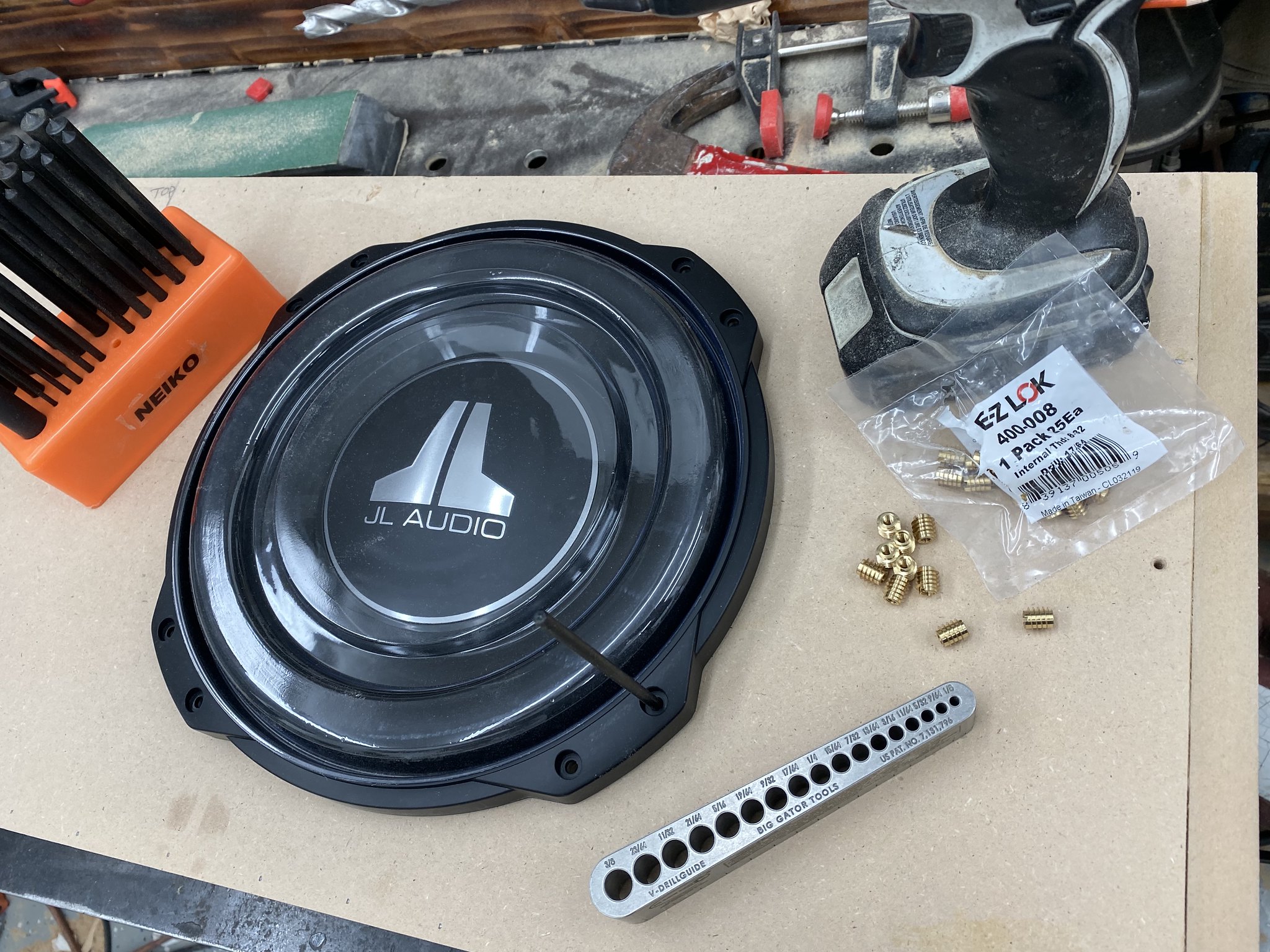

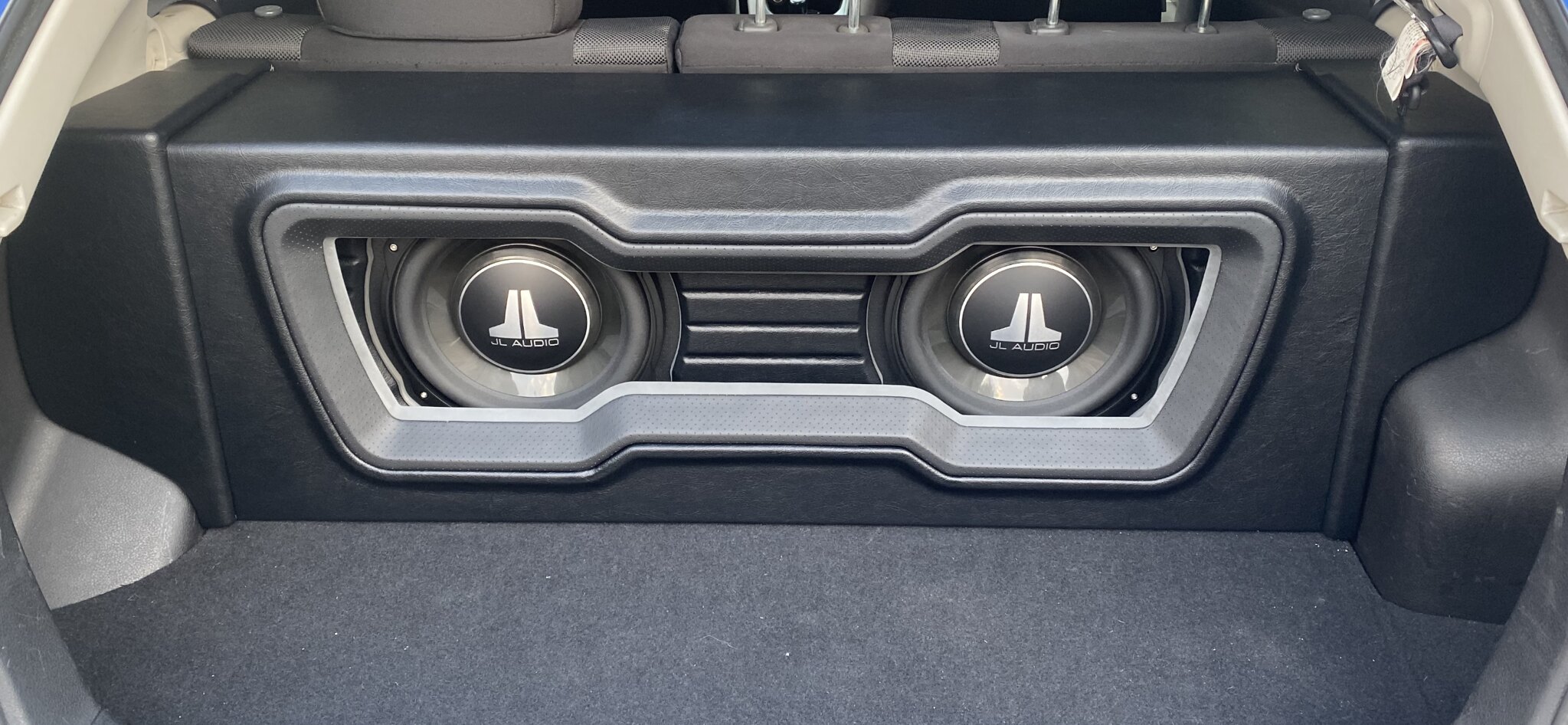

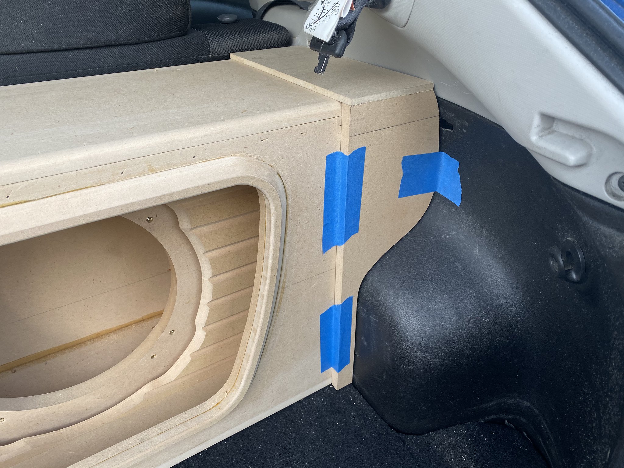

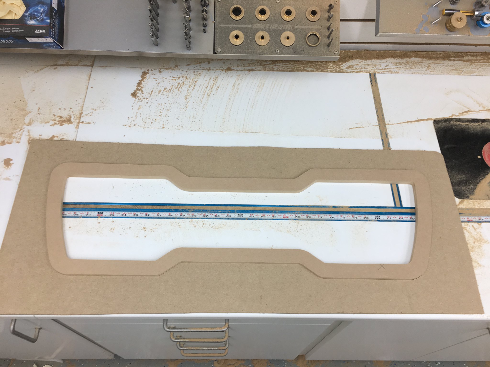

2009 WRX JL10TW3's JL RD 1000/1
Outstanding work! Very clean. Well done sir.

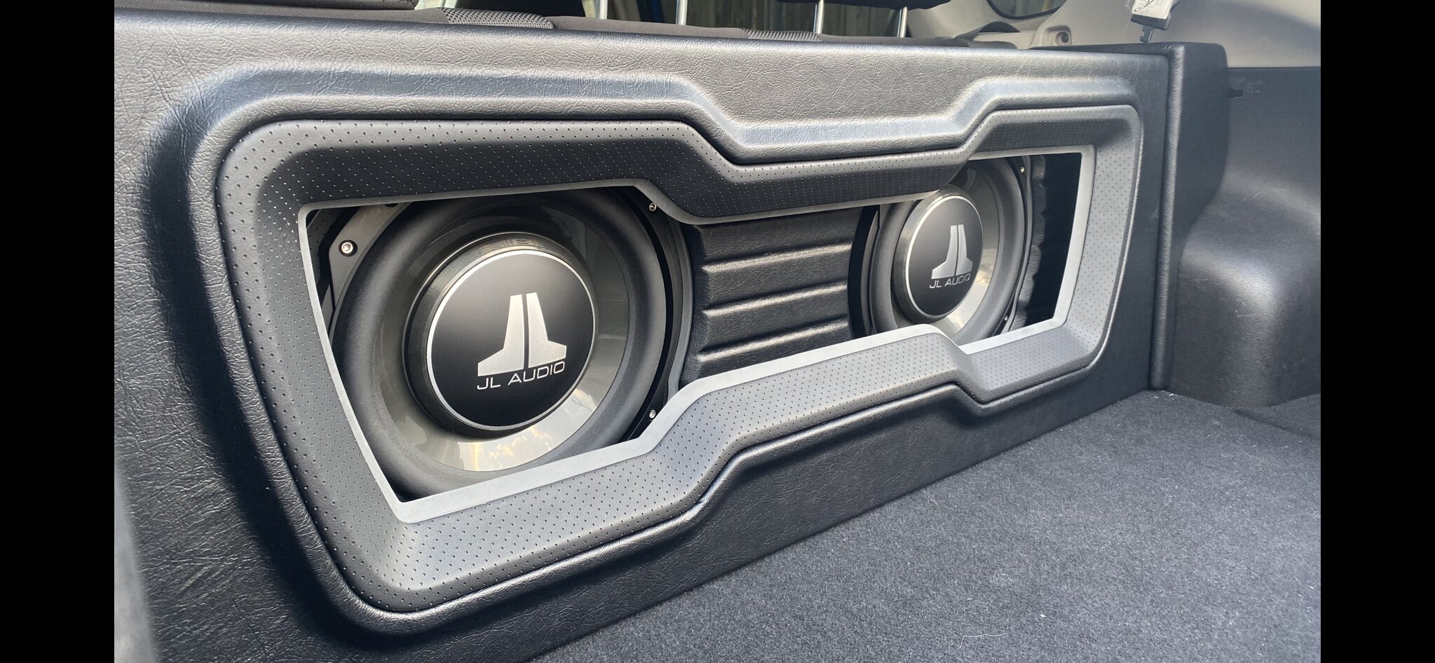

What are your thoughts on the 10tw3’s? What size enclosure did you go with? I’m considering a pair for an upcoming build. Thanks!
Thank you

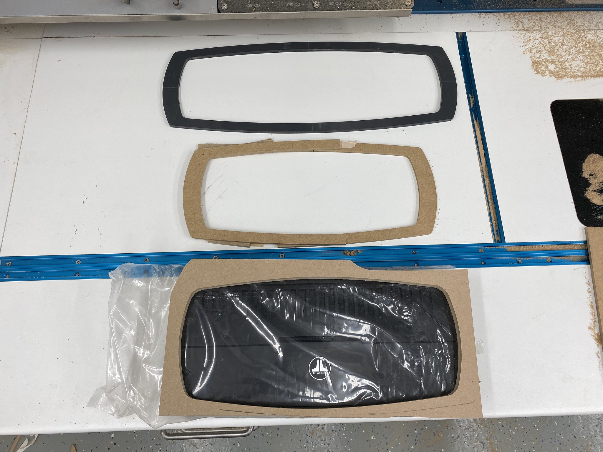

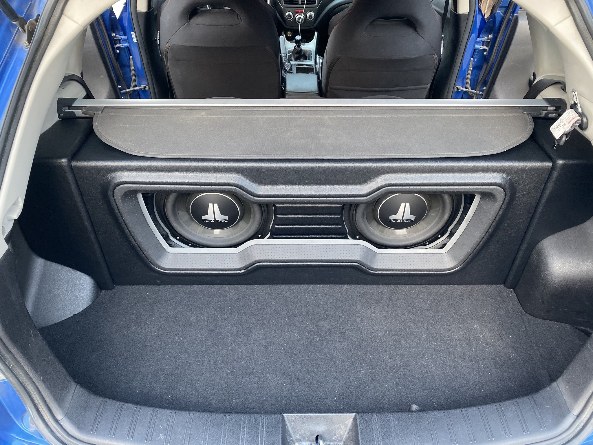

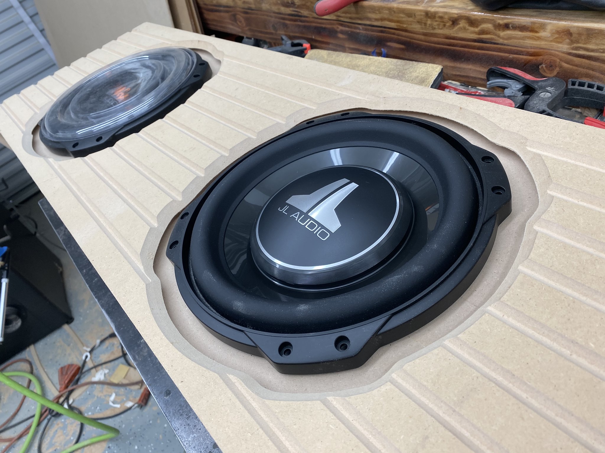

I went with sealed to JL's specs @.57cuft per woofer. They sound so clean, I love them. This is the 2nd install used them in. When I redo the system in my daily I will be using them.

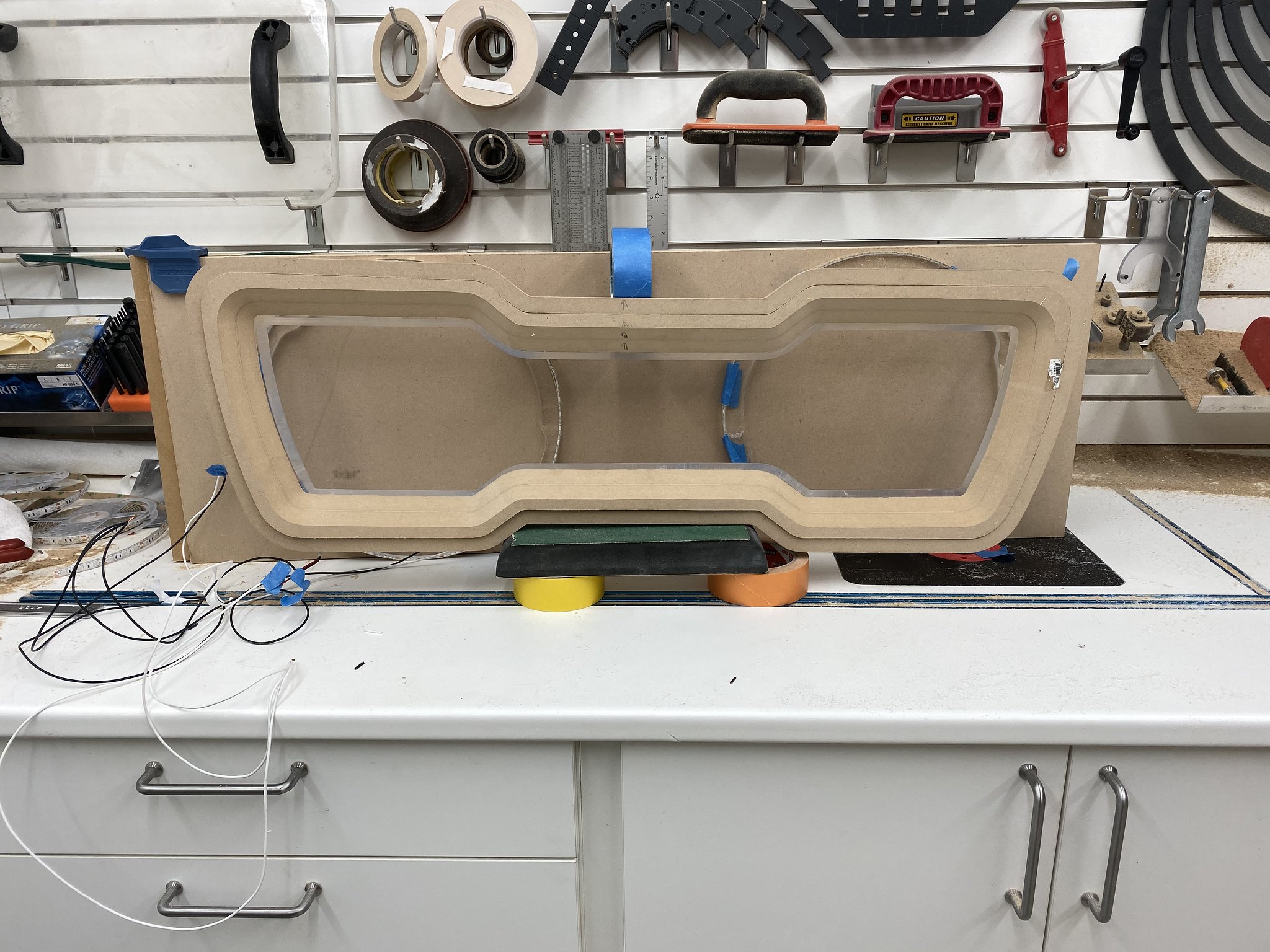

Looks like the shop from caraudiofabrication?
Yep, that's where I got the idea from
