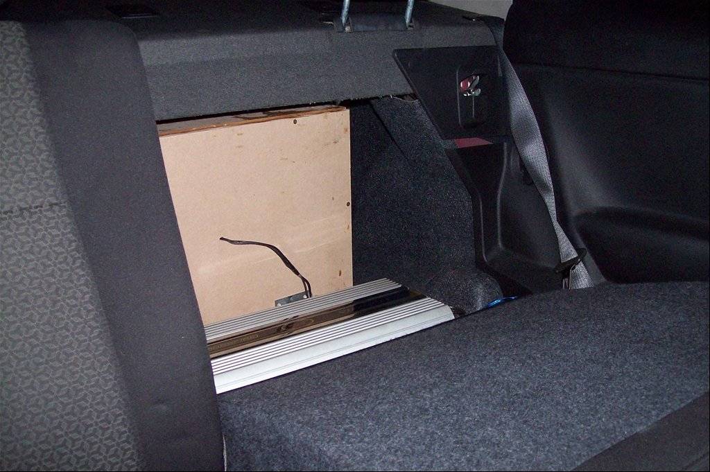

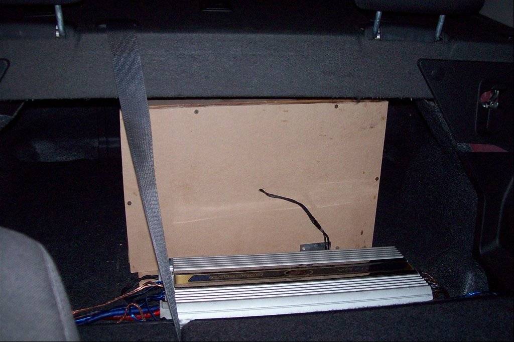

As far as overall sound, I love the components of my setup. I need a bigger ported box to get a bit more output out of the idmax since its getting under 300rms. The tweeters may need to be moved up on the A-pillar to raise my stage a little bit. I wouldnt mind sending more power to my mids and sub, but I'm pretty happy with the sound and don't think I need to make it louder just because it only does damage after what I have.

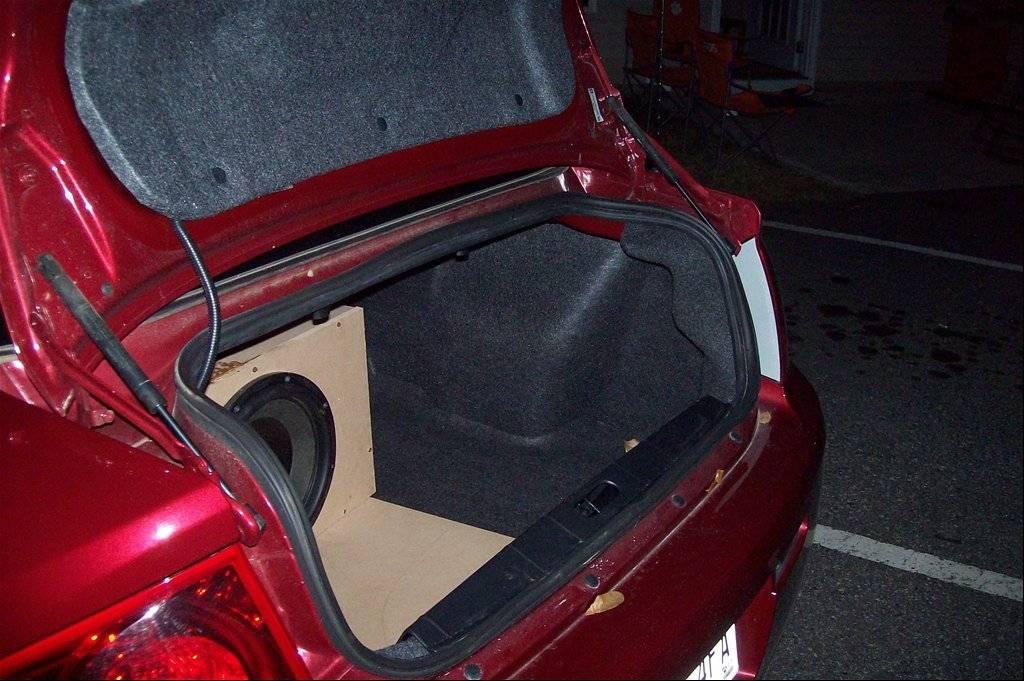

lookin good, does it crush the lows? I wanna do a nice single sub system
There is an overall flat frequency response with this box/amp/sub. With under 300rms going to the max in one of the smallest recommended enclosures, its not to heart rattling. I am not really into loud bass. I prefer a loud front stage with the sub as an accent to the bass. I am happy with the blend that I get and like I said the response is good enough that the lower 30hz tones have a very similar output to the 60hzs range. I just threw that box together before I came to school and havent had the time to get back and build a better trunk. I plan on doing ~2.5cuft @ 28hz or so and will most likely build it so that it is walled off from the trunk and sealed firing into the cabin.

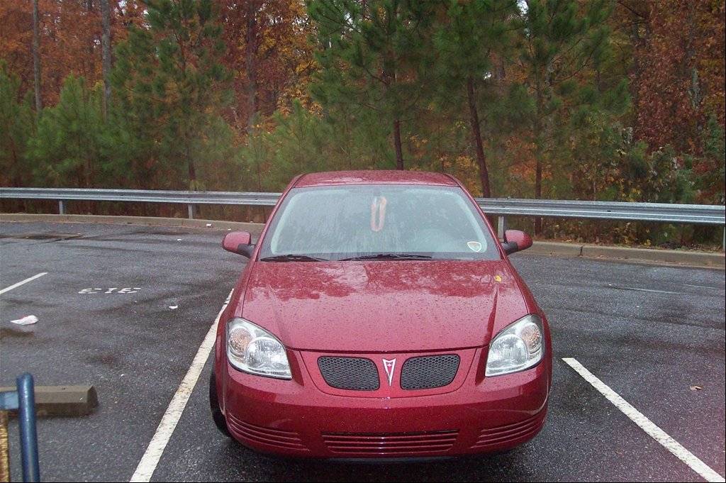

I'm not a big fan on the large gap between the hood and the front bumper

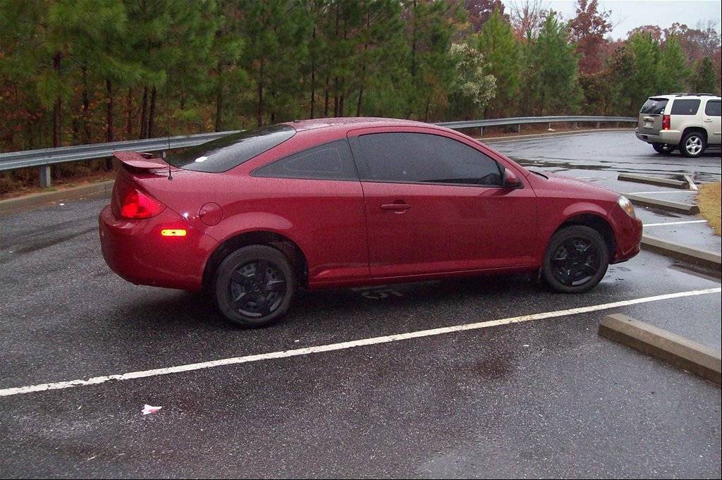

I would prefer to find some cheap real black rims

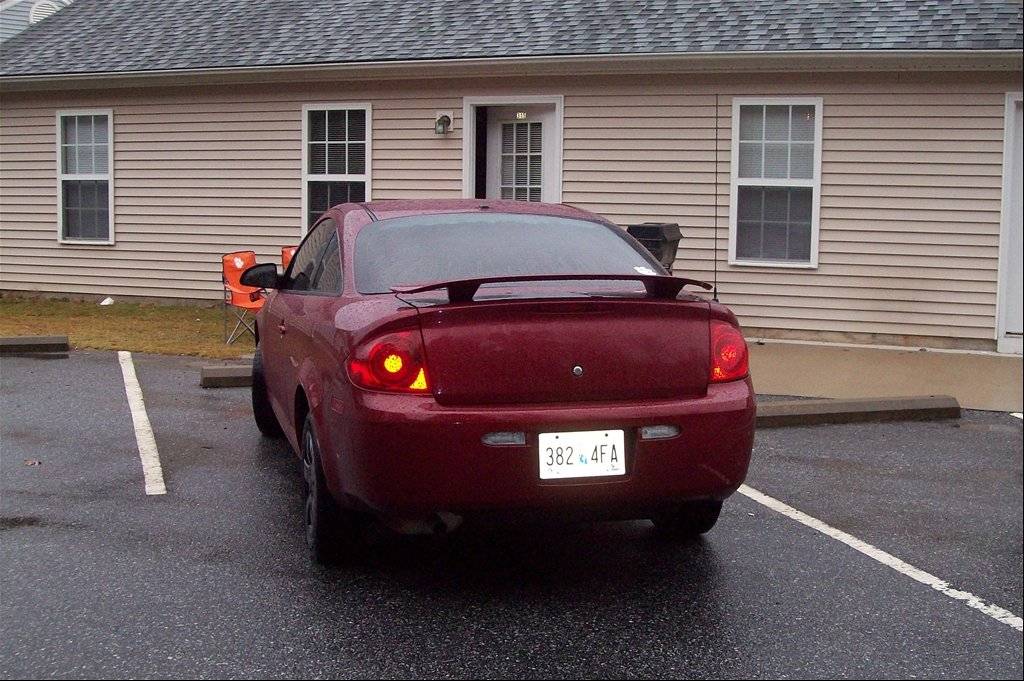

Thinking about throwing a light tint on the tails to help them match the paint a bit better

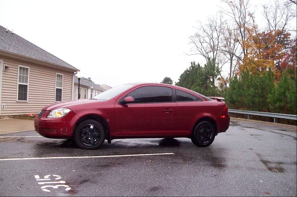

Thinking taking away some of the wheel gap would make it look slick.

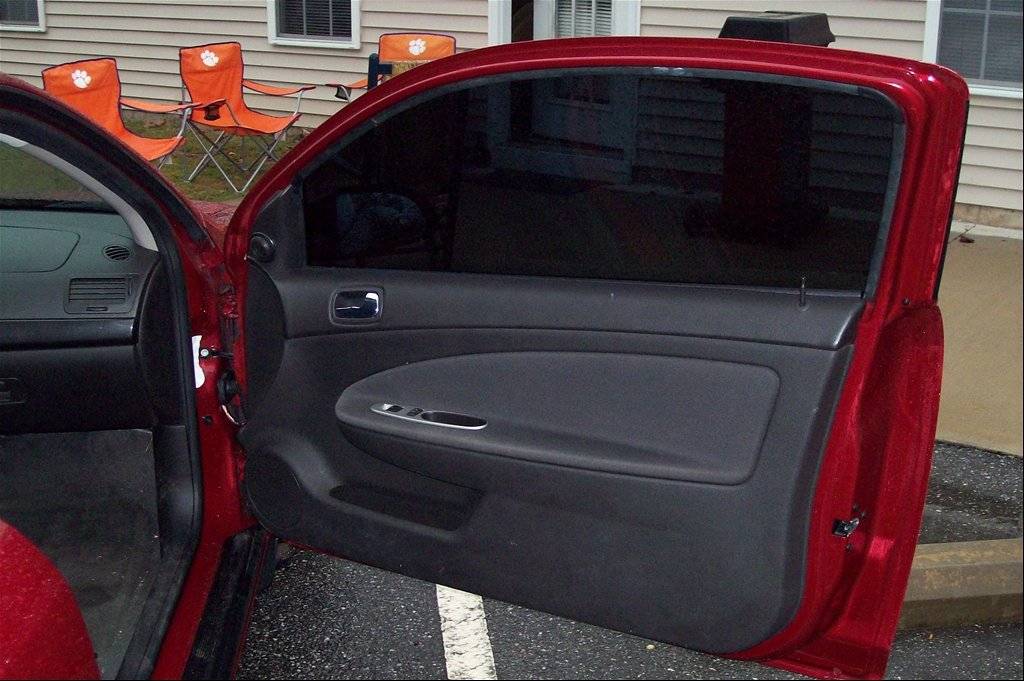

Doors look pretty factory. You can see my questionable tweet location. (Think it needs to be a bit higher)

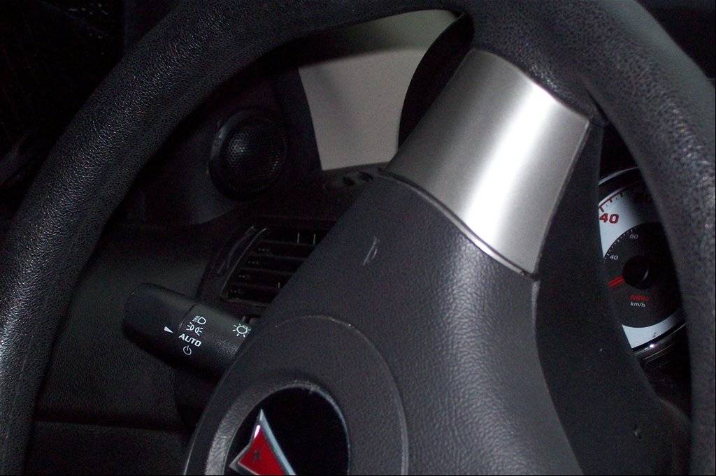

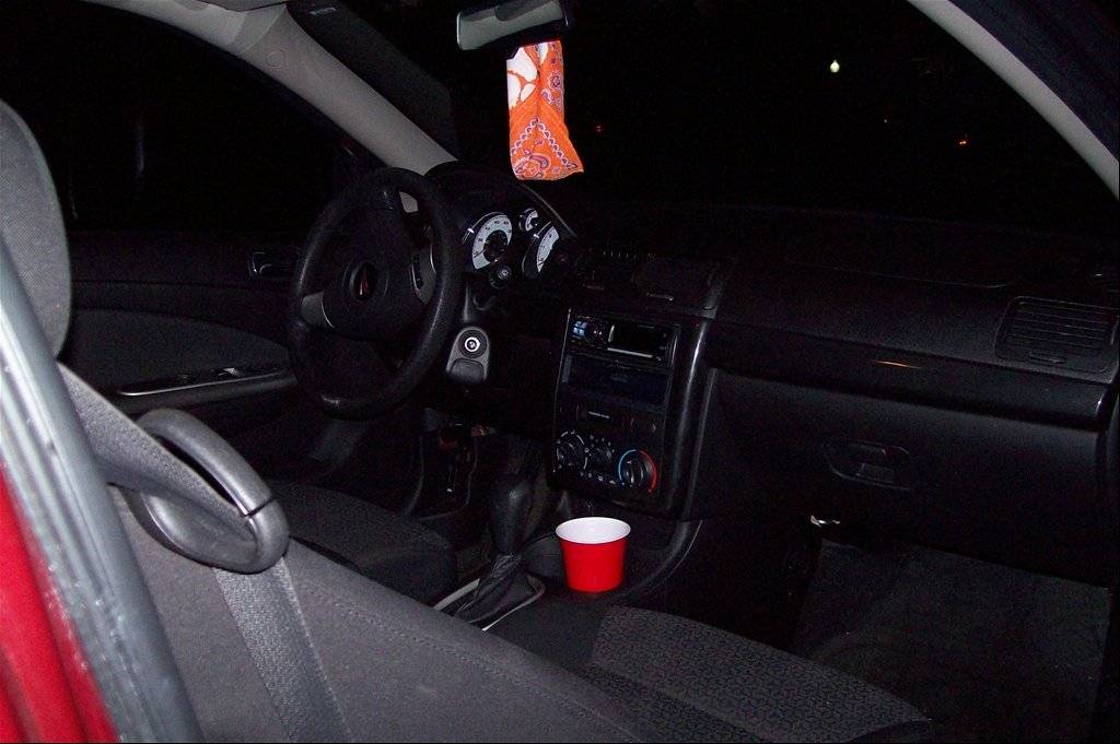

Trying to show that the tweet kind of points directly to my cluster hump.... needs to be moved along with the other one, right?

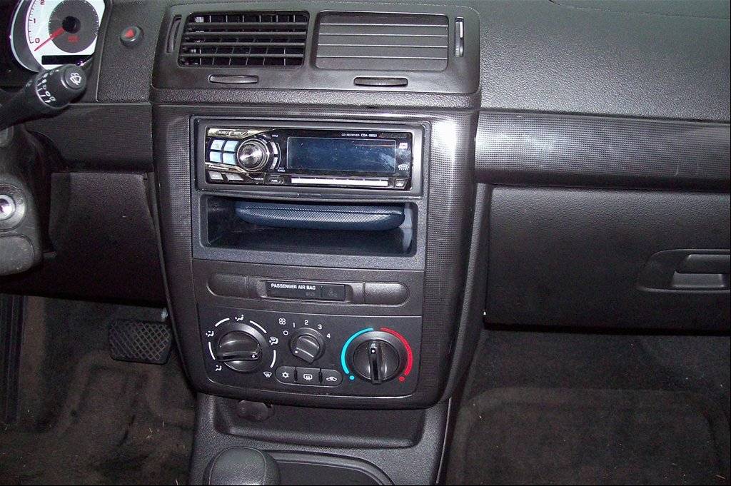

Good lookin old skool HU...gotta love em.
what's up with those tiny *** wheels/tires?
how it came and I dont have money to get bigger wheels/tires. I put a little caption under one of the pics saying I would like to get actual alloys or w/e materials black rims. I think all black with a red accent, somewhat deep lip would look slick. I would probably only do 18"s at the max.
