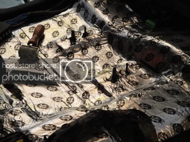

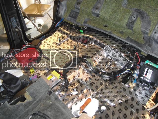

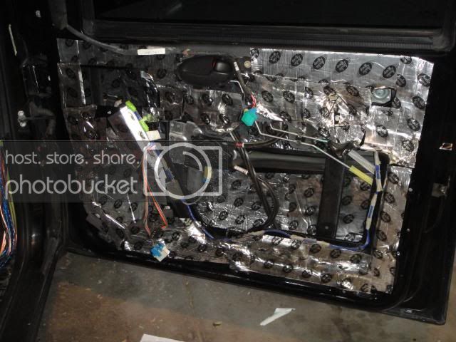

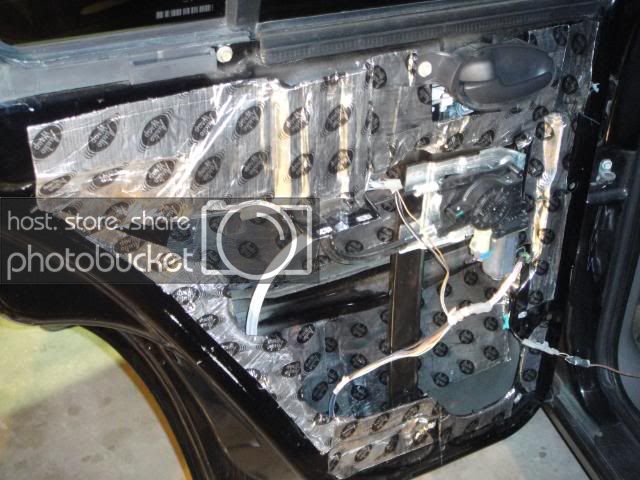

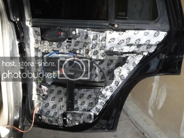

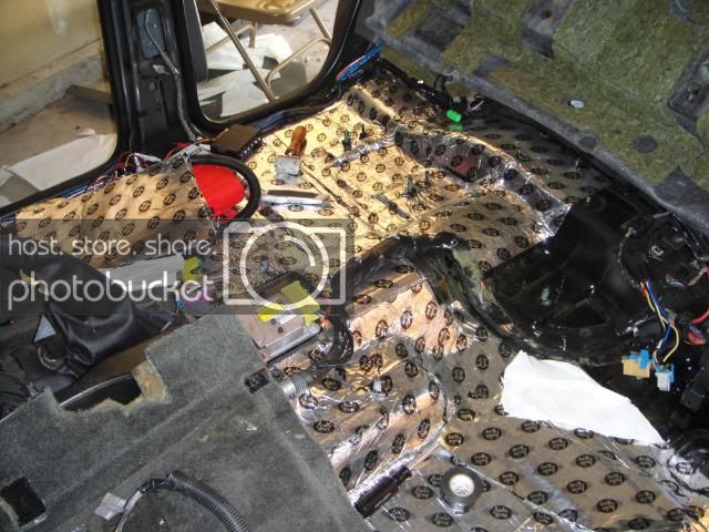

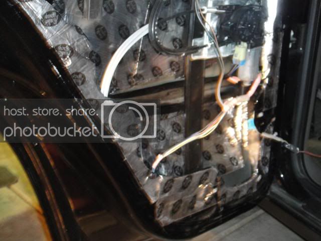

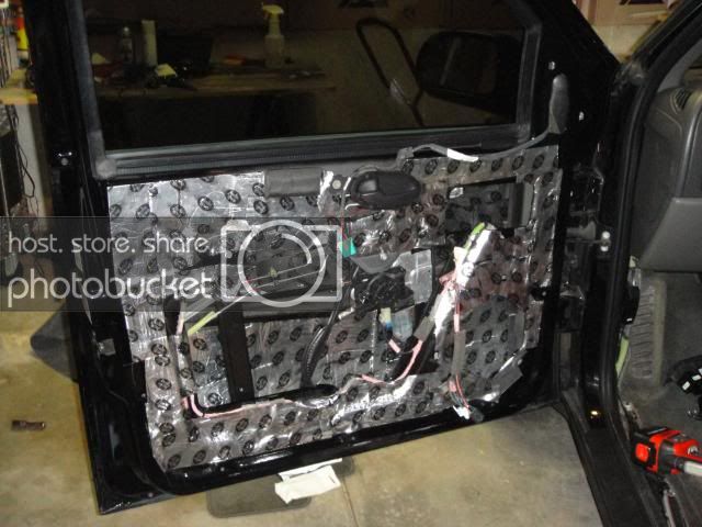

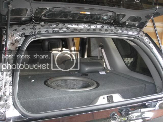

first step started with the preparation used Audio Wrap sound deadener. i did 2 layers on the floor 2 layers on the doors and 1 layer on rear hatch and plastic covering. also i have 1-2 layers on the roof along with expanding foam to make sure it was braced properly.

-12cuft net tuned to 36HZ
box design im looking at for now i know port up sub up isn't recommended but this is all i have to work with with the space i have
more to come.
