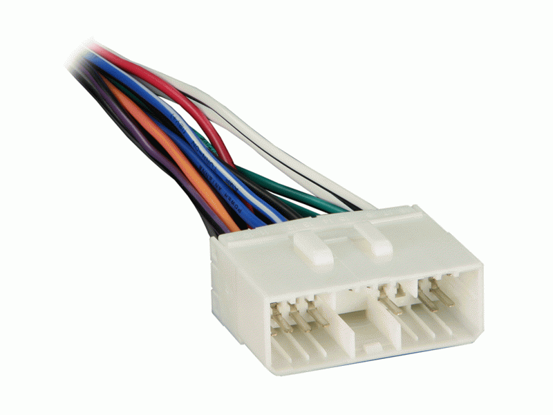

My uncle has a 2006 Chevy Aveo, bottom of the line version with only AM/FM radio, anyways he just bought a aftermarket CD player and I went to go hook it up and he need the wiring harness to hook up to the old white plastic clip so I can tie in the new CD player, I went to walmart and they didnt have anything so I called BestBuy and the guy told me it was around $100 for it.. I never heard of them being that much, usally $8-$20 or whatever, So I asked him why are they so much and he said everything is tied into it including fuel injectors, airbags, etc.. So my question is this all true? Is the only stereo wiring harness available over $100? Because that sounds nutts to me.. I appreciate the help..
They are ripping you, which is no surprise. The best kits model # is: BHA7200 looks like this:
And the model number for the metra harness is: 70-8405 and this is what it looks like:
