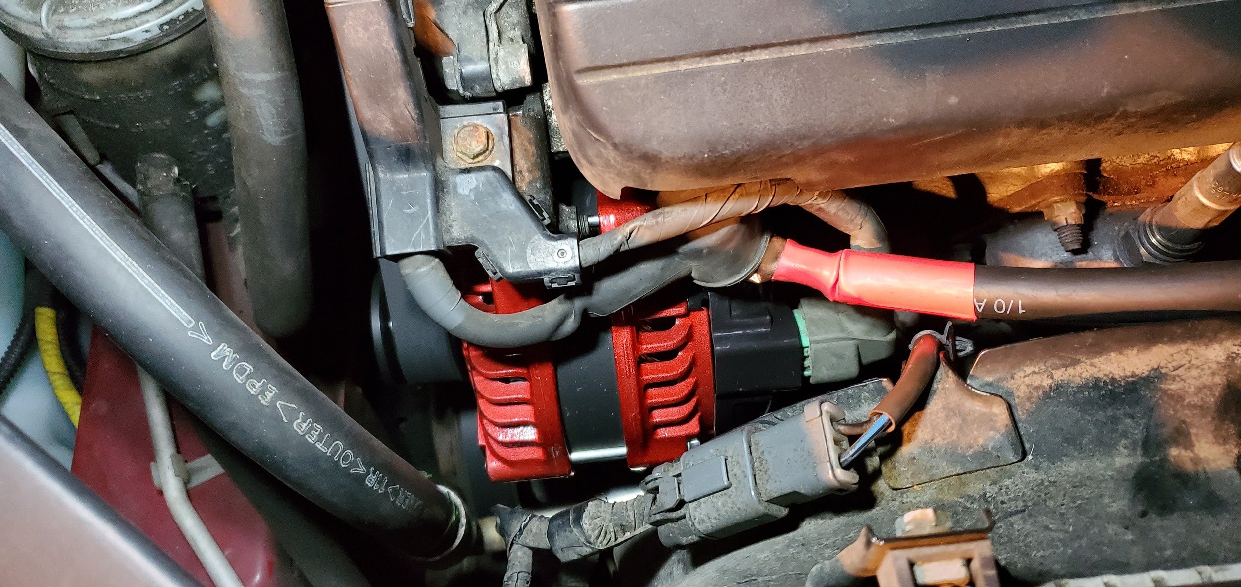

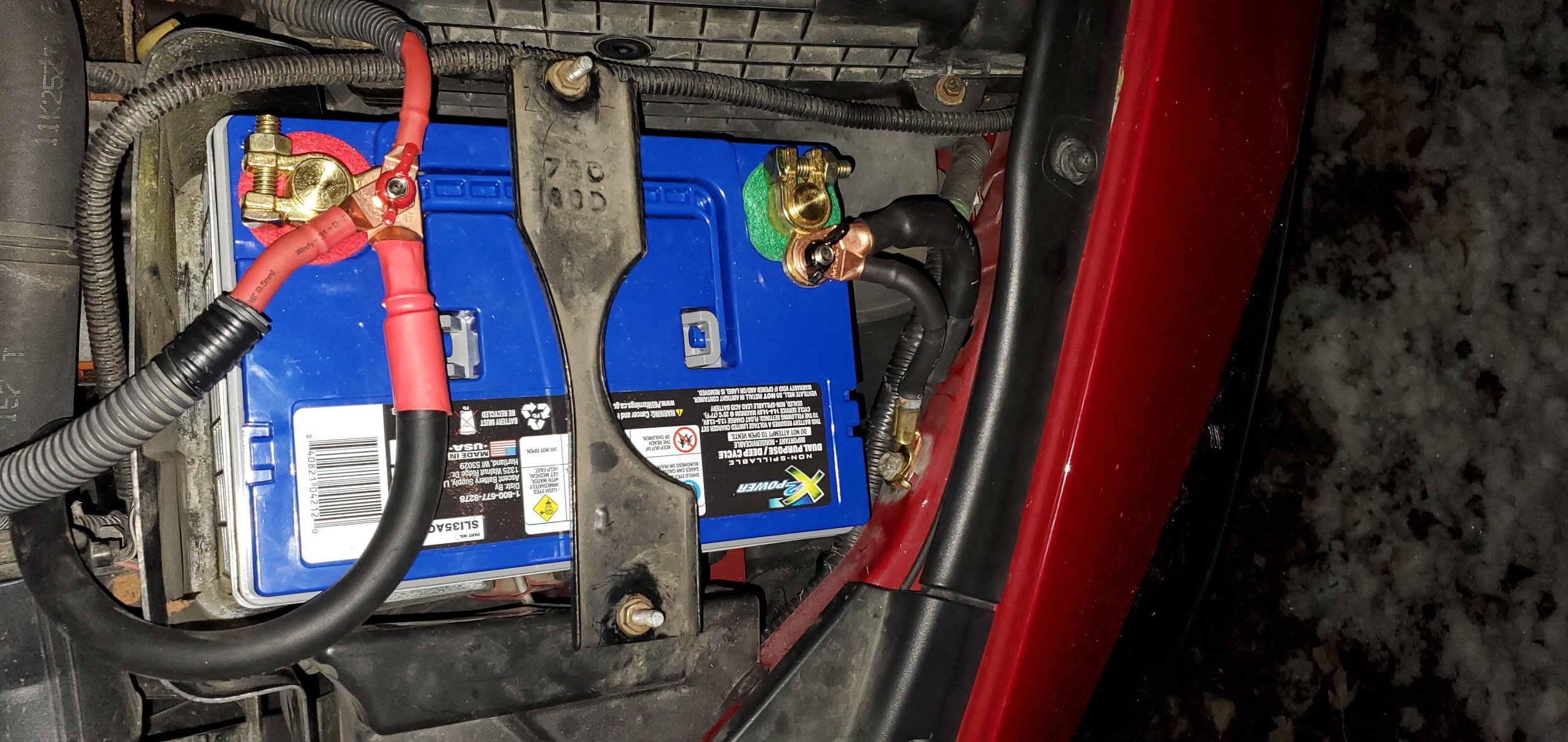

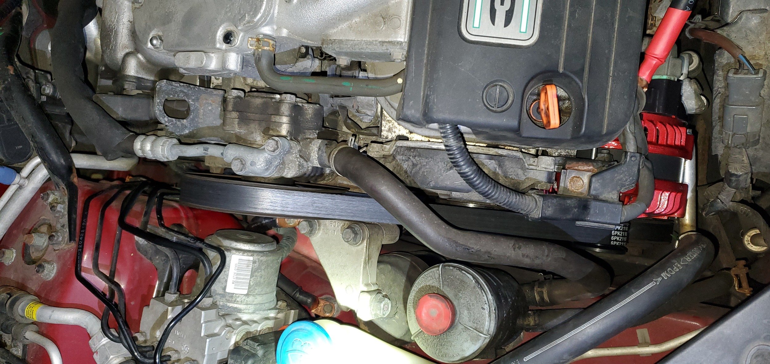

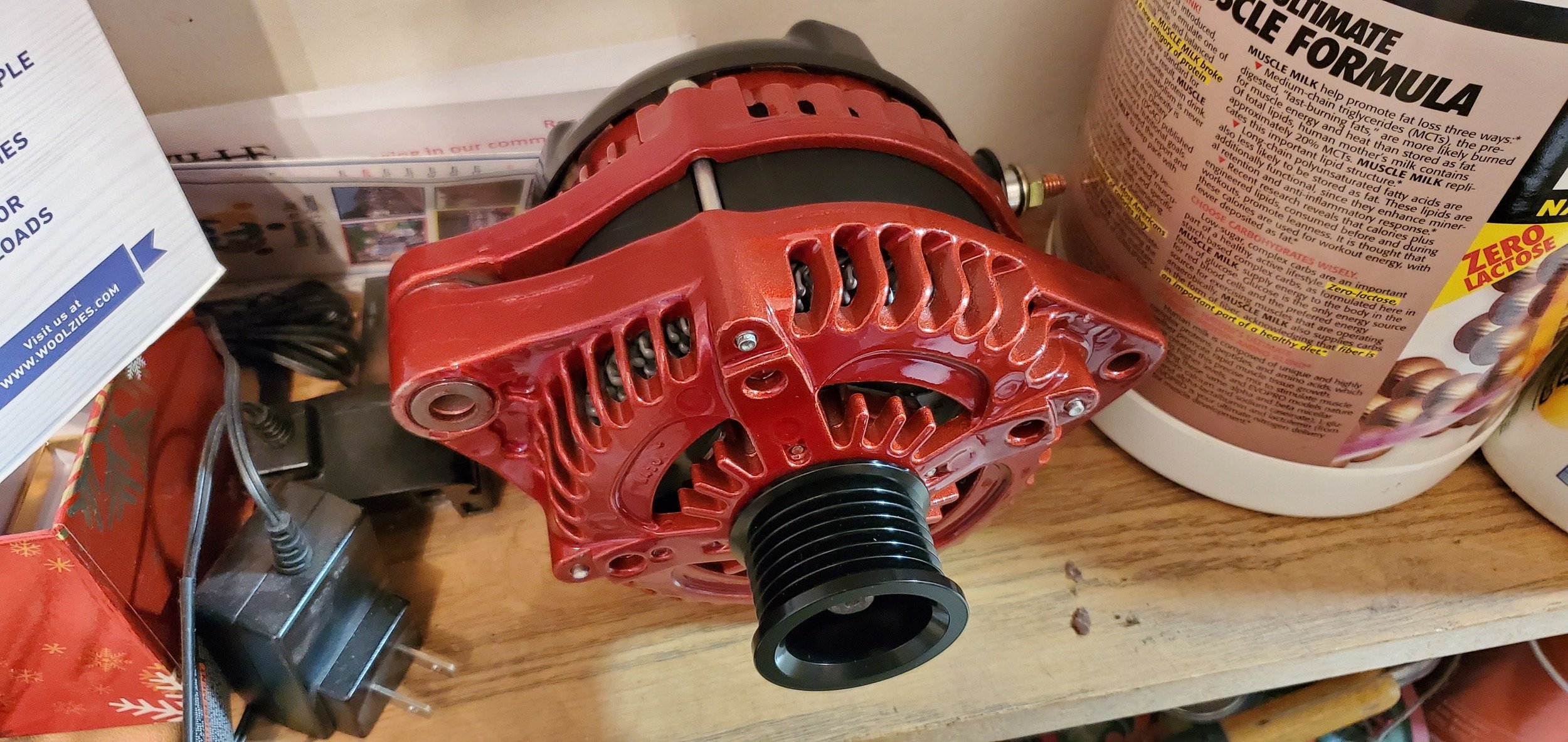

New serpentine belt 1 inch shorter as needed for tge HO alternator with smaller pulley. 1/0 cable engine to chasis, ho alt to battery + and battery - to chasis. Chassis wire brushed to shiny bare metal grounds.
