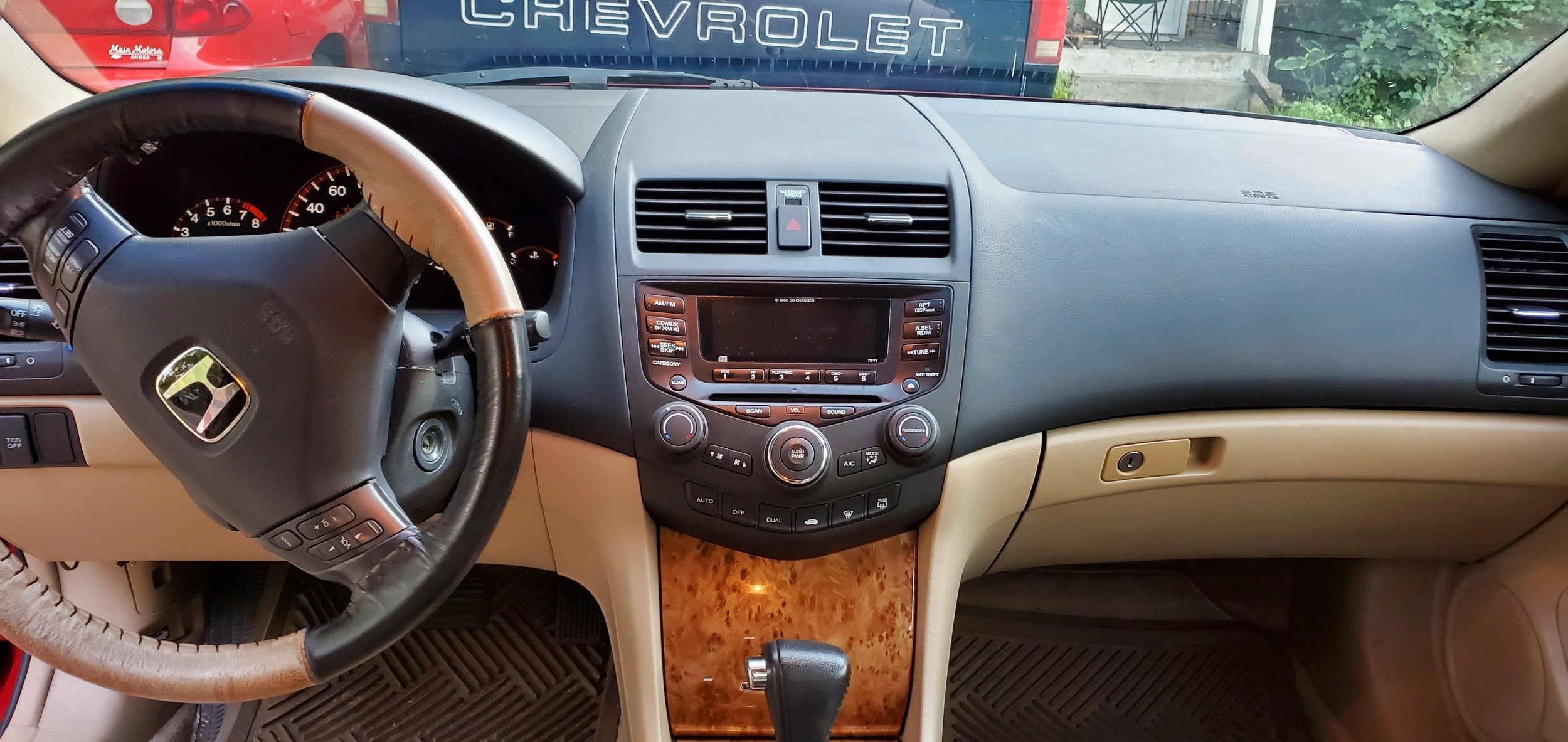

It will be fine. One day later if my bank account feels more love i'll spend $430 on the dash mounting/wiring harness required to use an aftermarket HU and spend another 430$ on a double din. But for now I'm on a budget, and i dont really like the lloks of that kit, my model has wood trim that is nice looking that the kit replaces with plastic and gaps. Also not crazy about the controls on the kits for the HVAC.
I could look into a dsp, sorry i'm not familiar with the term, but a flatter eq sounds beneficial. Any budget suggestions on models?
Actually found a dashkit for $300 that says it has the module for steering and hvac controls and doesn't replace the lower wood trim. So i returned the line out converter and aux input for doing things through the factory hu. Now if that kit works i'll be using my Eclipse CD7100 head unit for the signal. Thanks for the push.

Thanks for the great tips and information, but I think you were right the first time. I'll wait to get a double Din later but have an Eclipse CD7100 radio and found a dash kit with steering control integration and HVAC for $300 so assuming that works out I'll be running my eclipse head unit.

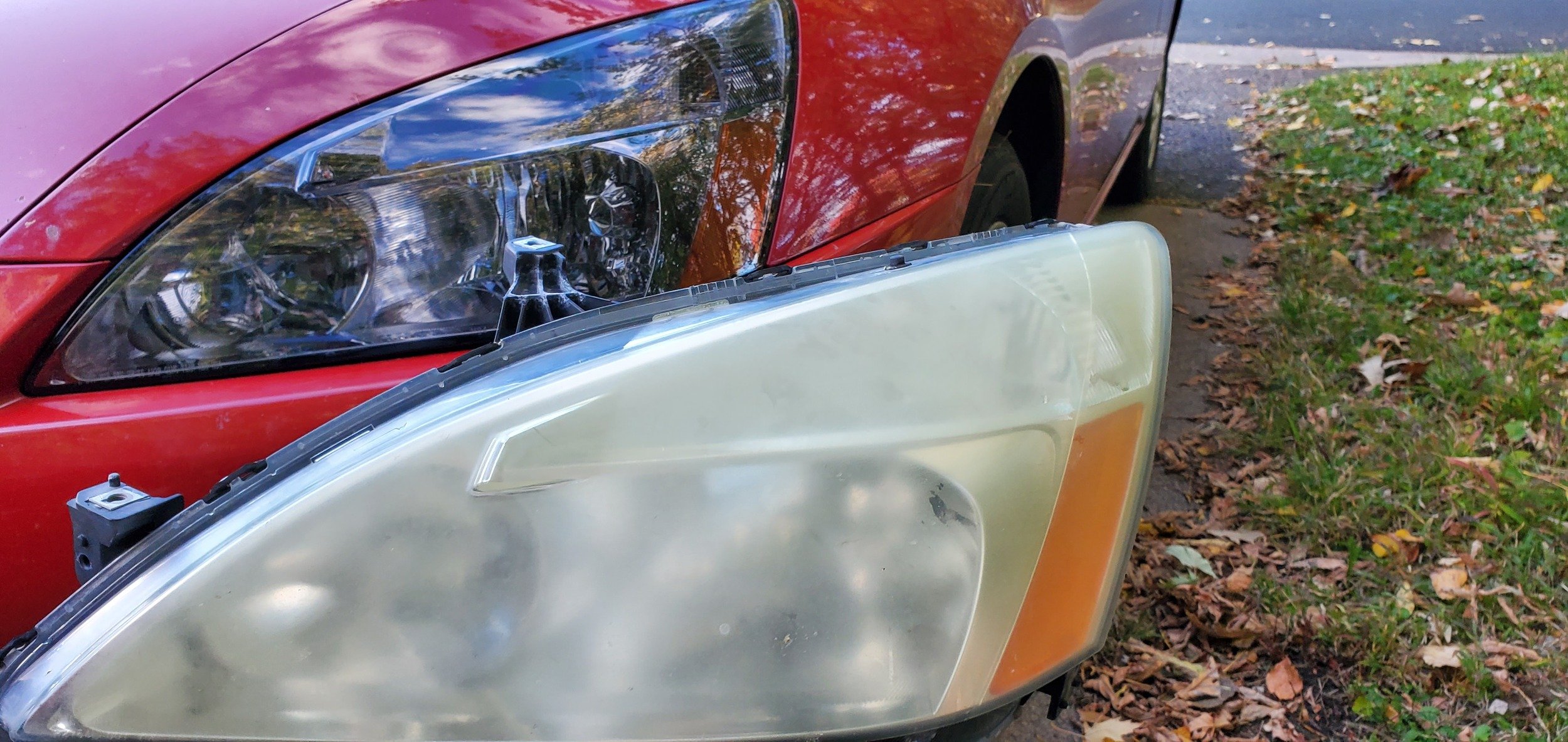

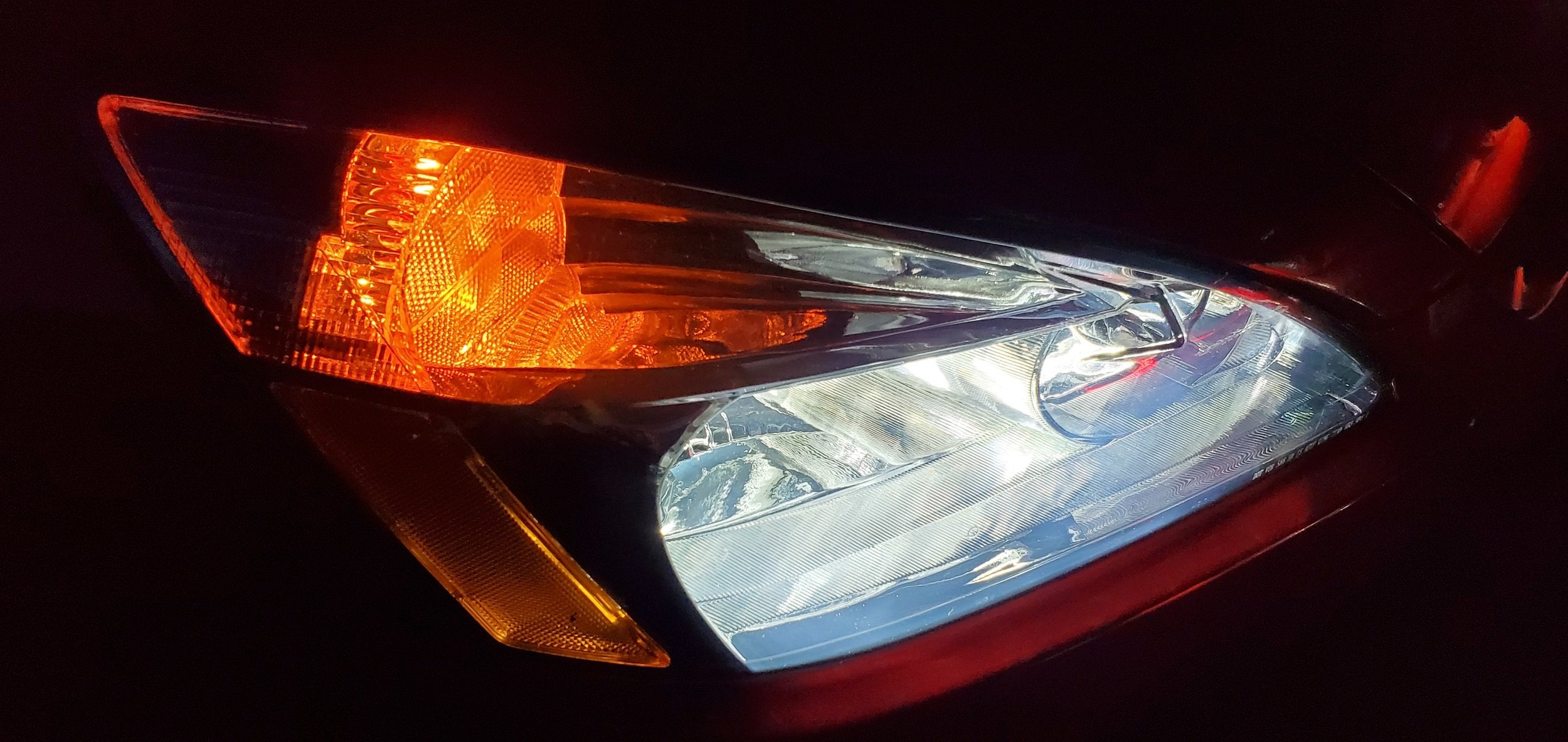

I got everything except the ho alternator seems to be taking a while. Now I just gotta find time to get r done. I got new smoked headlight assemblies and led bulbs. Put it in today looks 100 better I'll post pics.
