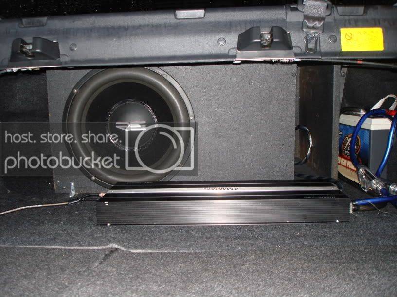

I ended up mounting the Crunch GP3k on the box, and the amp died on my around September-October, can't remember exactly. Crappy solder joints popped from vibrations and some FET's shorted. Seems to be a common problem with certain people with GP3k's.
I've since painted the box, mounted it firing forwards, and got a Sundown 3000D to power the beast. Sub runs much cooler with the Sundown 3000D as opposed to the Crunch. I think the Crunch was sending a bit of a clipped signla. My voltage dropped a lot lower with the GP3k as well. (12.7). Now I'm dropping to 13.5.

It's pretty **** loud, the lows kinda roll off below 26-30hz, but that's box design, not the sub //content.invisioncic.com/y282845/emoticons/tongue.gif.6130eb82179565f6db8d26d6001dcd24.gif.

Yeah when I had the box like closer towards the cabin it canceled out a lot, but I pushed it all the way back to the trunk lid and it helped a HUGE amount. The low-end output is far greater with it firing forward then when it was sub/port back. I'm in it for the lows //content.invisioncic.com/y282845/emoticons/cool.gif.3bcaf8f141236c00f8044d07150e34f7.gif
