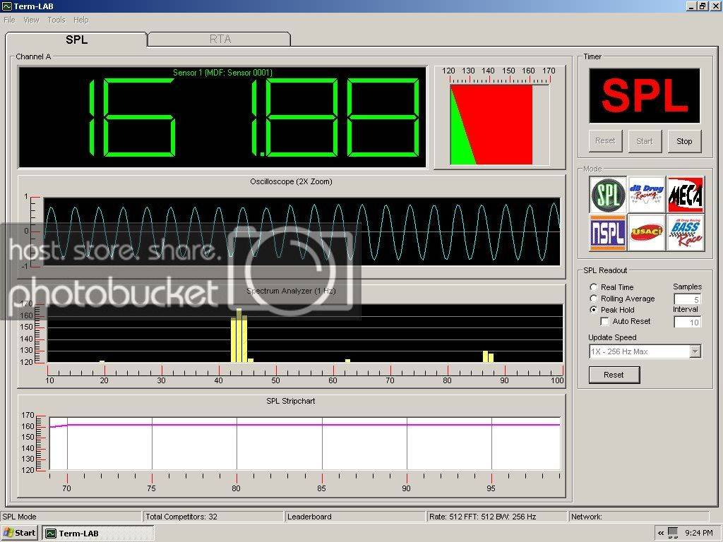

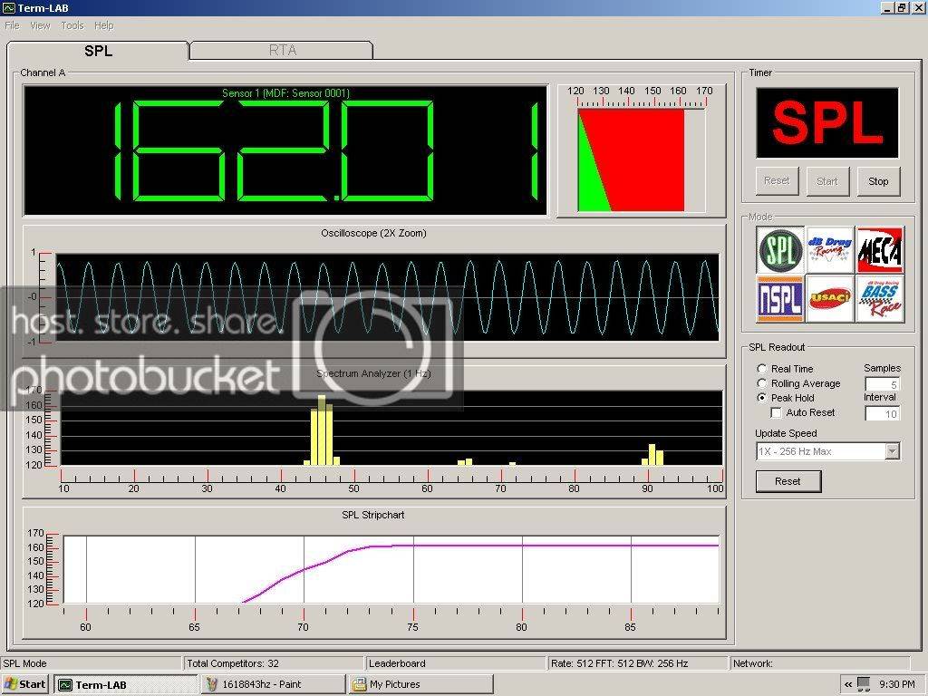

we got it figured out. here ya go check out the new scores //content.invisioncic.com/y282845/emoticons/smile.gif.1ebc41e1811405b213edfc4622c41e27.gif just started doing some burps. voltage was only dropping to like 12.7 after each burp even after doing like 6 burps
43hz
45hz
i think we got it figured out. now its time to fine tune.
