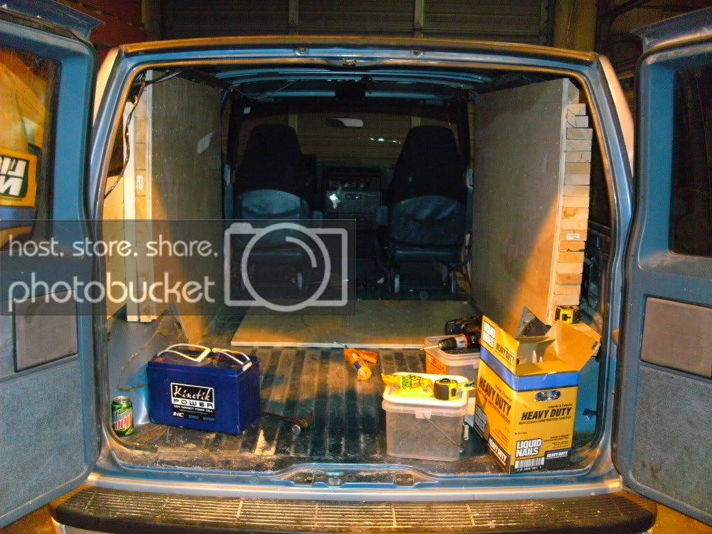

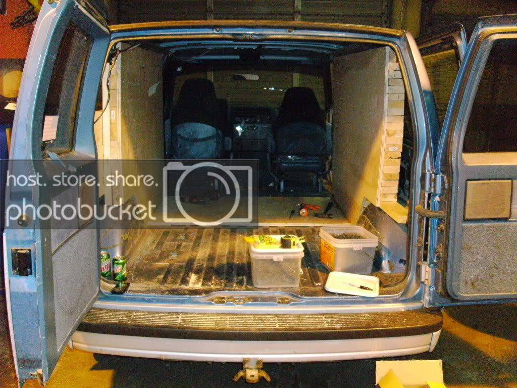

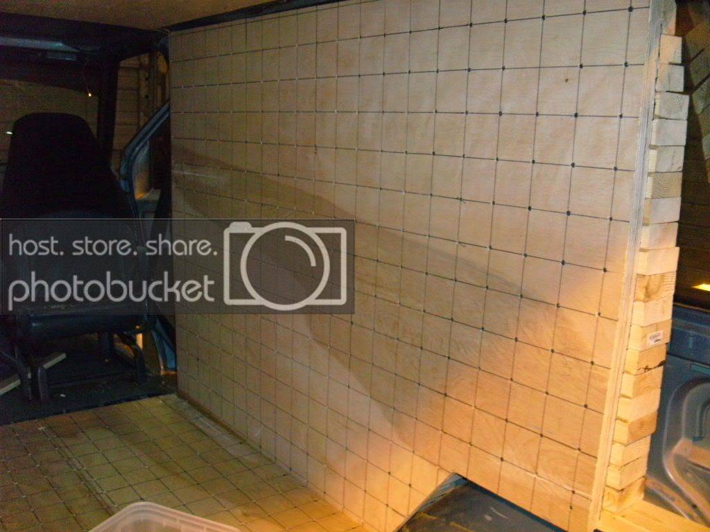

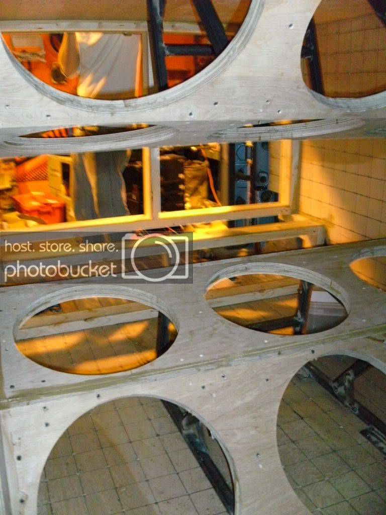

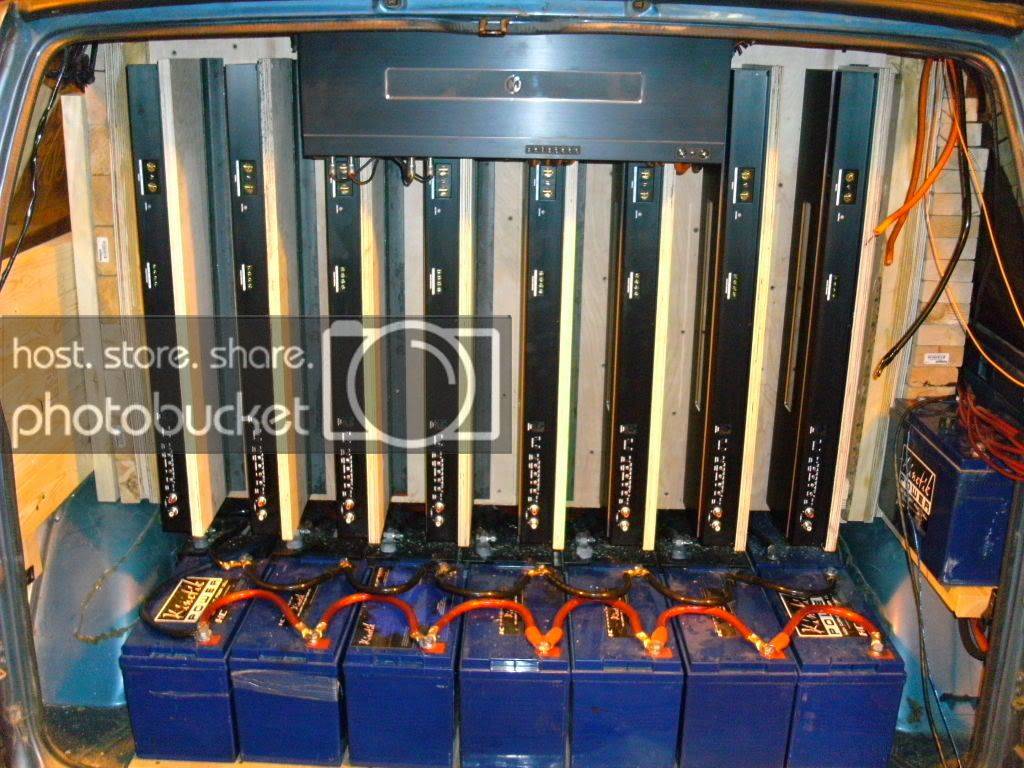

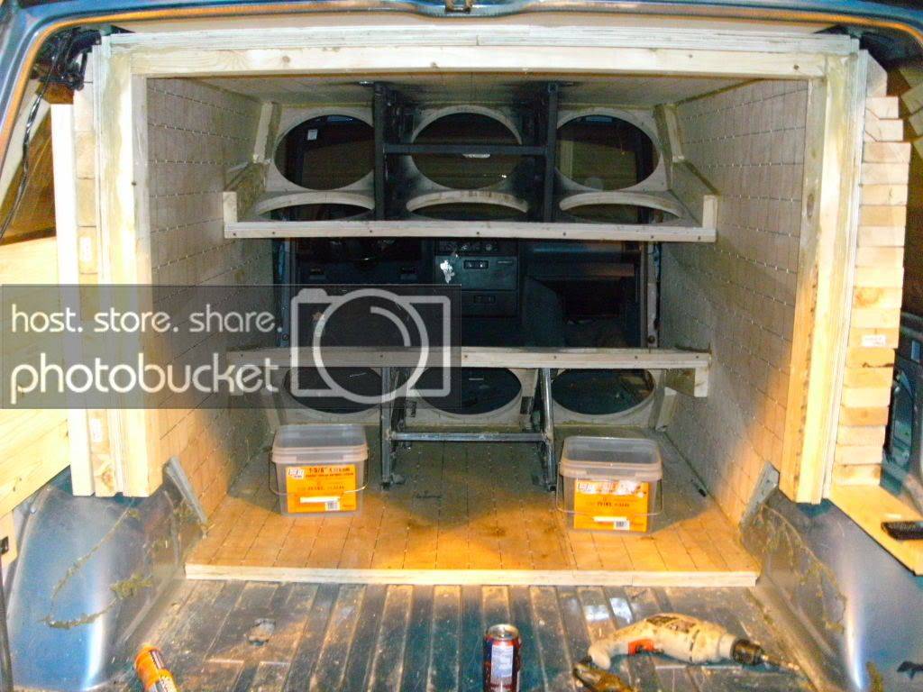

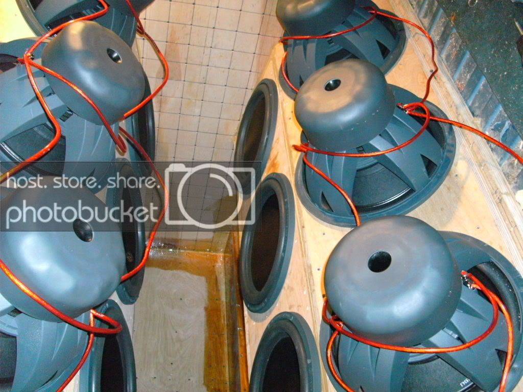

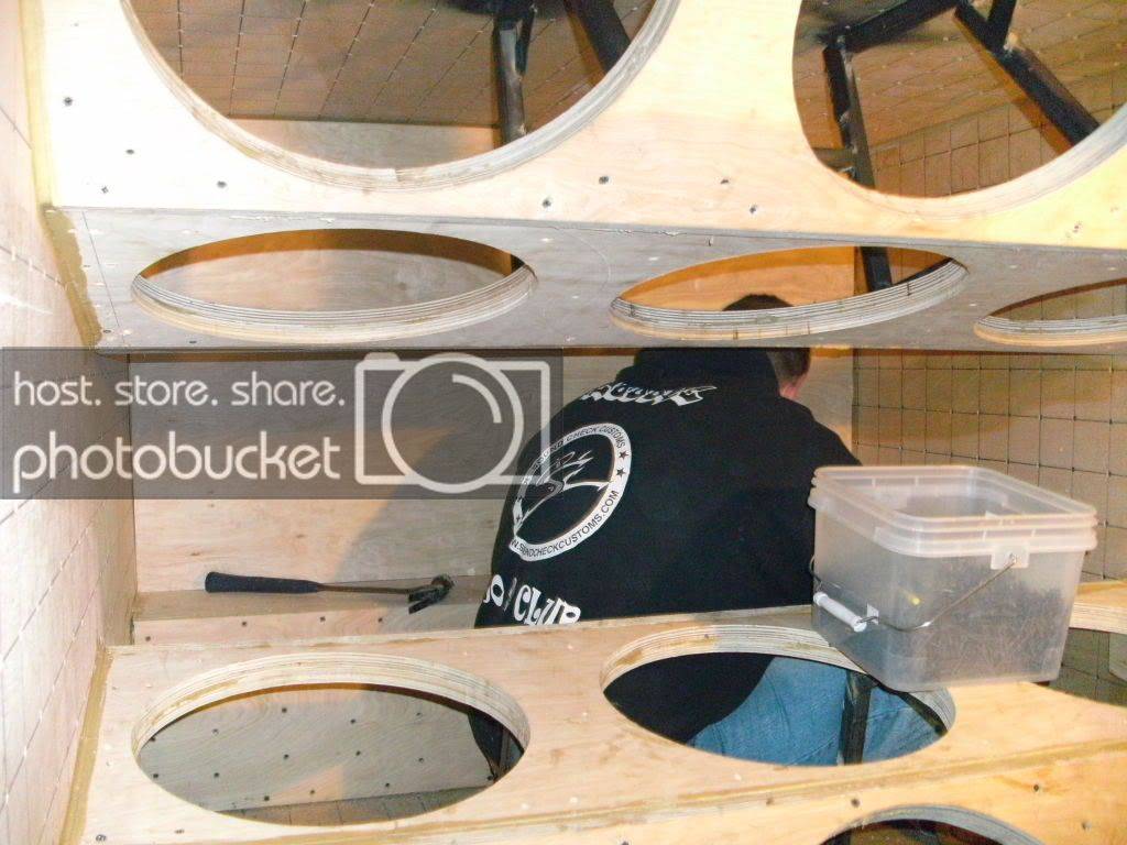

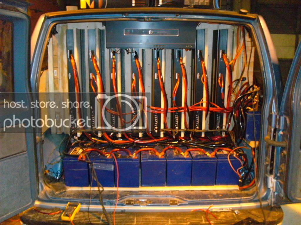

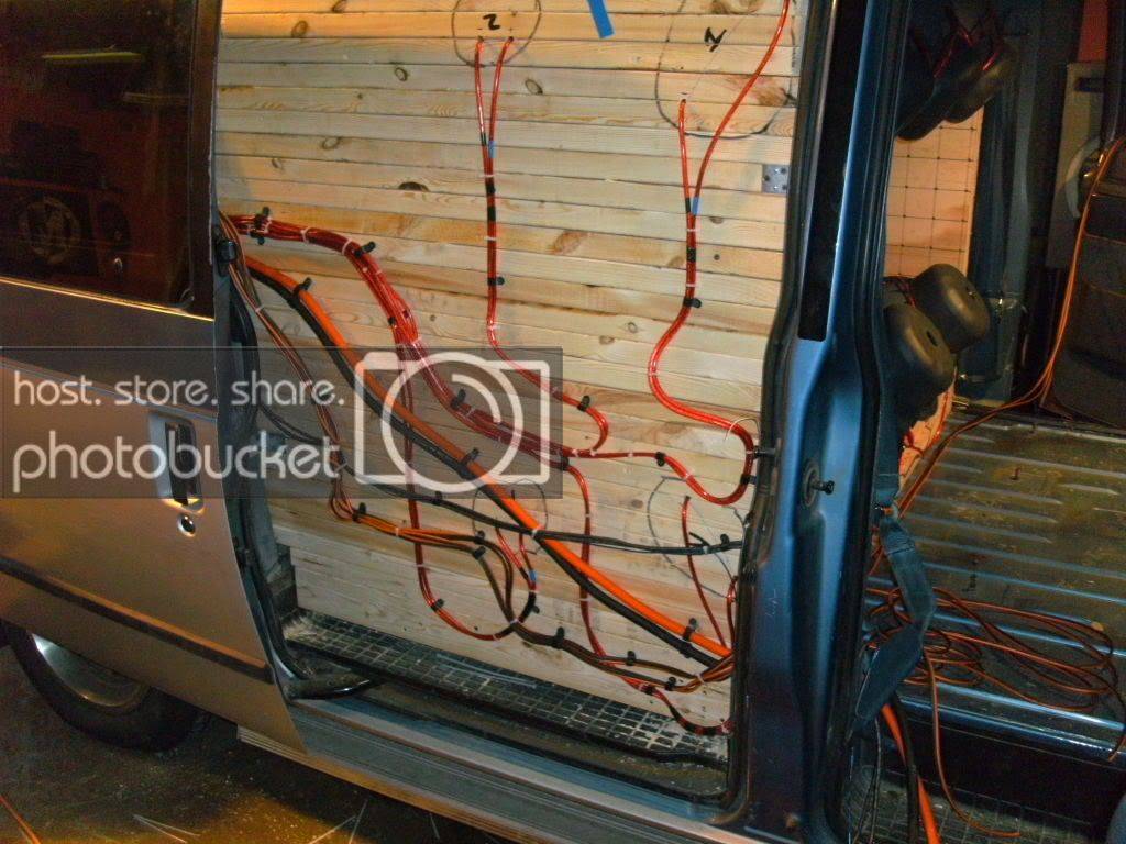

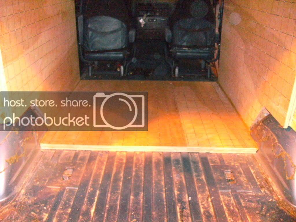

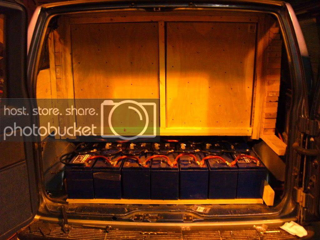

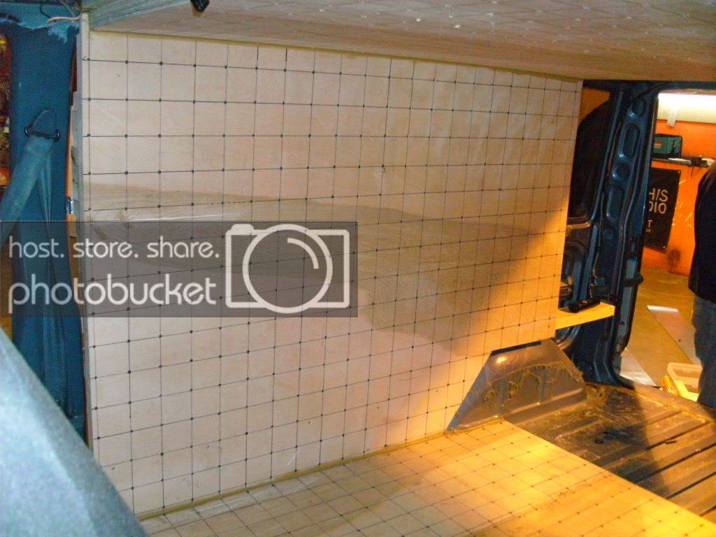

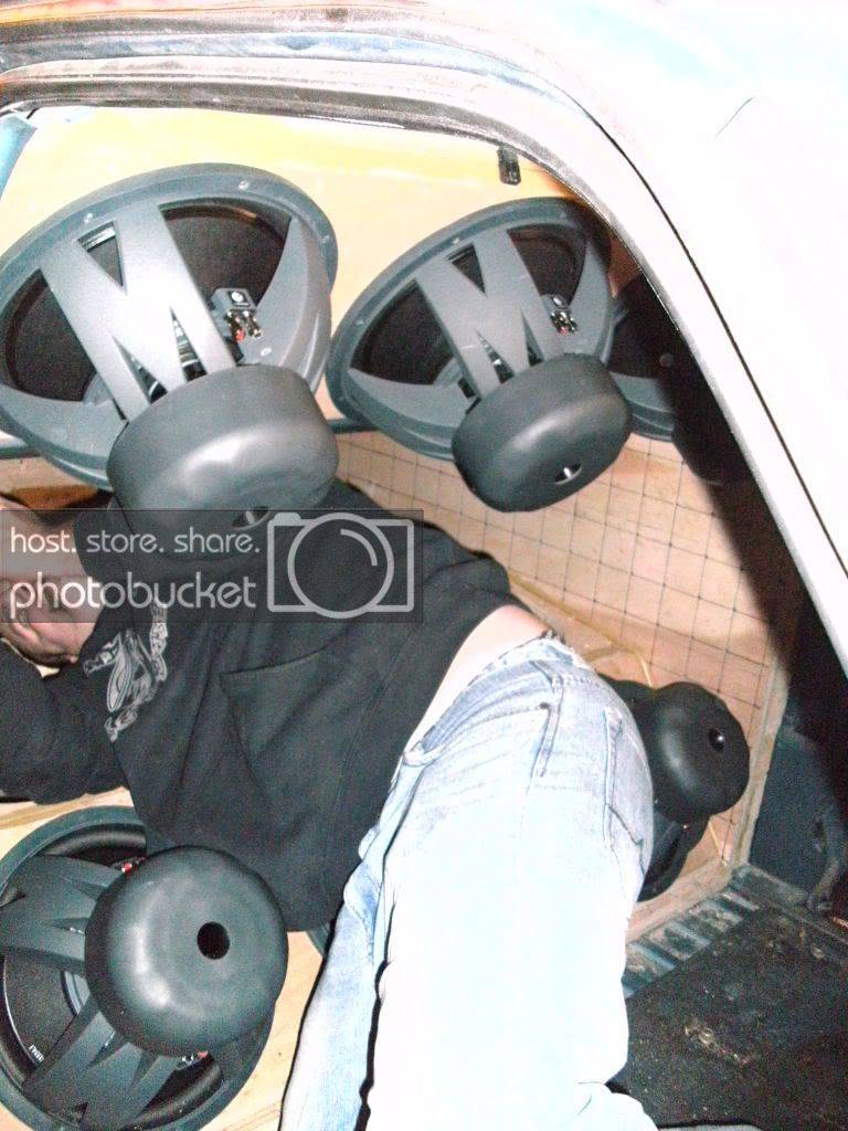

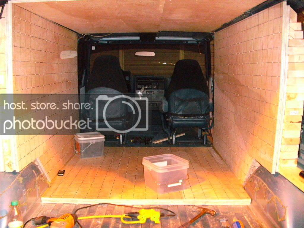

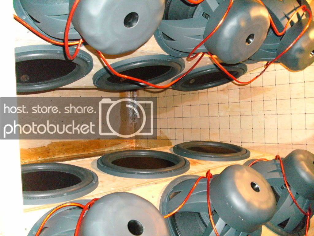

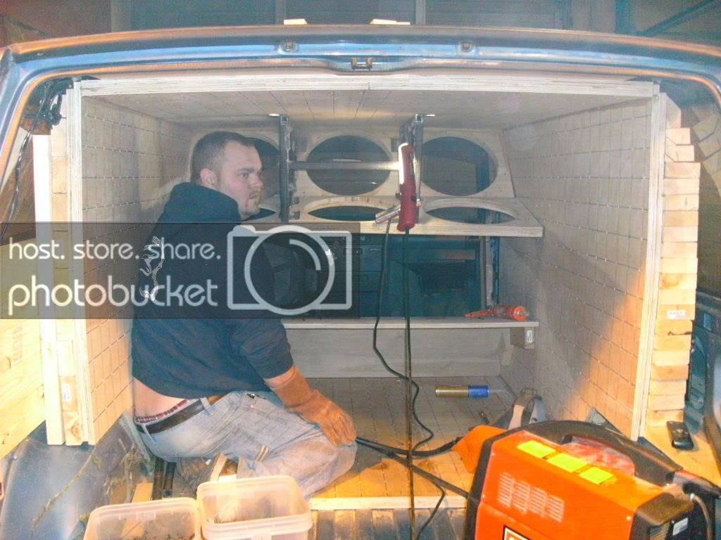

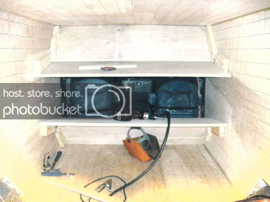

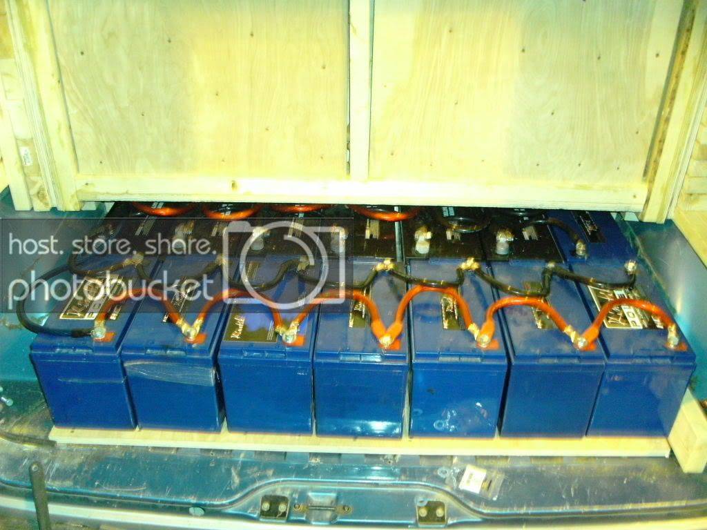

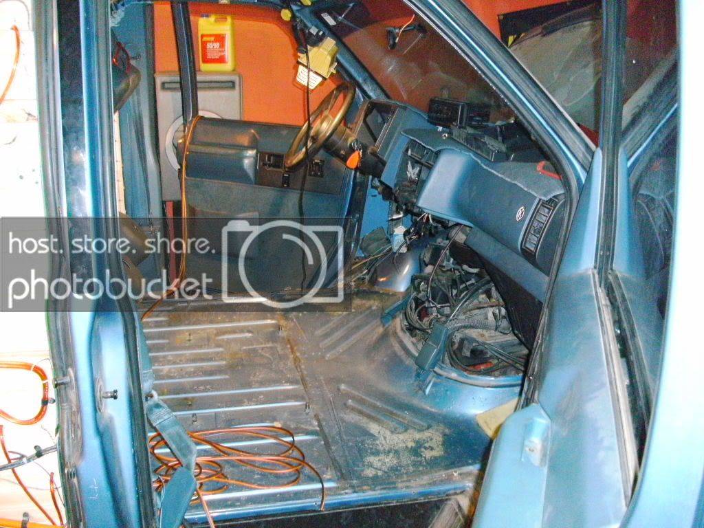

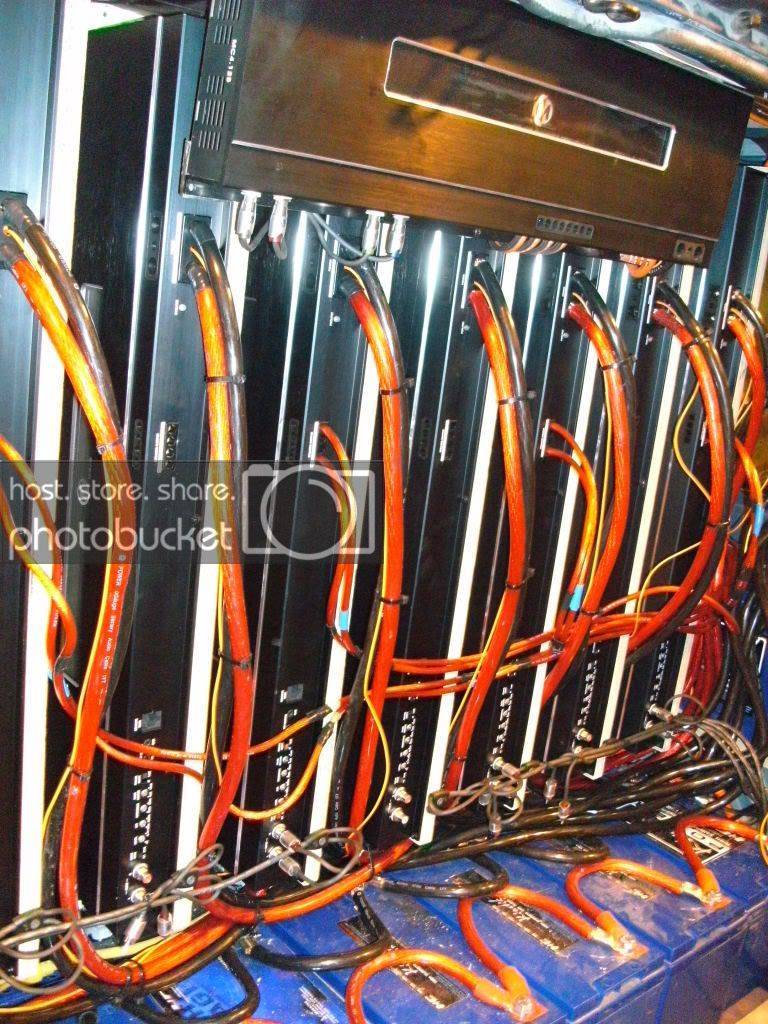

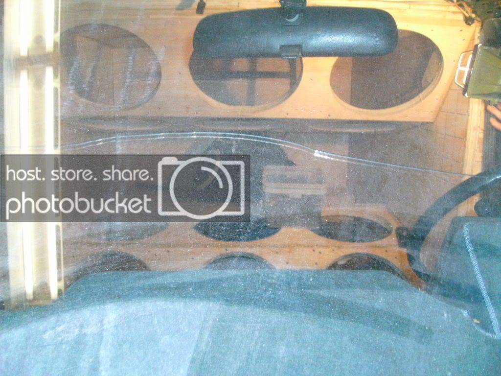

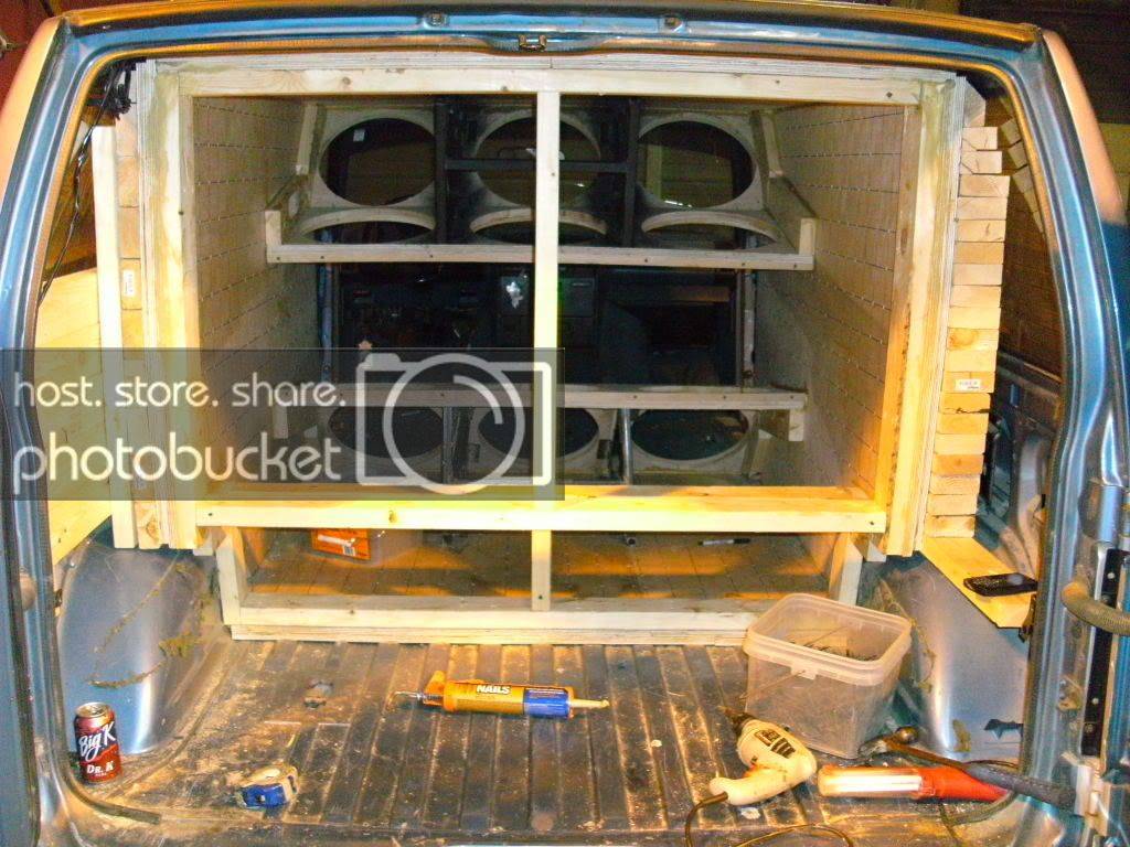

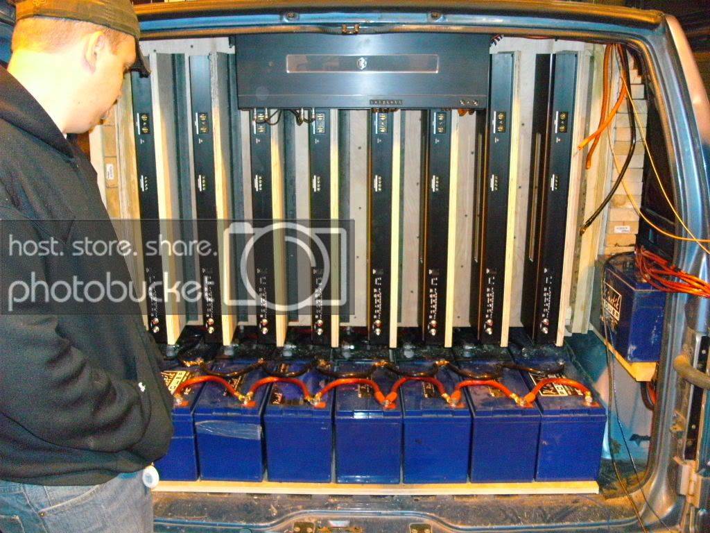

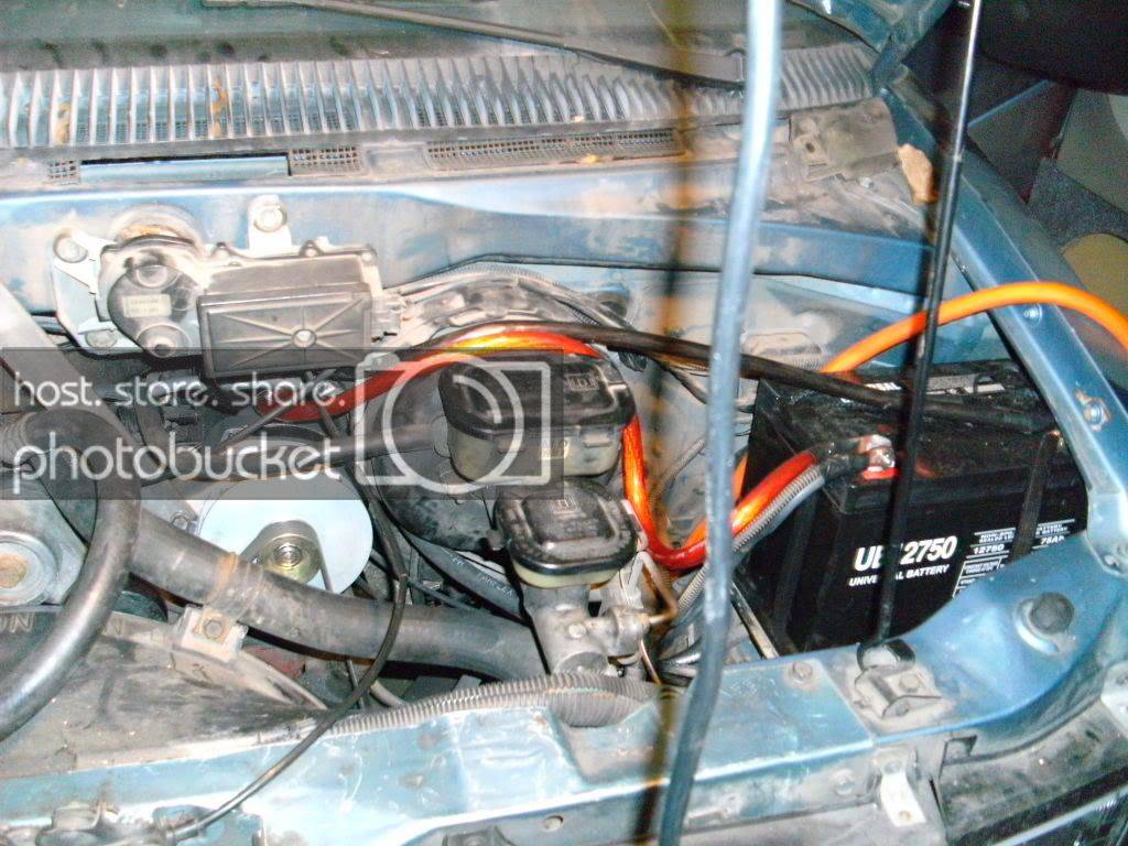

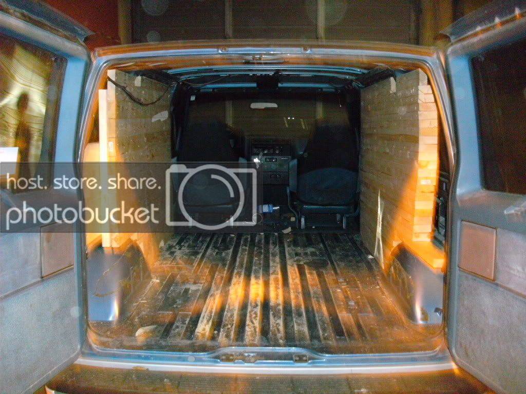

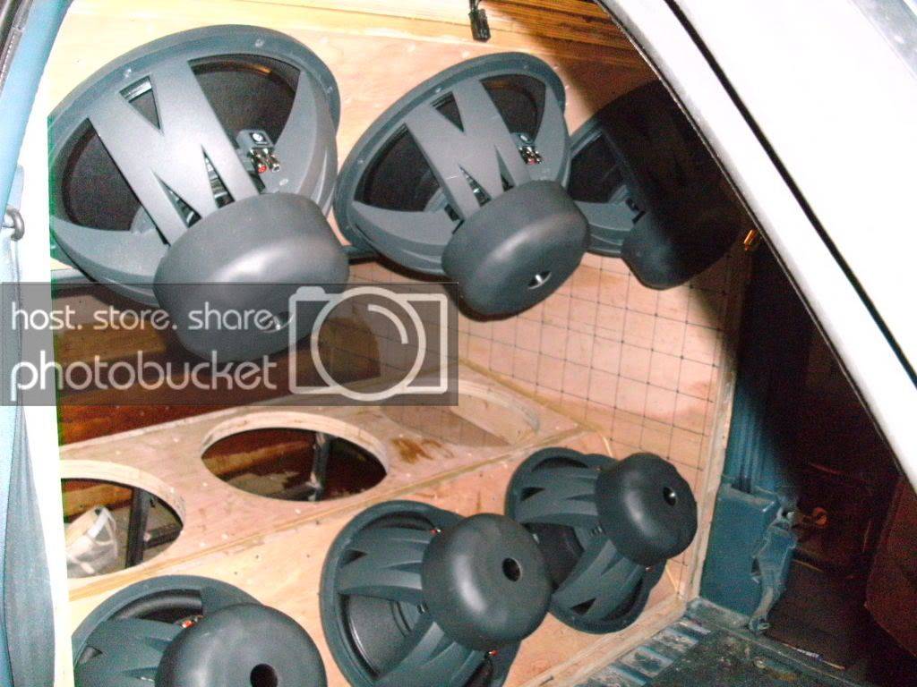

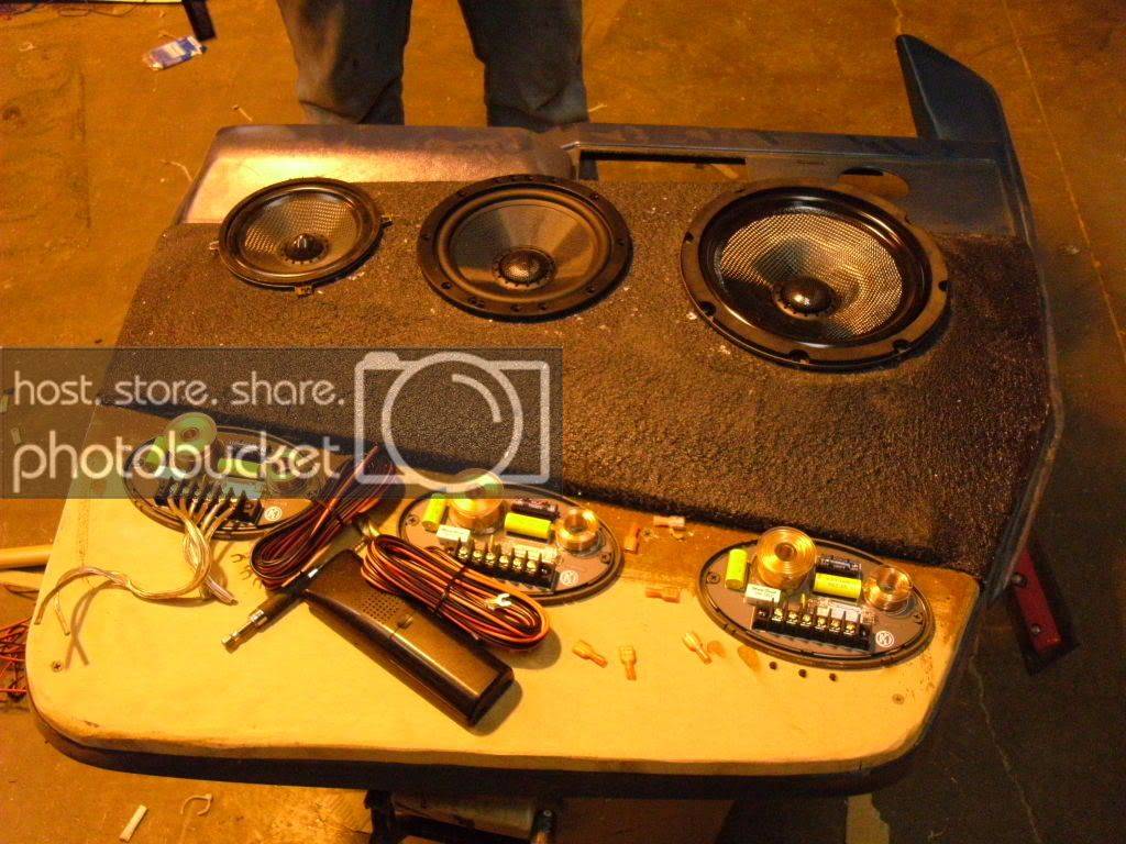

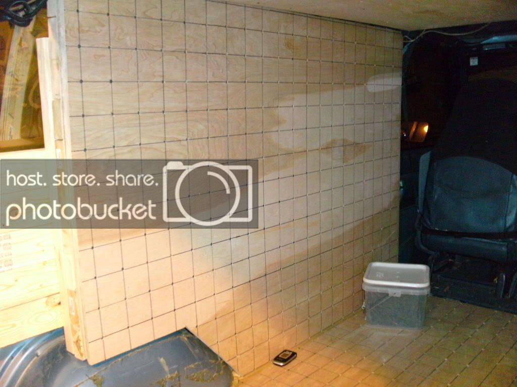

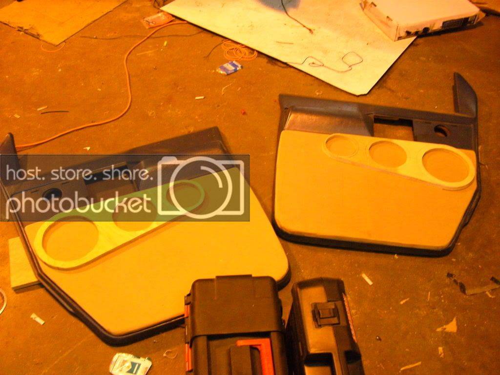

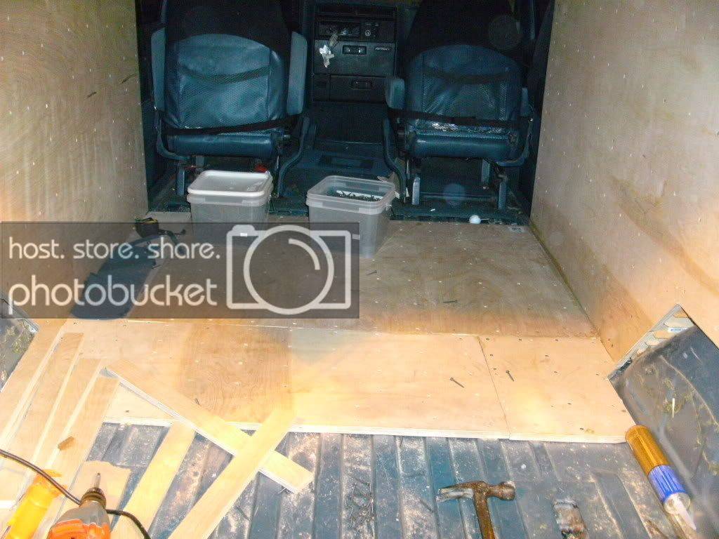

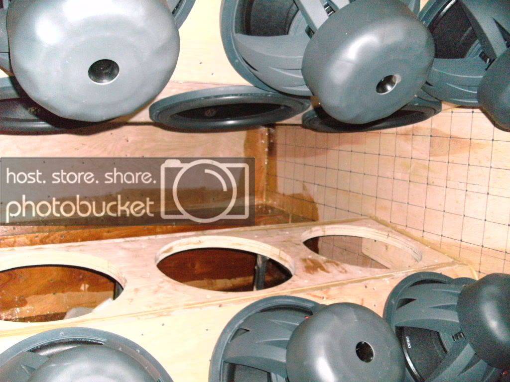

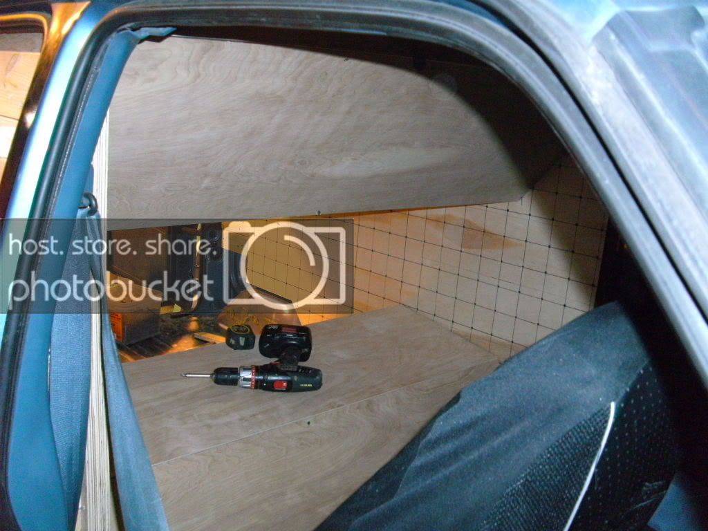

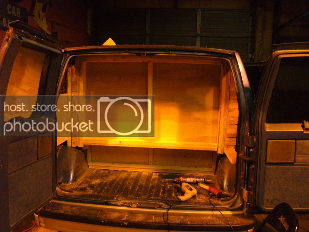

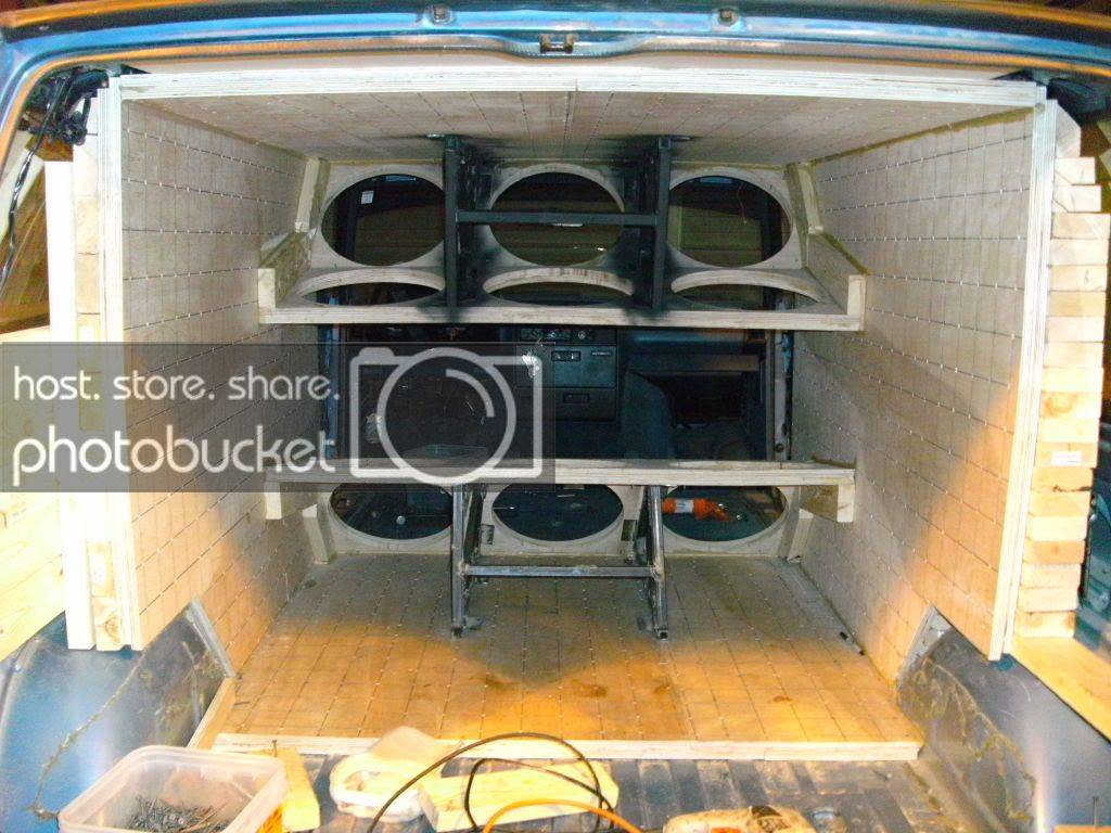

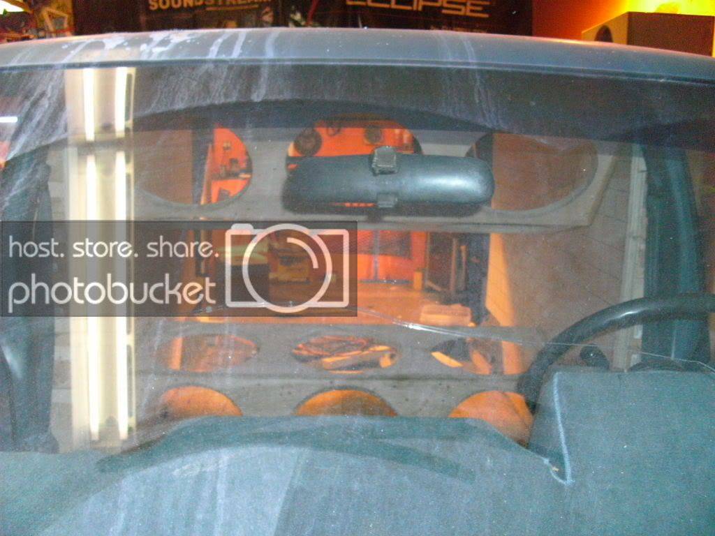

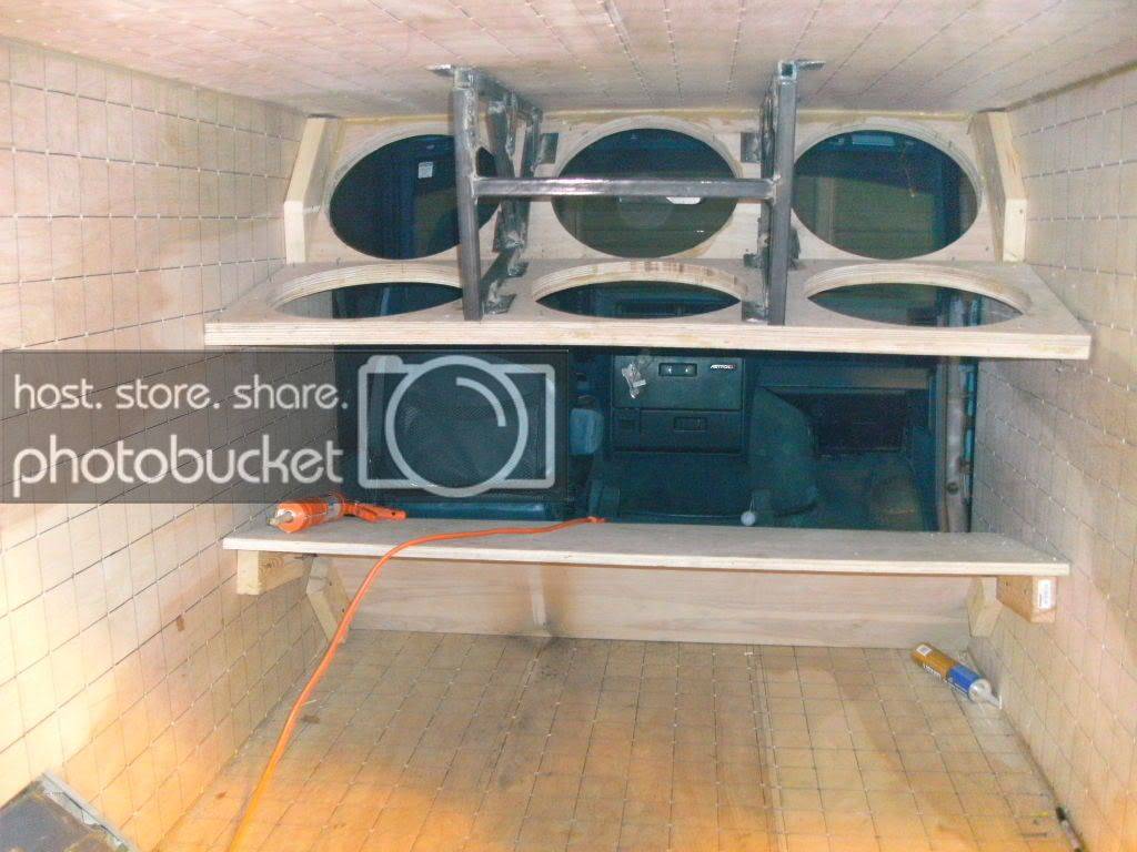

alright i put up a sneak peak a few days back becaues i wasnt ready to show it yet. keep in mind its not even close to being done and well the voltage is CRAP so we are kinda stuck at the moment. we are only seeing 600 rms out of each amp right now after voltage drop to 10.1v and impedence rise to like 5 ohm. not sure if we are going to mod the box yet or not because it seems to be very efficient considering each sub is only seeing 400rms clamped power.
1987 Astro
12 15" mojos (new model)
8 Mojo 4kws (new model)
2 Memphis 125x4's (old and new model)
Memphis mids and highs

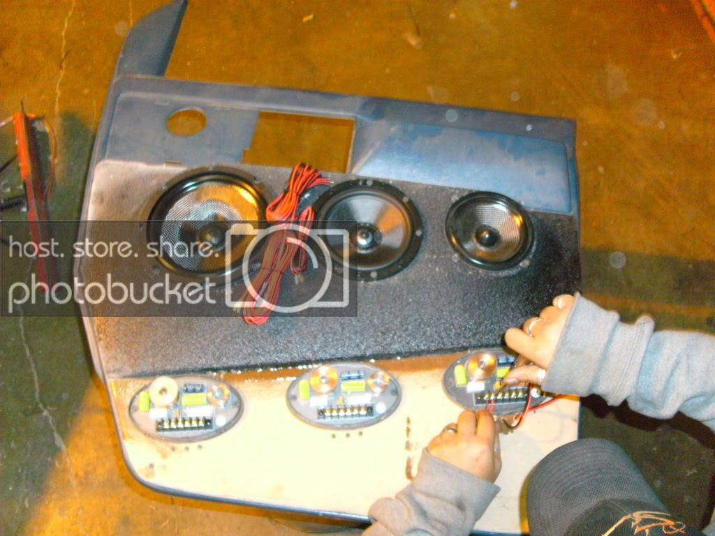

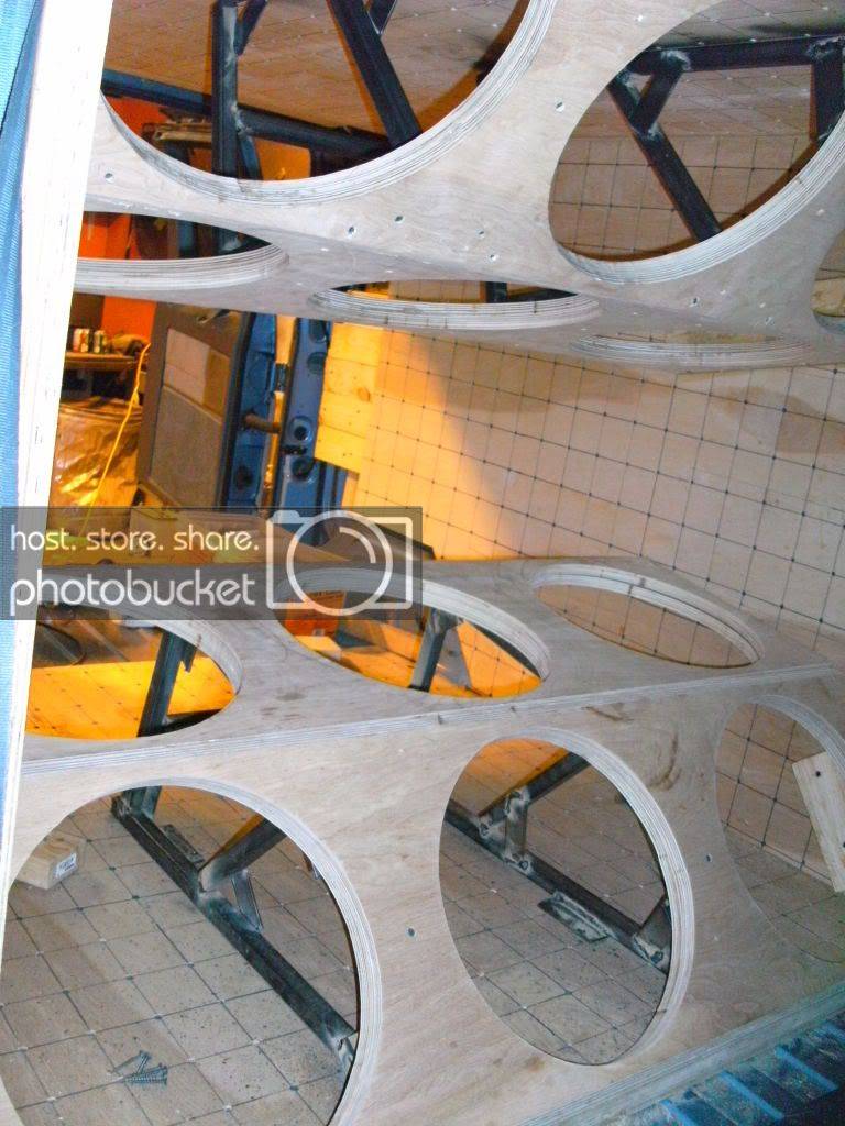

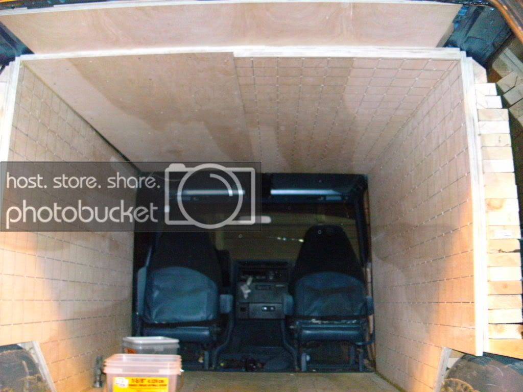

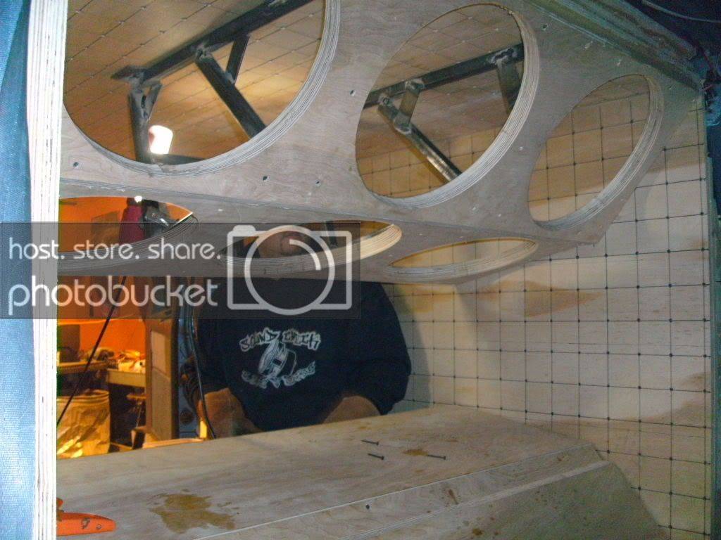

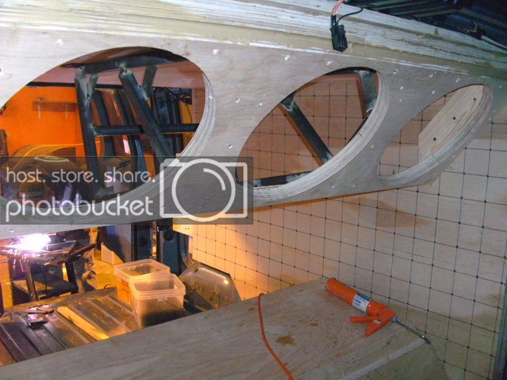

well pics.
welp what u see is where we are stuck at. keep in mind we did this build in 8 days now. there is a group of us working on this like 10hrs a day at the shop. id say 159 isnt bad considering how fast it was built and seeing as its only clamping 4800 rms total out of all amps put together at 10.1v at like 5 ohm.
