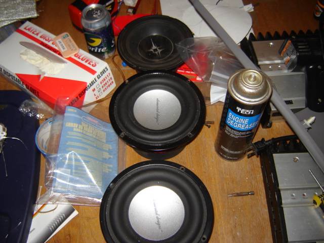

Okay, lets start with some blurry pics of my gear and my sloppy work area, oh and my toe.

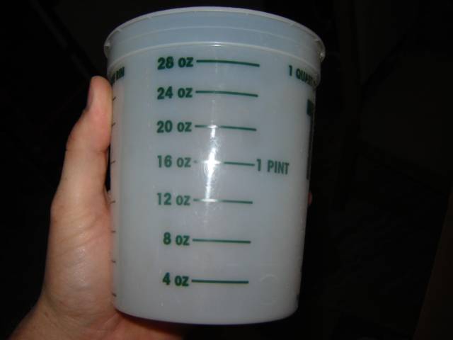

Get a cup like this, plastic, with ounces listed for measurement. They have them at home depot, harbor freight, etc.

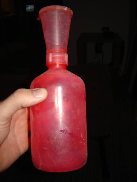

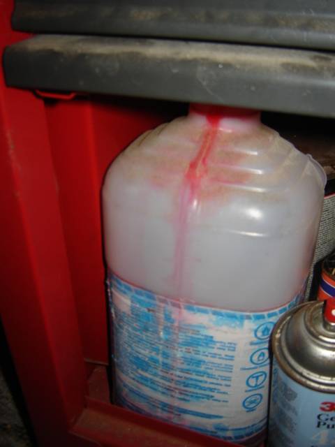

One of my favorite things ever, you squeeze the bottom and MEKP fills the container at the top. Measured in CCs. My MEKP is red, I got it form Select Products a while back, along with the mekp dispenser.

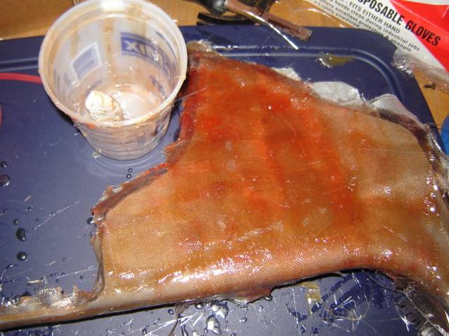

Okay, lets get glassing! Not too many action shots, since I was kinda busy.
Proper safety equipment! I found the chem lab goggles dont fog up as much as other glasses.

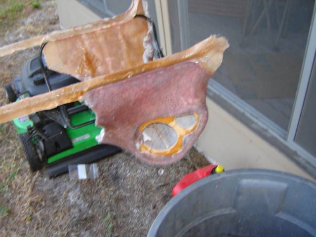

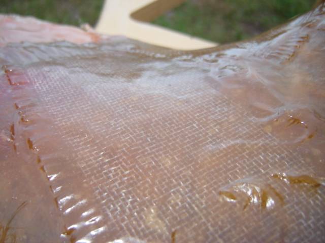

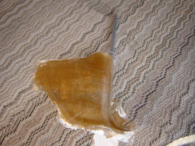

Wet 'glass.

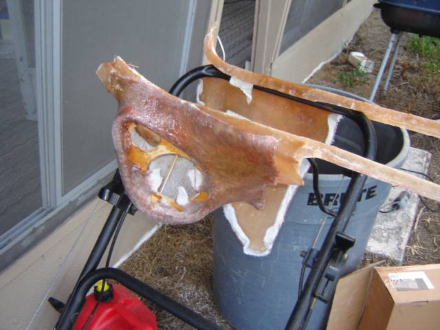

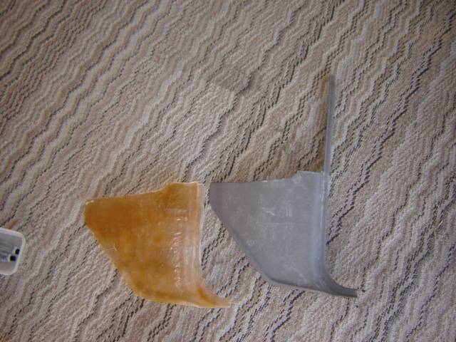

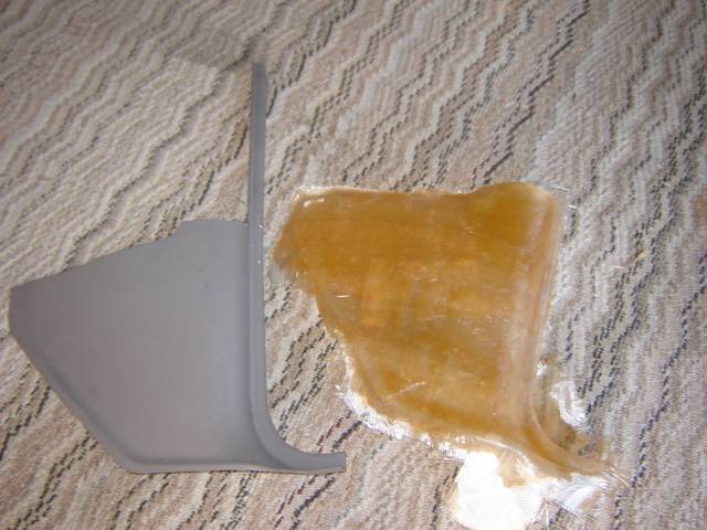

Dried.
'Glass does not stick to plastic, so it will pop right off.
Some minor trimming, looks pretty good!
No plastic was harmed in the making of this thread.

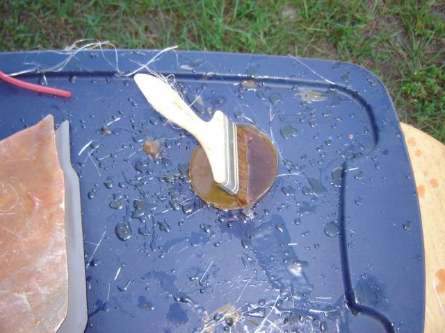

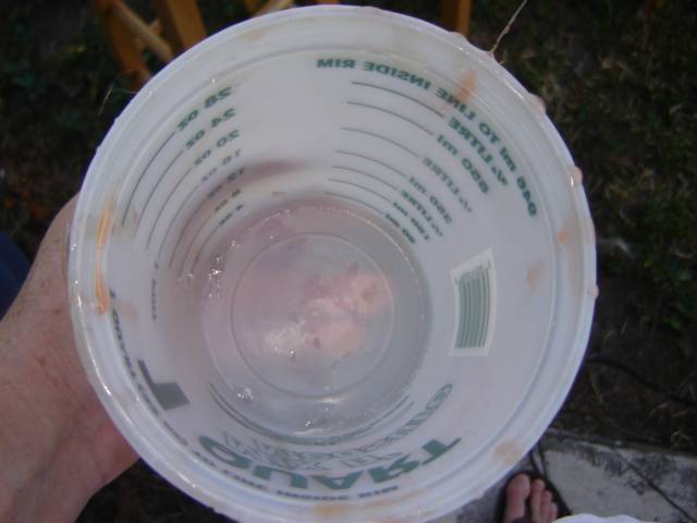

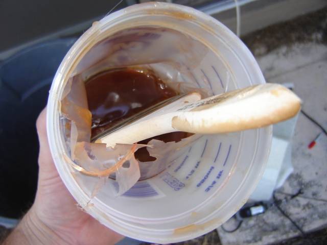

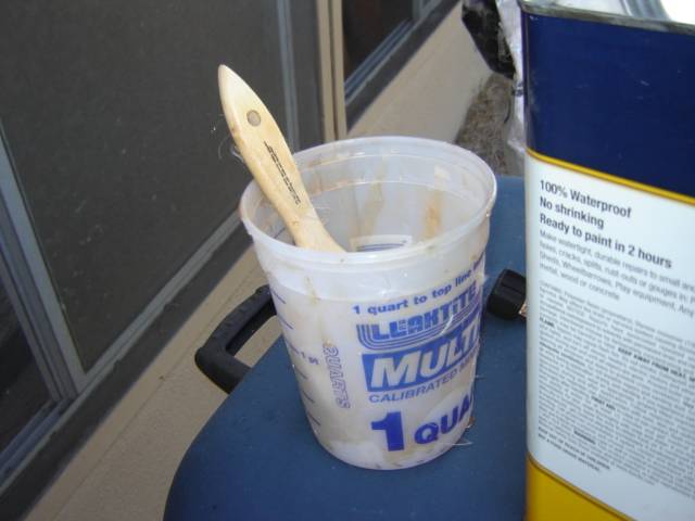

Okay, a little tip. When you use up a batch, there will always be some left. Take your brush and put it back in the plastic cup.
Because, when you pull it out, it will pull out all the resin and crap in the cup. It also gives you cool little bits of artwork.
Clean cup! Saves you the trouble of pulling out dried resin, or having it break off the sides and end up in the wet stuff, then on your project.

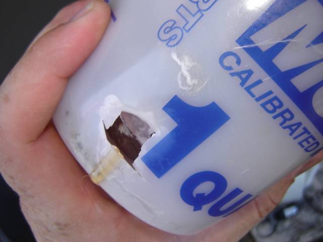

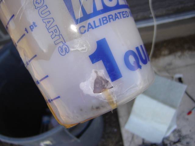

Doh! This cup was showing it's age. A little too hot a batch weakened this spot, and when I tried to pull the brush/resin out, it broke the plastic. Reason number 234234 why you buy extra cups.

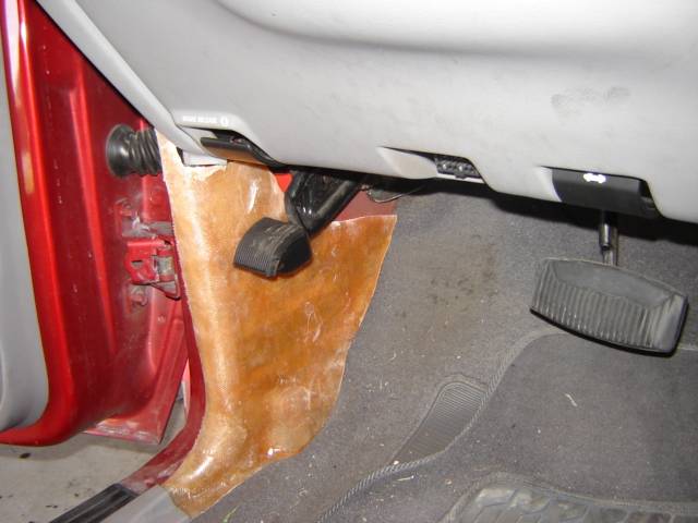

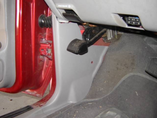

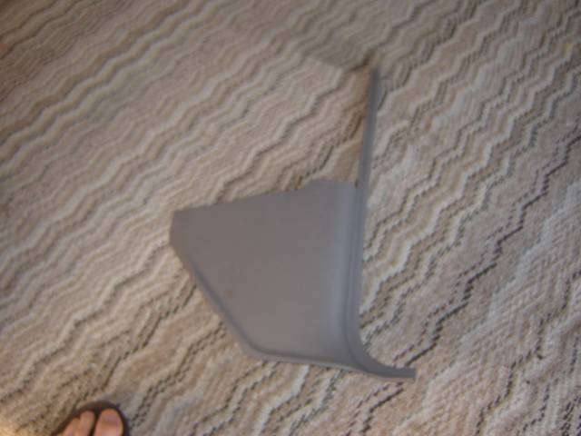

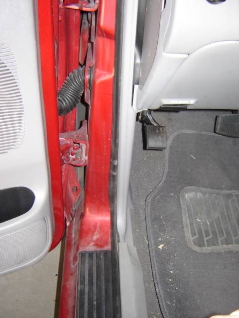

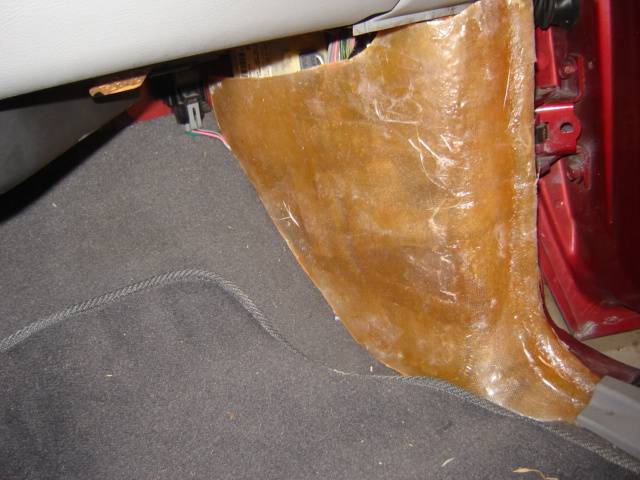

Stock Kick panels

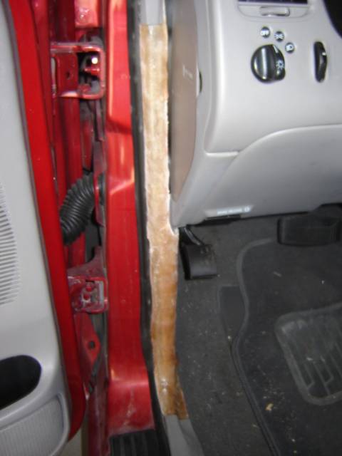

My glass replicas. Pretty close right!
Sloppy work area! I didnt want to ruin a piece of wood, so an old rubbermaid lid works. 'Glass doesn't stick to it either.

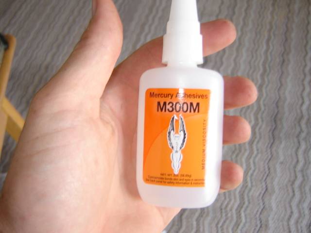

Yeah, gorilla glue and titebond are cool, but this stuff is my favorite.
CA ( cyanoacrylate) Glue, superglue, whatever. Pick it up at your local hobby shop.

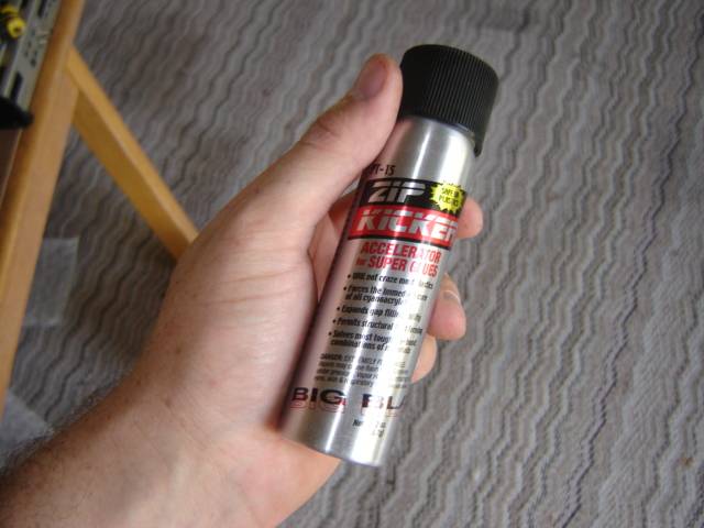

Get this stuff too. CA accelerant. Turns 5 second glue to 2 second glue. Really helps when gluing supports or just holding a panel in place. I've built boxes with this stuff, and it holds great. Eliminates all the drying time.

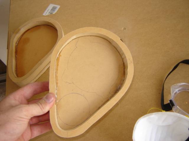

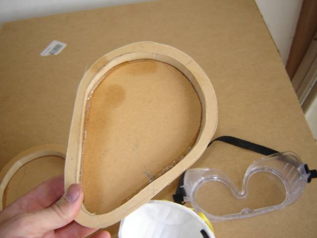

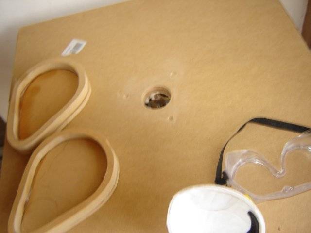

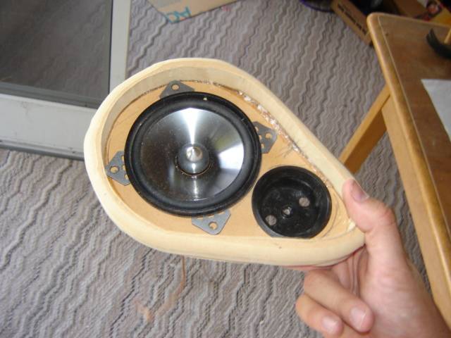

Okay, some jigsawed baffles.
Where the mid and tweeter are going

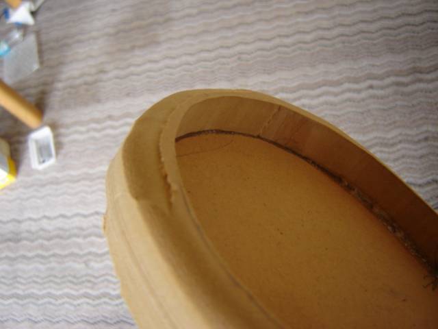

My router table

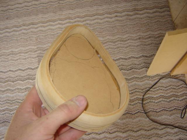

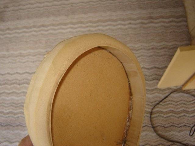

Rounded the edges. This does two things: aesthetic improvement when glassed, and it gives the 'glass more surface area to stick to.
ARRgh, wouldnt be my project without something like this happening. Double check the bit height before you start.

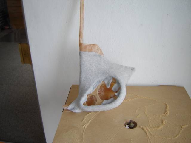

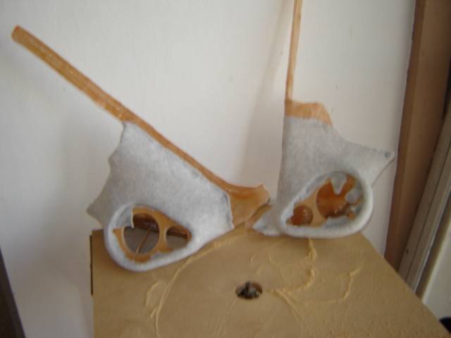

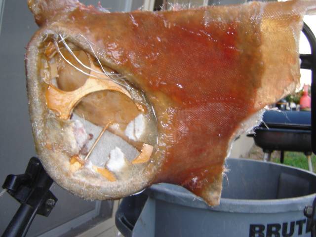

Fleece, glued around the panel, in the baffle, etc etc
Lawnmower doubles as a drying rack

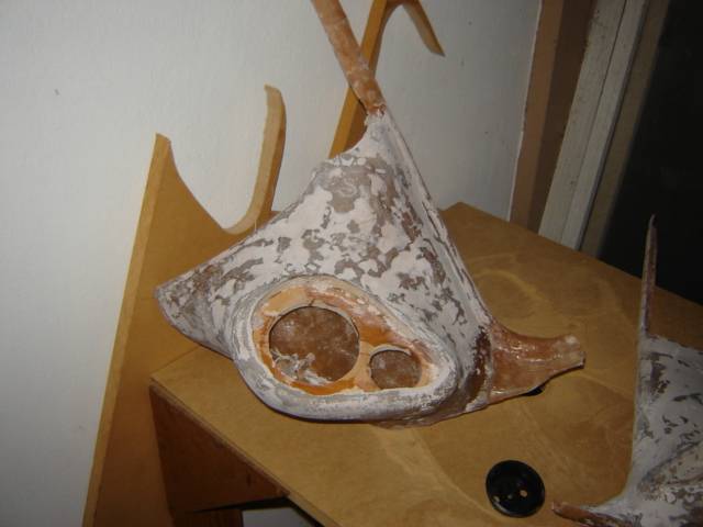

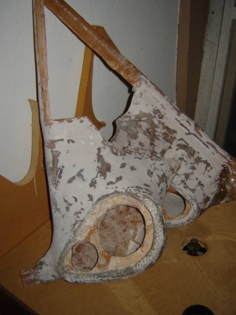

Reinforcing
I like to lay the weave matte last, since it gives a much smoother finish. Requires far less sanding at the end.

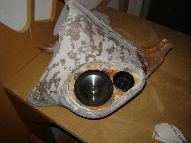

Missing a few pictures, slap on some body filler, sand, repeat.
//content.invisioncic.com/y282845/emoticons/cool.gif.3bcaf8f141236c00f8044d07150e34f7.gif

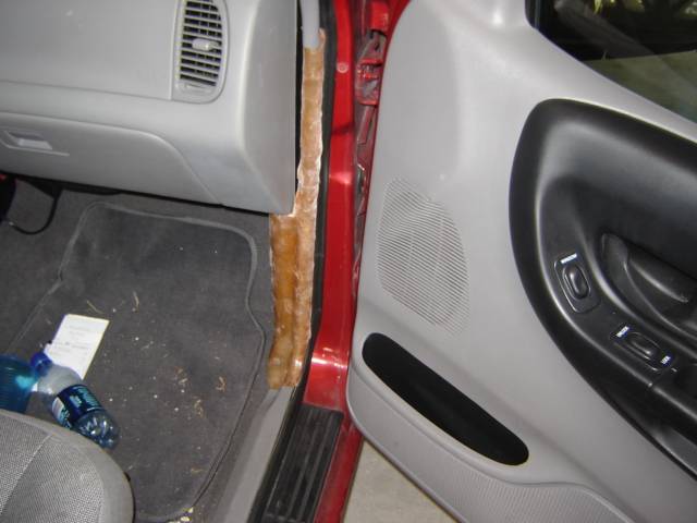

This was about a day and a half. I have a bunch more body filler to throw on, lots of sanding, then painting!
