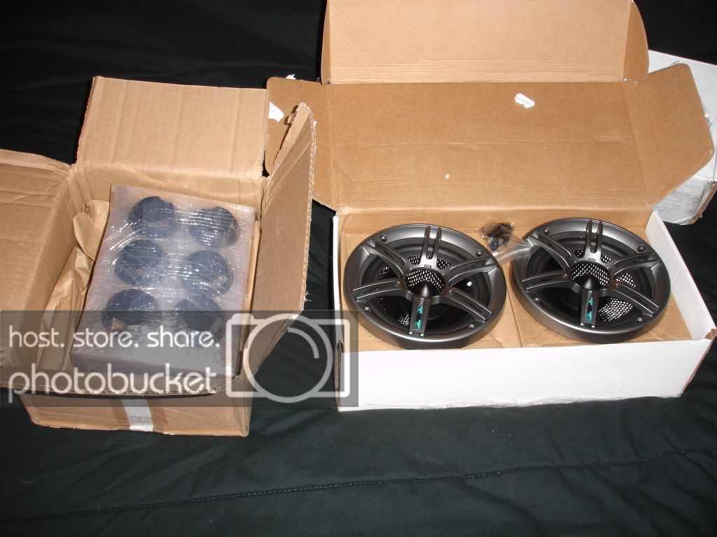

Ok everyone the time has come to revile what I am planning on doing next. I got a few packages in today. Lets all take a look and see whats i them.
I wonder what can be in these boxes?

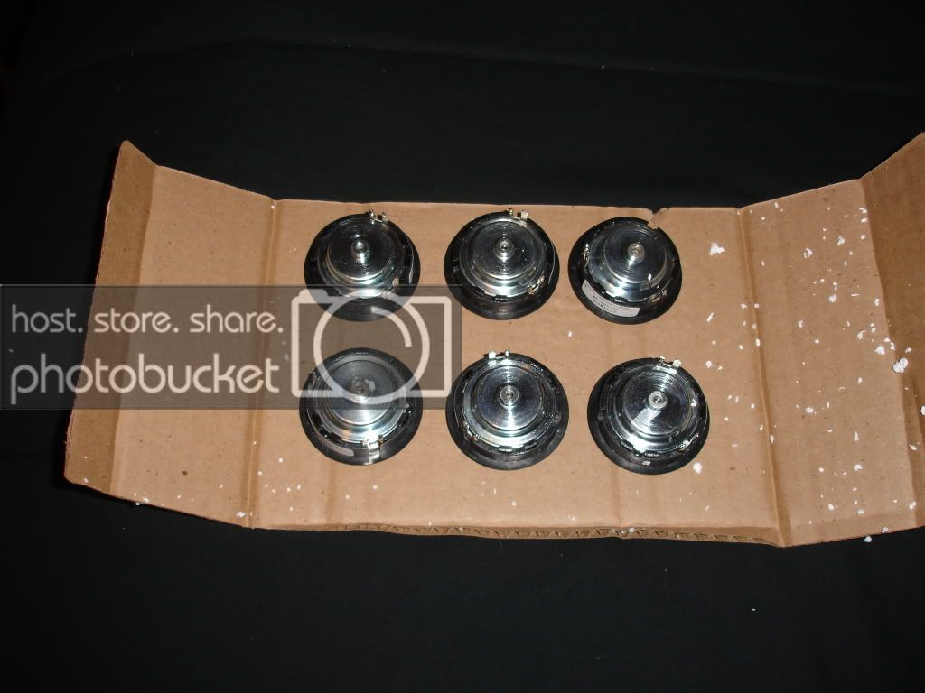

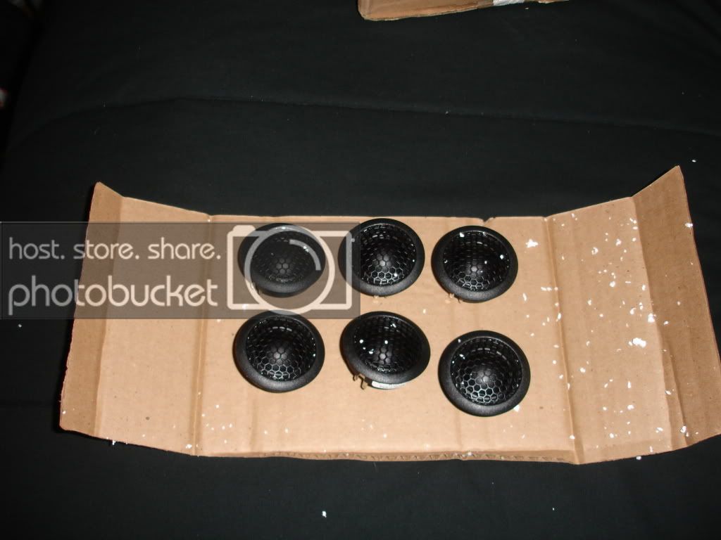

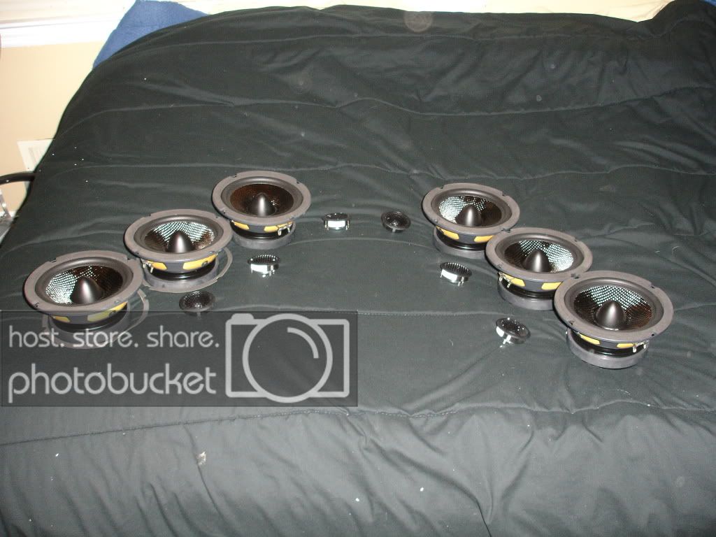

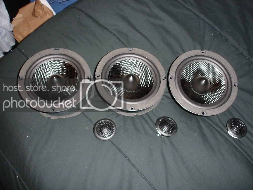

How about some ID OEM 6.5s and some Seas Neo Textile tweeters.
Some *** shots of the tweeters, and yes that is 6 of these your eyes are not playing tricks on you.
Here is what they look like from the front.
Here is everything together

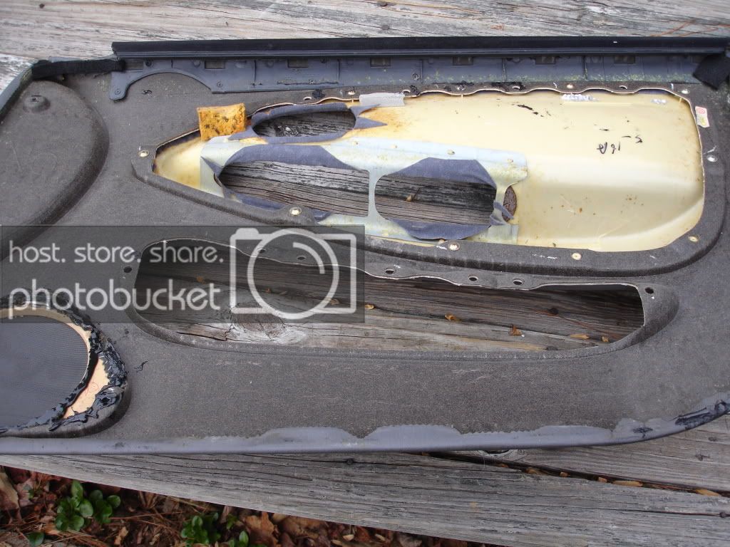

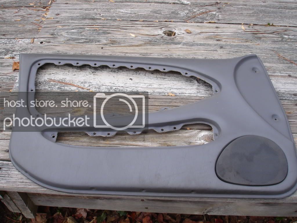

This is what is going into one of my doors.

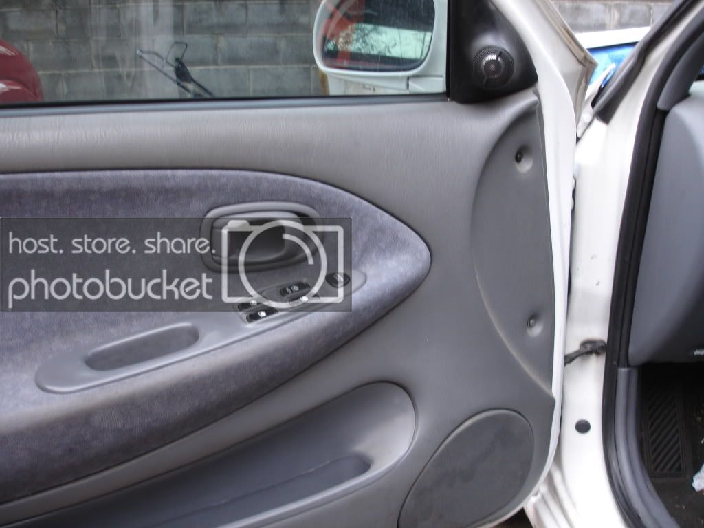

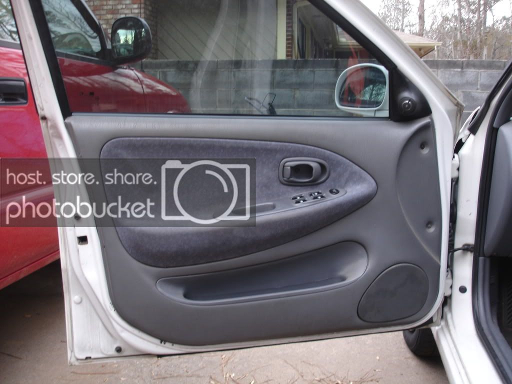

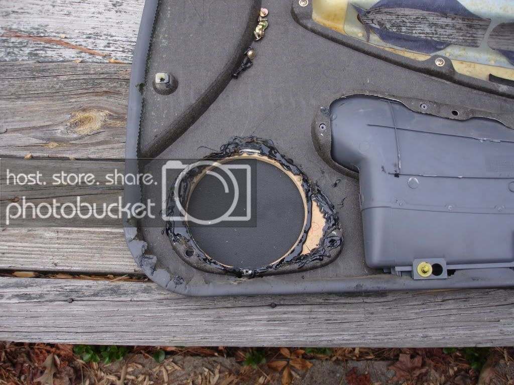

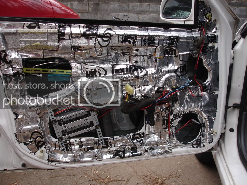

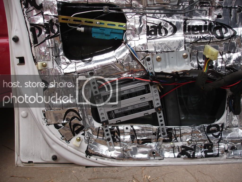

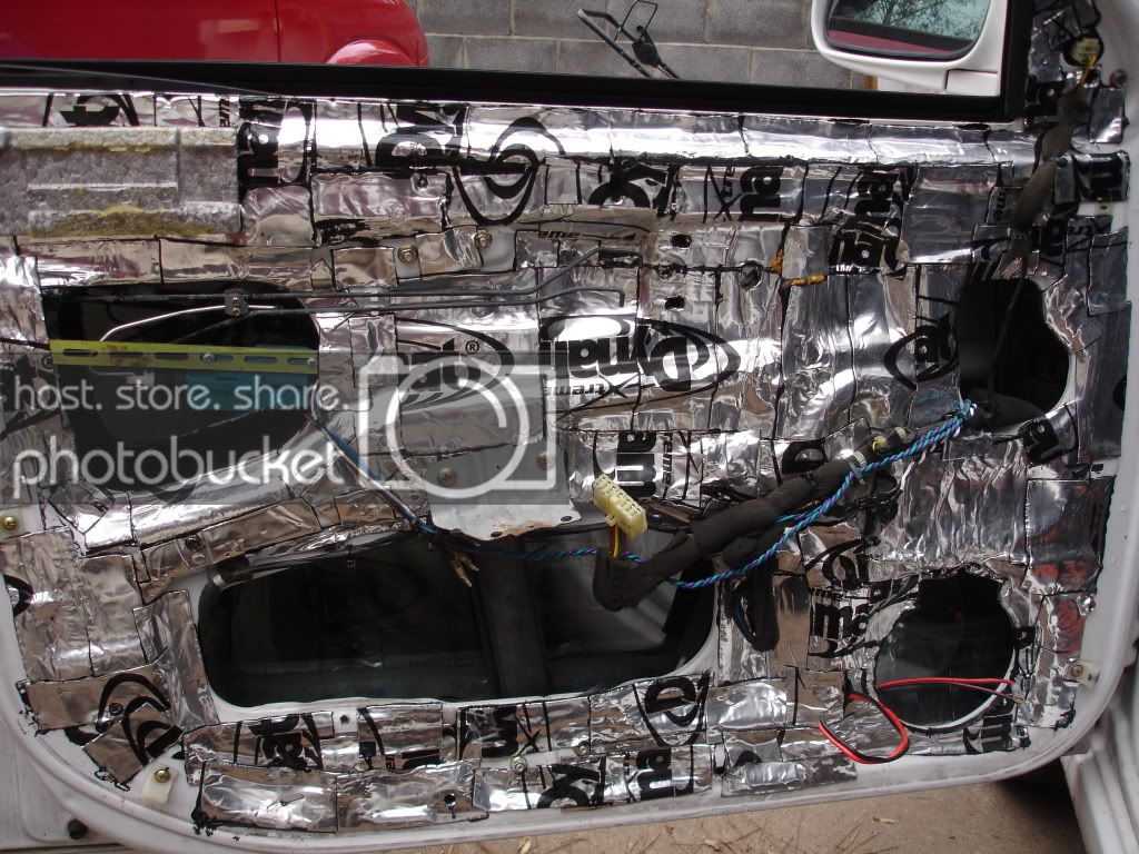

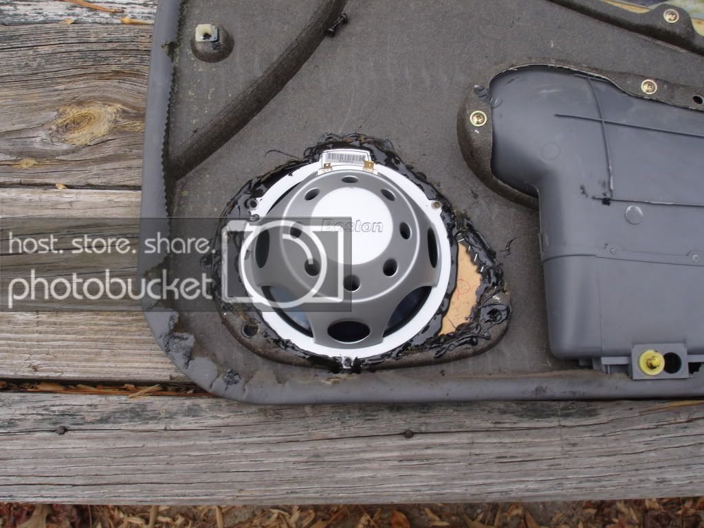

This is how my doors look now.
I have the tweeters molded into the A-pillers but I am going to do somwthing a little diffrent on this build.
As you can see I bairly had room for the b oston crossovers. I had them held in place with bach strap. I plan on cleaning up all the wiring in the doors. I am going to use a terminal strip to connect all the ID's and Seas twetters togeter to make the install cleaner.

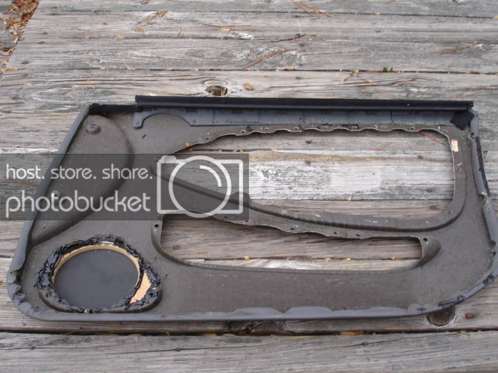

I am going to have to cut out the sheet metal around the factory speaker opening to help accomidatethe depth of everything.

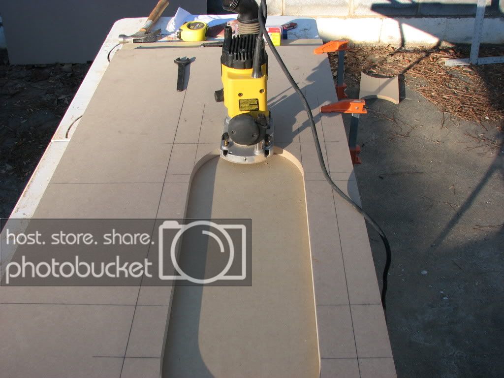

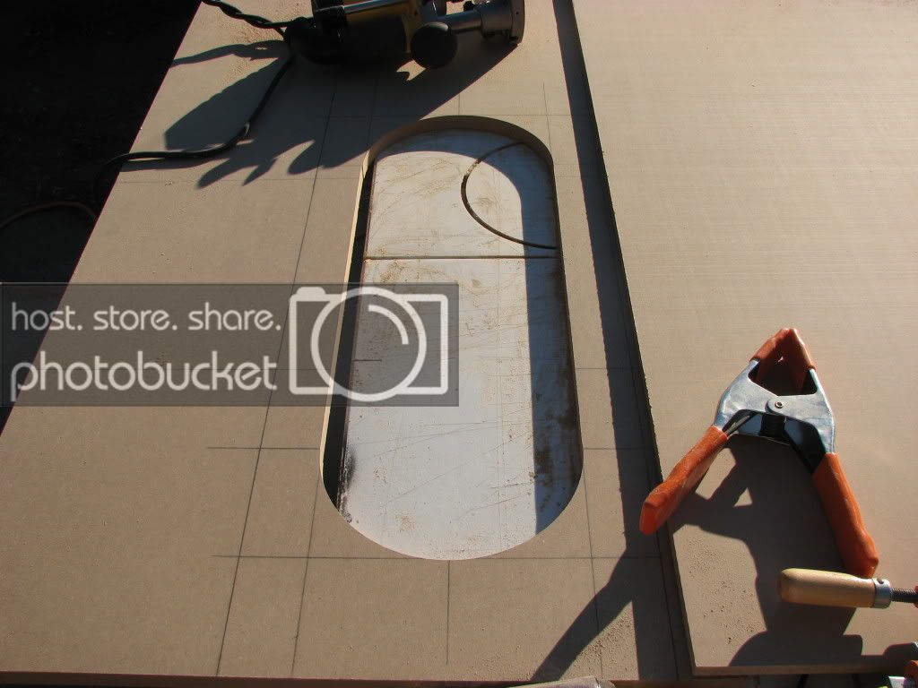

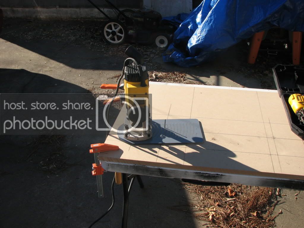

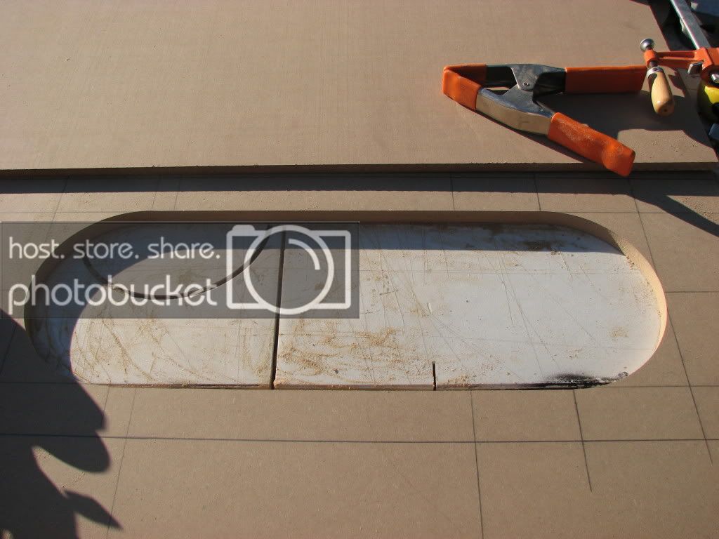

Geting setup to start making my template for all the baffles.

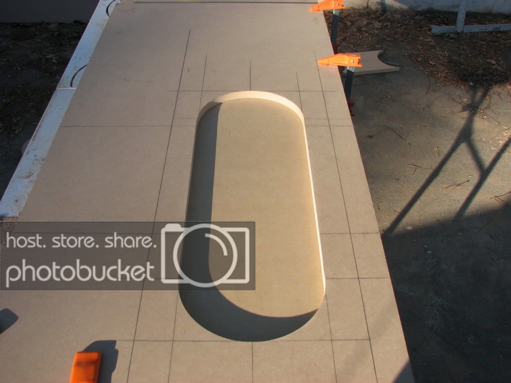

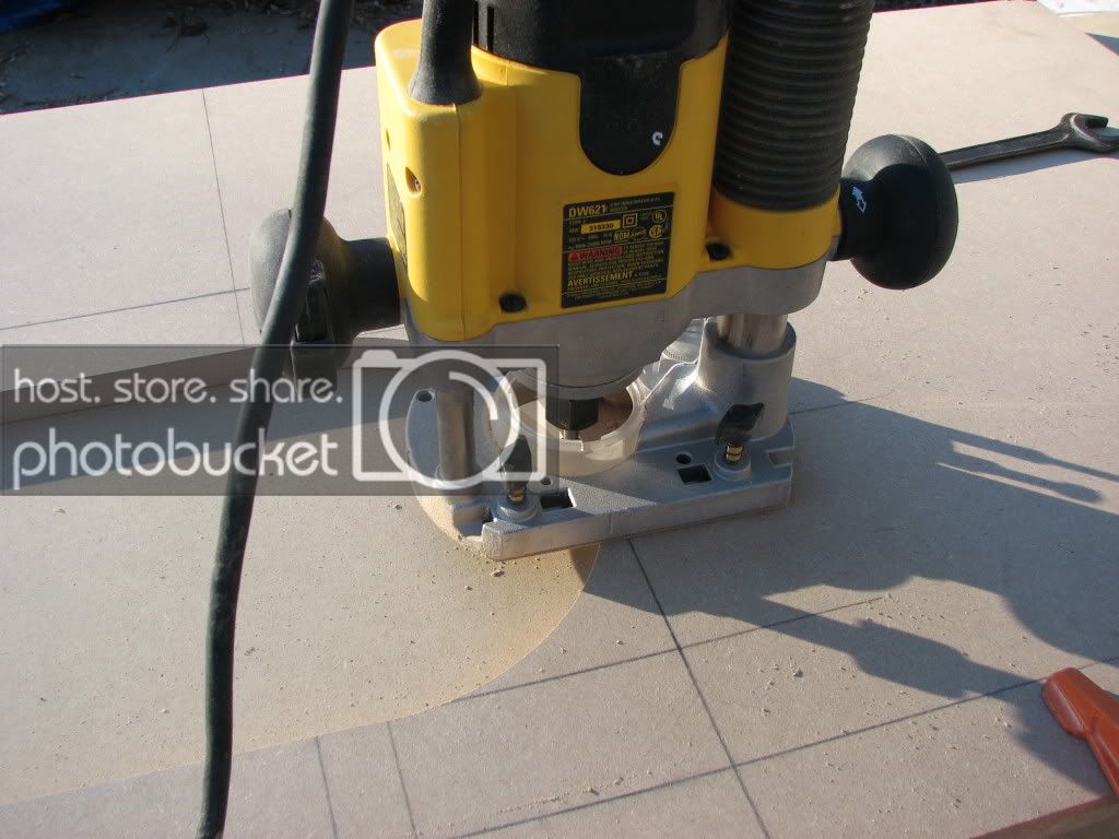

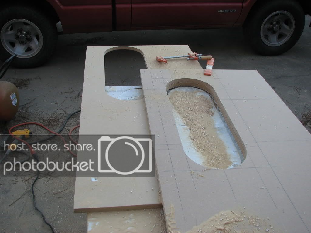

After I cut out the outer radia
I could not find the bottom plate for my roughter so I could not use my collets so I lined up a sheet of 1/2" MDF to give me a straight cut.

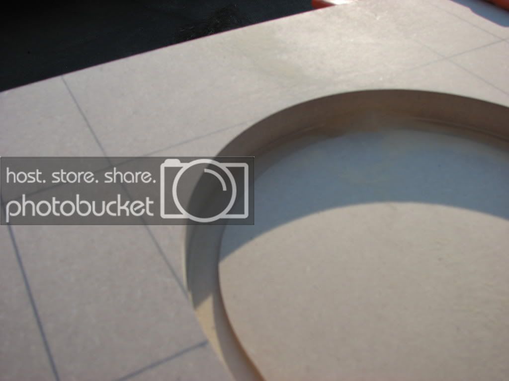

The jig all finished.

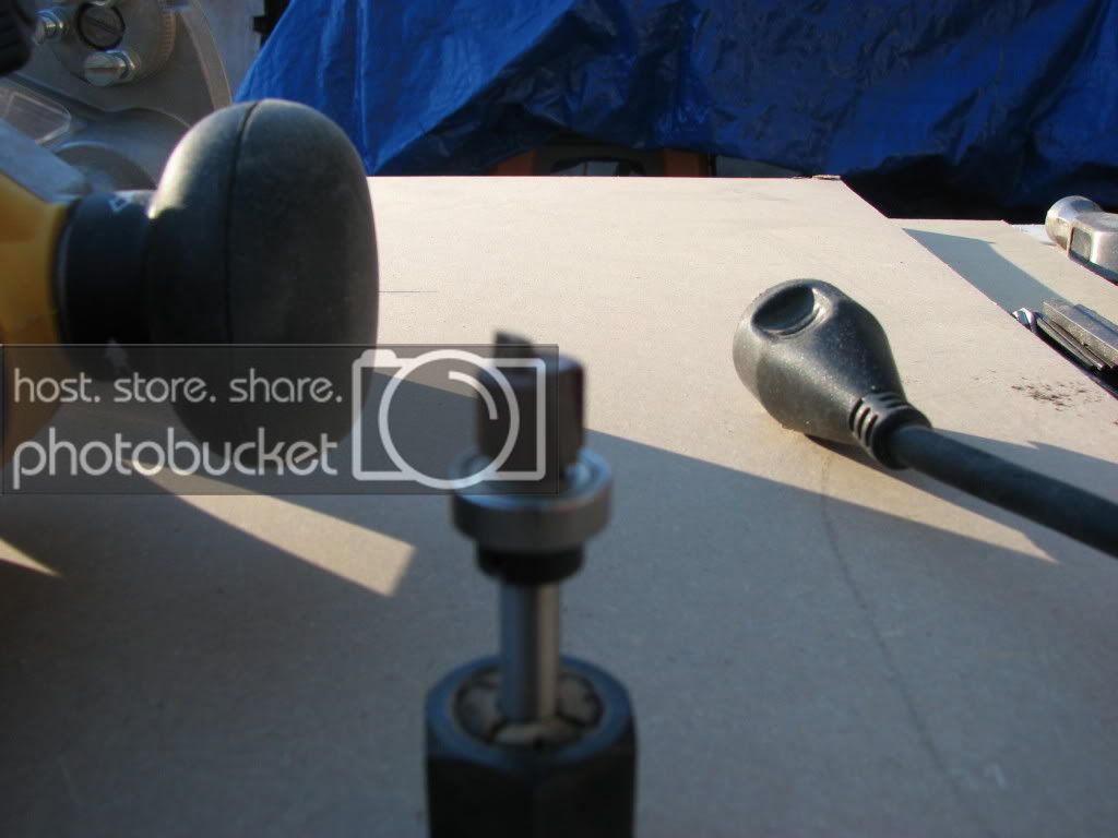

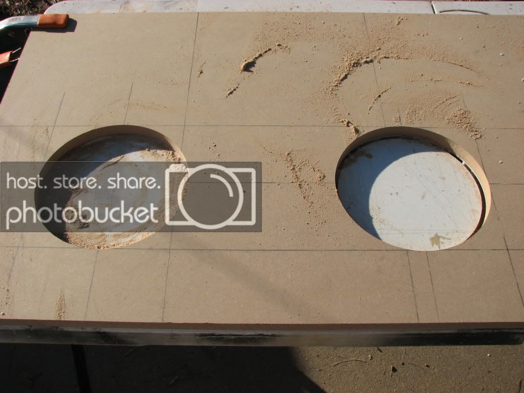

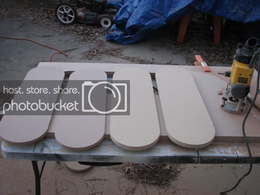

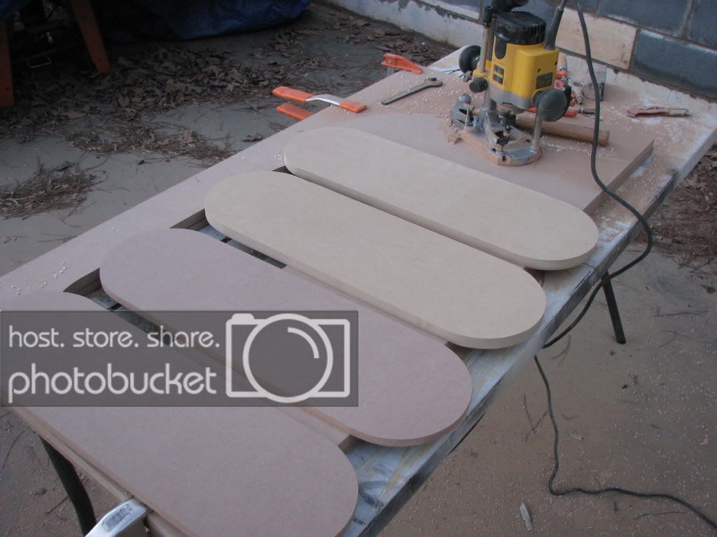

Geting ready to cut out the baffles, I use a 1/2" by 3/8" tracer bit to cut all the baffles. Makes things so much faster and everything comes out to be the same.

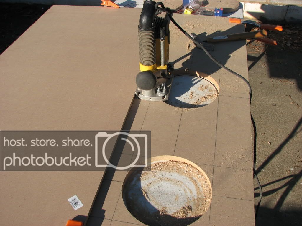

After te first pass, I made three passes in order to make it all the way through.
Getting ready to cut my second baffle out.
And all 4 baffles cut out. Took ten mins to do this. No joke.
