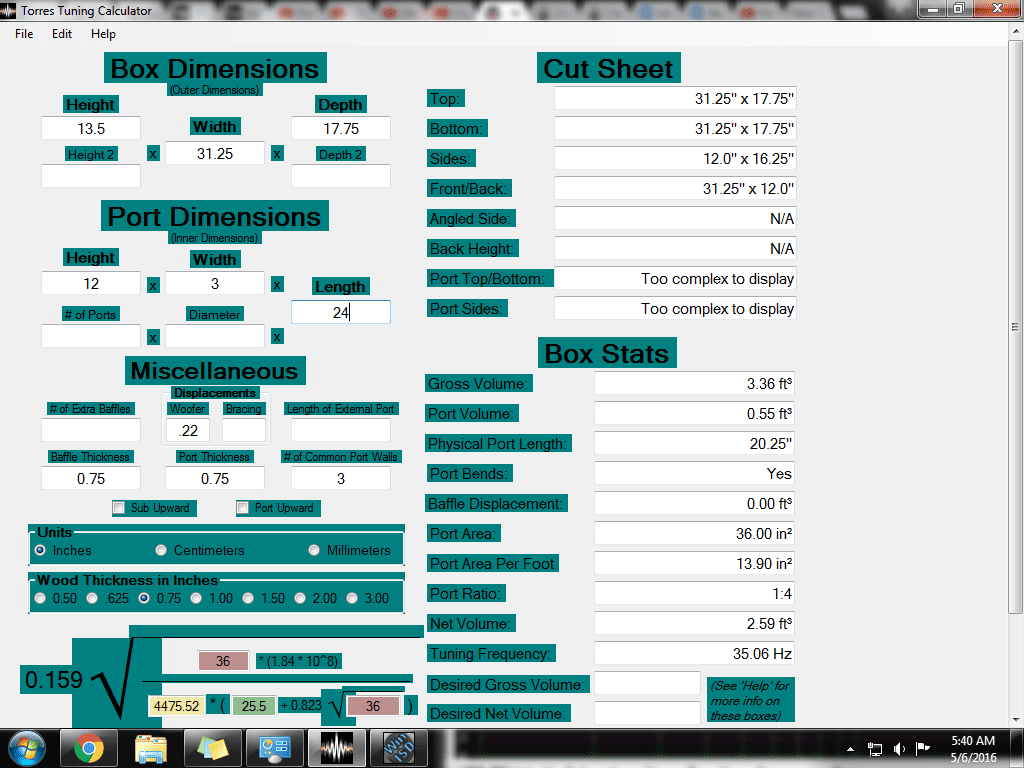

31.25 width 17.75 depth 13.5 hight and its all 3/4 inch mdf. I put that into a box calculator and it gave me 3.3572 and thats before port area gets added in so yeah i guess i need to add some hight or something to this box. i wonder how much poly fil would be needed to make it sound right
No sh*t they wont walk over the sonys, your box is utterly fked, nothing will save it.. Thats a box for a single 12 or two 10s not two 12s. Subs are strangled to death. How can you even possibly have anything work in a box soo small.
With good port figures, the best you can get out of it would be 2.5 cubes net. These subs need 2 cubes each and you literally starve them. Who the hell made the box for you? its complete junk based off the outter dimensions. Sounds like a prefab box or maybe worse. This box, you'll only get 20% of what they can actually do at best.
Its actually a port width of 2 and i dont know length or hight. Those subs need 1.75 as sundowns recommendation not 2 cubs each. Even when they were in the one cube each sealed box they had the same type of sound just not anywhere near where they should have been. The box can be modified thats not an issue..
