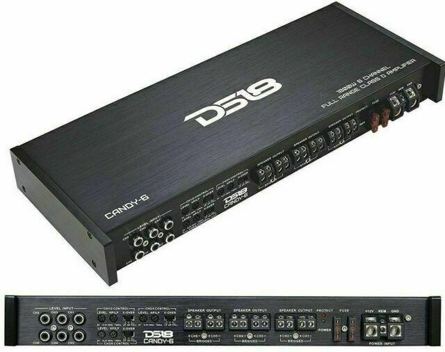

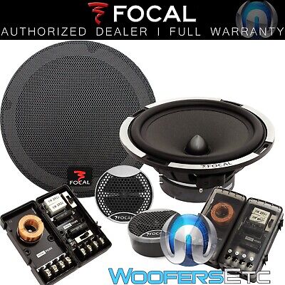

Great buy on this unit eBay,
2 x 125 watts to a pair of 2 ohms comp sets.
2 x 250 watts to a couple of 8's or 10" subs ( the biggest you can fit)
Dual 10's
In a small sealed and stuffed box.
Or this amp same speakers 120 x 4 or 400 watts bridged x2 and up to 900 watts by one for the subs.
