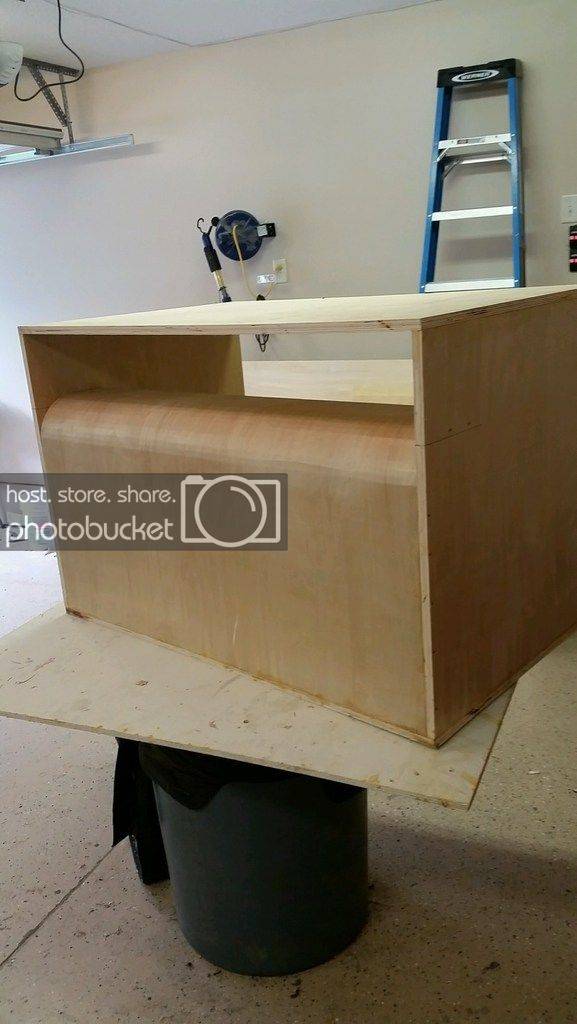

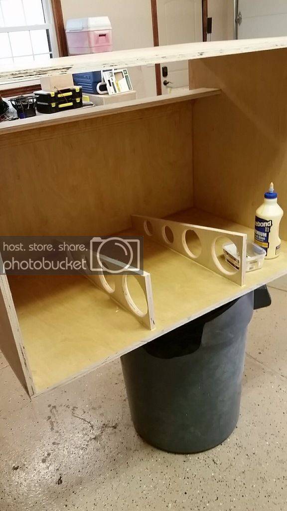

Well my personal build has started let me give you a rundown.
Kerf ported 4th wall large ratio for 3 nvx vcw 12's
1 bb5000d at .66 "temporary"
2 wet cell 860 cranking amp batteries in the front
Big three

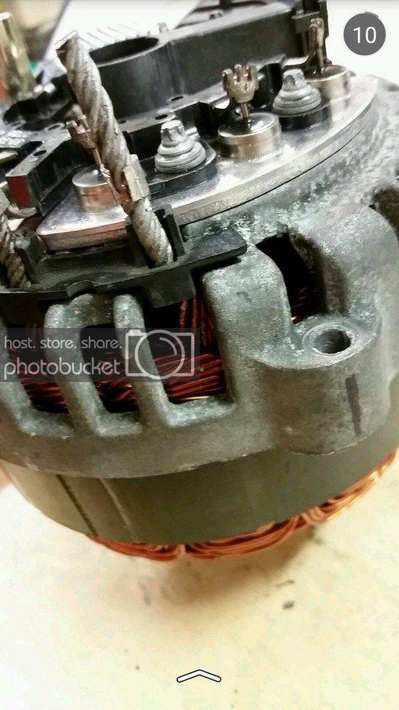

Ad244 alternator rebuilt with a 240amp rebuild kit i got from a company online
1 run of 1/0 gauge welding cable to the back
1 ds18 pro mf 8 and super tweet per door in a custom pod
Oldschool Rockford 4ch
Now for some pics
