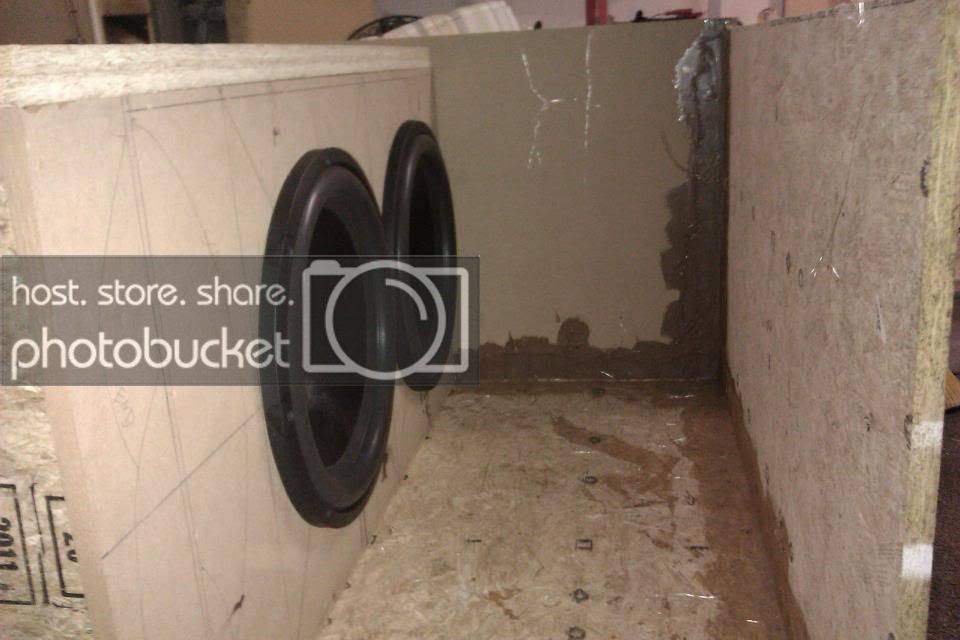

basic of the box

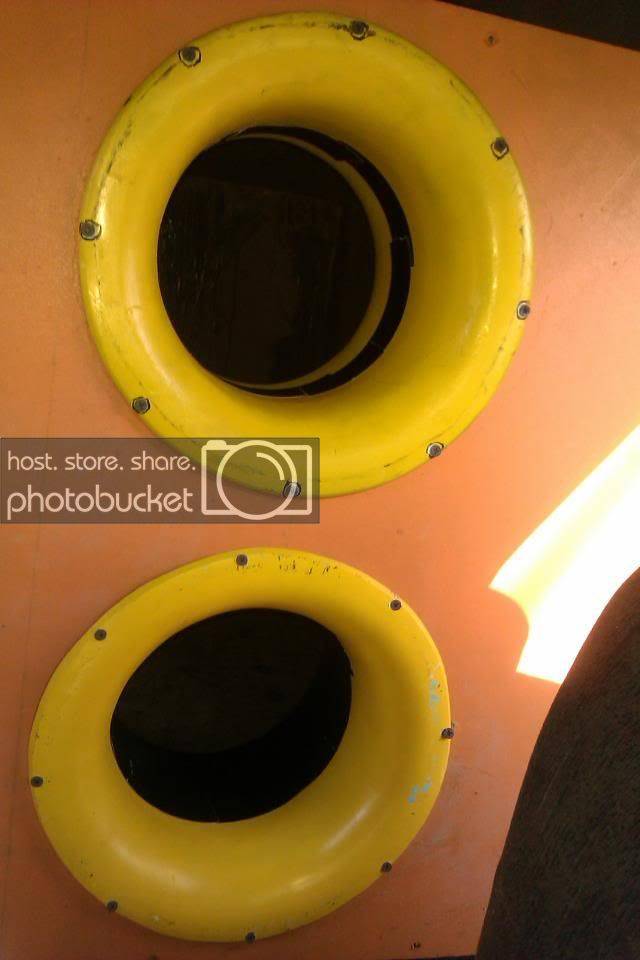

the ports front view

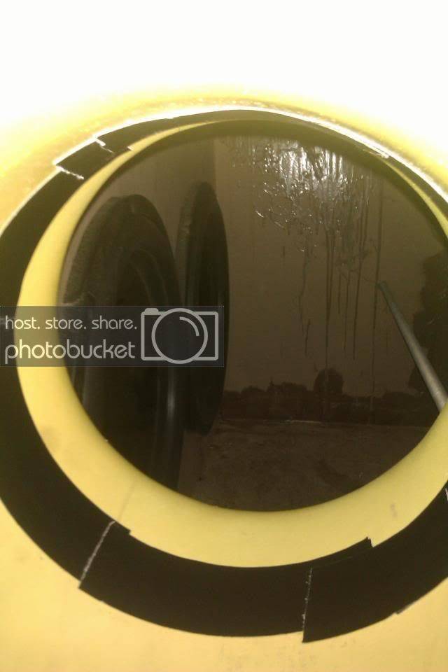

looking into the ports

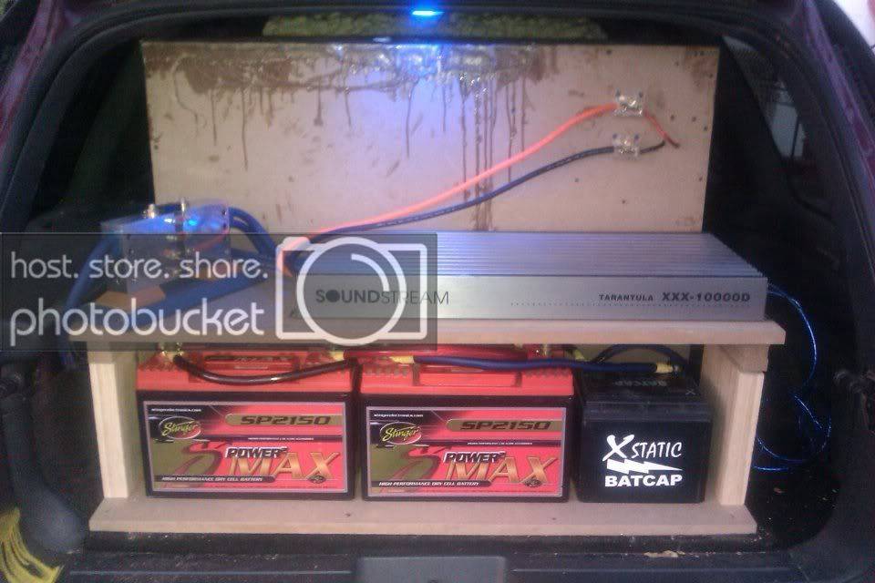

and the back just for looking =]

The sealed box causes a lot of impediance rise. I've clamped it at 1.4 ohms with 3x impediance rise and it was doing 6k and these 2 are wired to 1. So idk what it is putting out. But the amp gets hott quicker than the subs lol. I love these subs. But would adding another port tune it higher? And what do you think the results of making the sealed box smaller would do? I'm taking oppinoins here. Help me out?
i bet it slams the low end and that is mainly because you have a huge sealed section. if you shrunk everything up then you would end up getting the response that you want. right now i am running 2 18s in a 4th order. about 4.5 cubes sealed and 14 ported off of about 2000 watts and i can tell you that i am in the very high 40's. the XXX seems to like a larger box so what i would recommend is that you shrink it about 2 cubes and see where that gets you. also increasing the port area is going to change your tuning. what did you tune it at?
no clue man just threw it together 8.5 cubes sealed 16 cubes ported. 2 8 inch aeros that are 11inchs long each. lol u tell me idk. and yeah 28 hrtz pretty good flex. but i know that it has alot more potentual in it for sure
