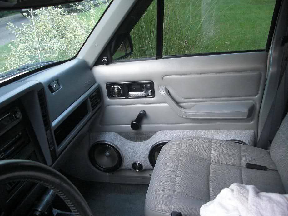

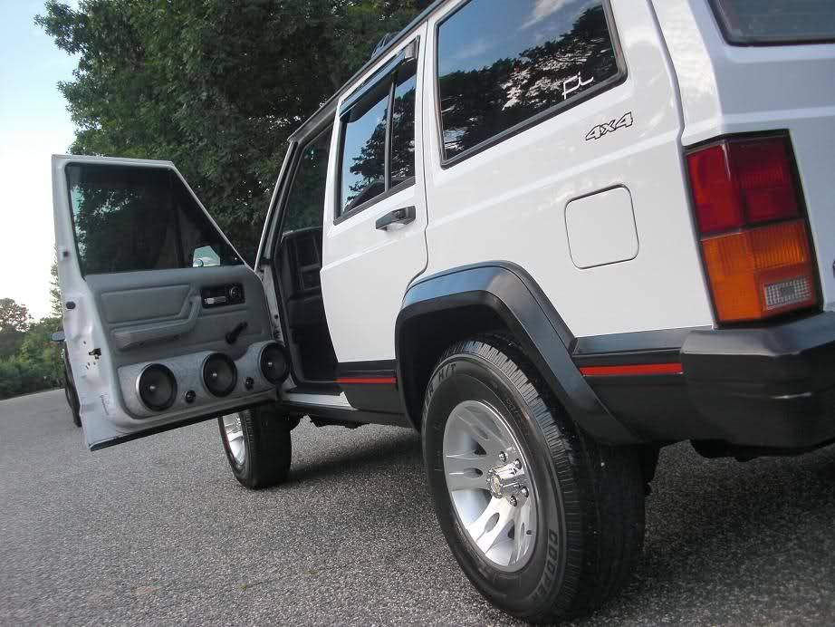

I Have decided to cover the pods with grey carpet to match the trucks carpet. I didn't feel like working with vinyl this time around //content.invisioncic.com/y282845/emoticons/crazy.gif.c13912c32de98515d3142759a824dae7.gif .
Thanks alot man^^ As for how they sound.... I've always enjoyed the Pioneer D series as a single set in deadening doors and so on but in all honesty putting these comps in in sealed pods was probably the most suprising upgrade to an already outstanding component. The guitar plucks and drum snairs are very precise and have much more impact with the vocals being the most satisfying. I have them hooked up so I'm able to choose which set I want playing at any given time. As of right now the (2) front sets are running as the 3rd is played while demo'ing with the doors open. I will be experimenting within the next week trying to seal off each mid in the pods to see if there is any acoustical differences without having the common chamber. Each mid is seeing roughly 100 per side crossed at 63hz/6db slope.
