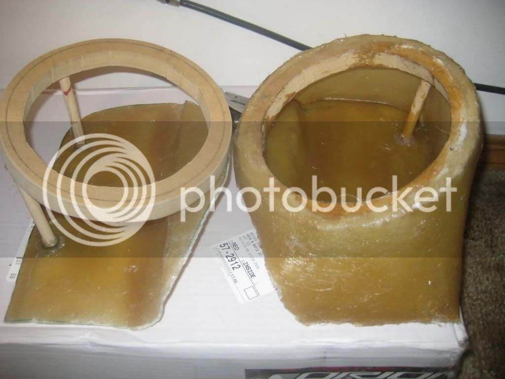

Alright, Pics uploading. I let it cure over night after soaking the T shirt in fiberglass. Now i need to do the inside seam's, Where the "base" met the t shirt. I understand i do that on the inside, However i need to strengthen the whole thing up. So do i go back to matting the outside of the pod, Or do i do the inside?
Also, Grinding where the base met the T shirt's gonna be fun, since all i got is 100 grit, and a palm sander.
Crease #1: [At the top you can see the dowel sticking out.]
Crease #2:
"Base":

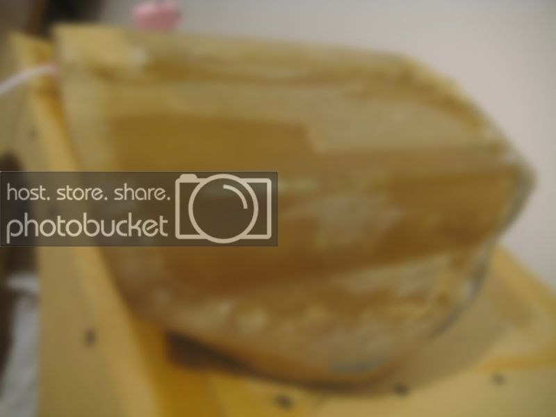

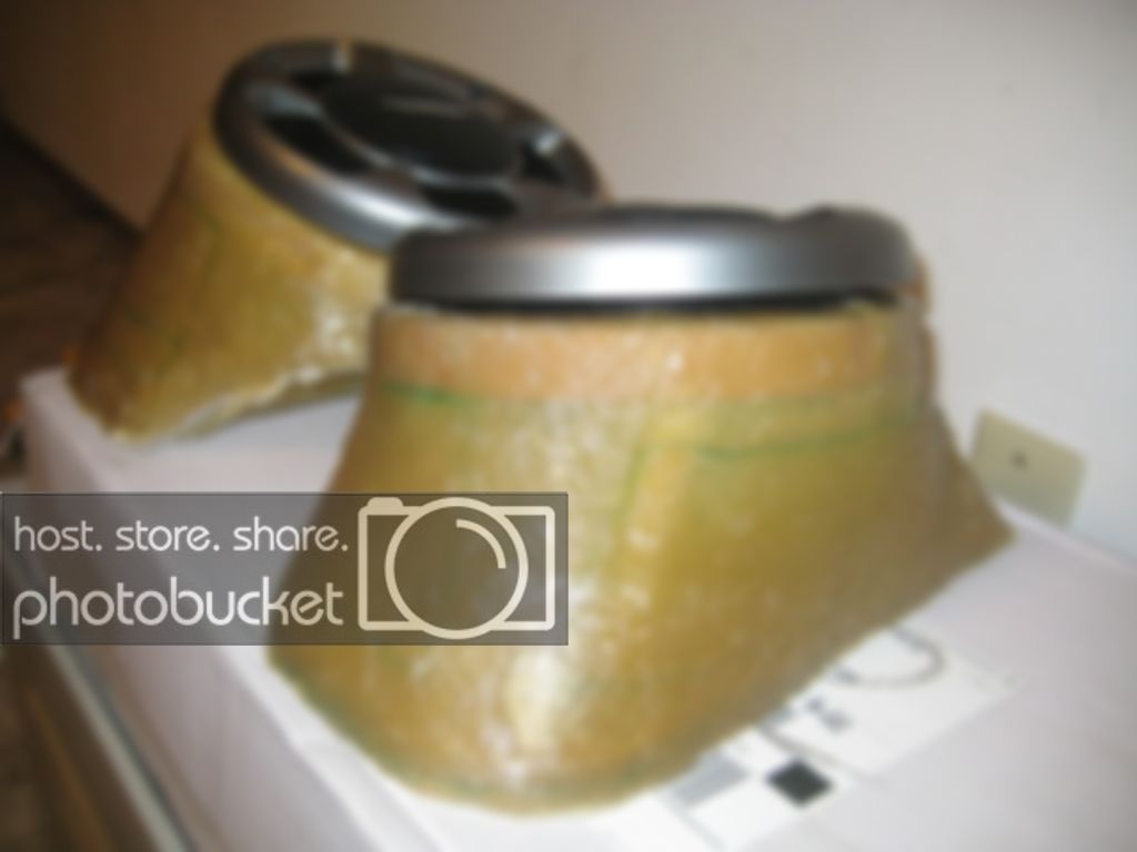

3 more layers of glass on the Driver's kick [First one i made.], And i used the backside of the Drivers side panel i had to make the Passenger side "Base". I then attempted to measure the dowles, And get the placment on both the ring and base about the same to give it the same contour's, Ect. But when i went to stretch the Tshirt material, Some of them were a bit off. So ill get to that tonight, And get them glassed up soon. I bet my imagings gonna be off a bit, since i dont have my car at the same house im working at. oh well, Atleast ill have them in the car where i can hear them, As well as have some experience with fiberglass.

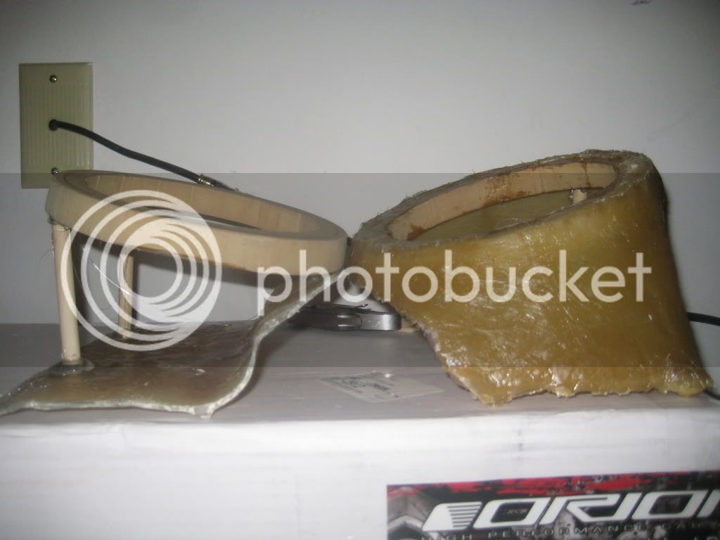

Right is driver, Left is pass [You can see in this picture, my front dowel on the pass kick isnt tall enough.]
Another view:

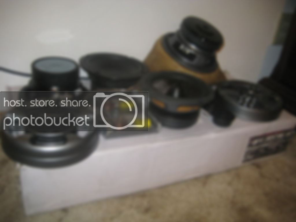

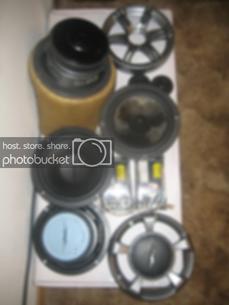

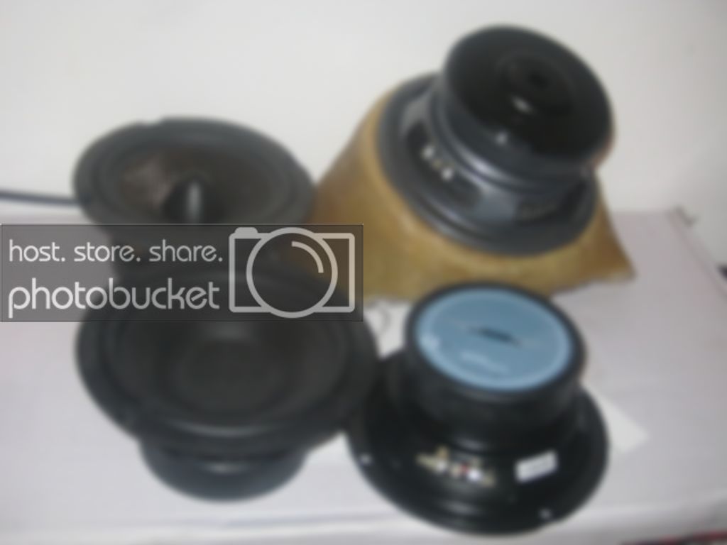

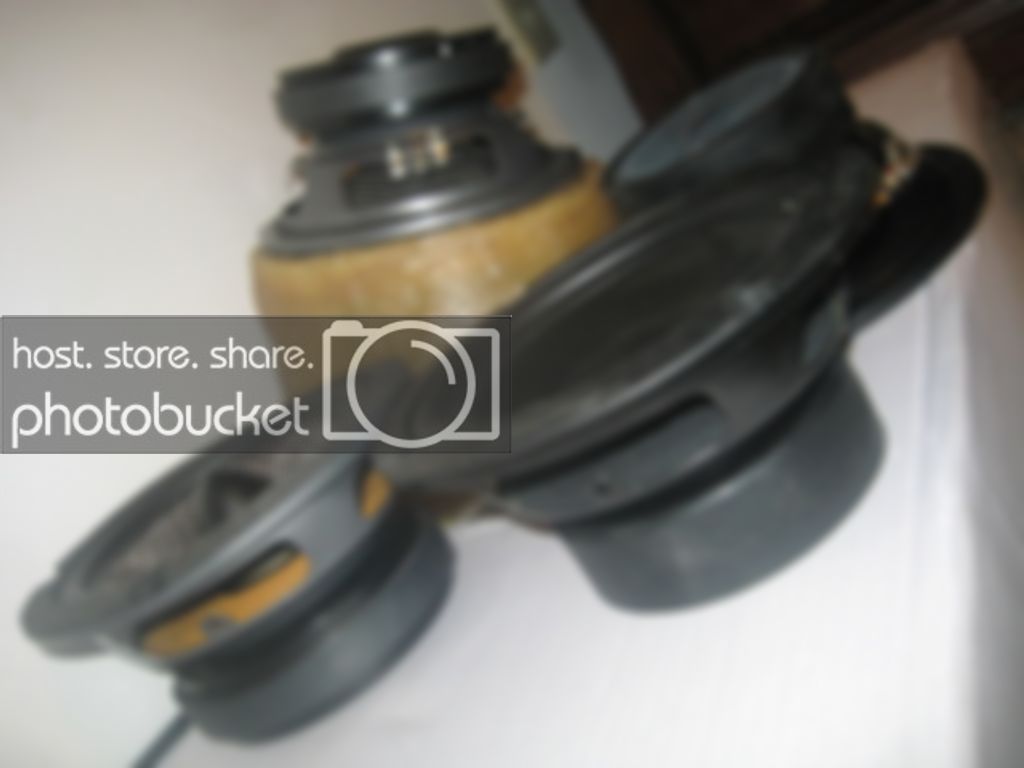

Mid's and High's Galore:
OEM's in the back, CTX65cs mid's in front.

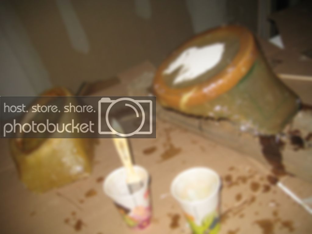

I got my other kicks ring repositioned and material stretched over it. They look pretty much identical right now, Except where the seams landed but that wont matter. Ill get it glassed up sometime tomarrow, Then next week ill try to get a dotco or grinder so i can start the sanding stage.

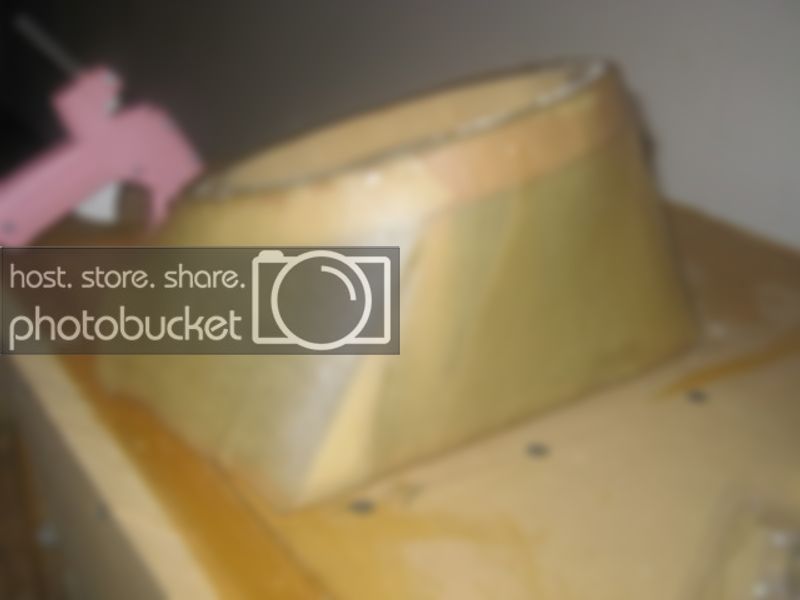

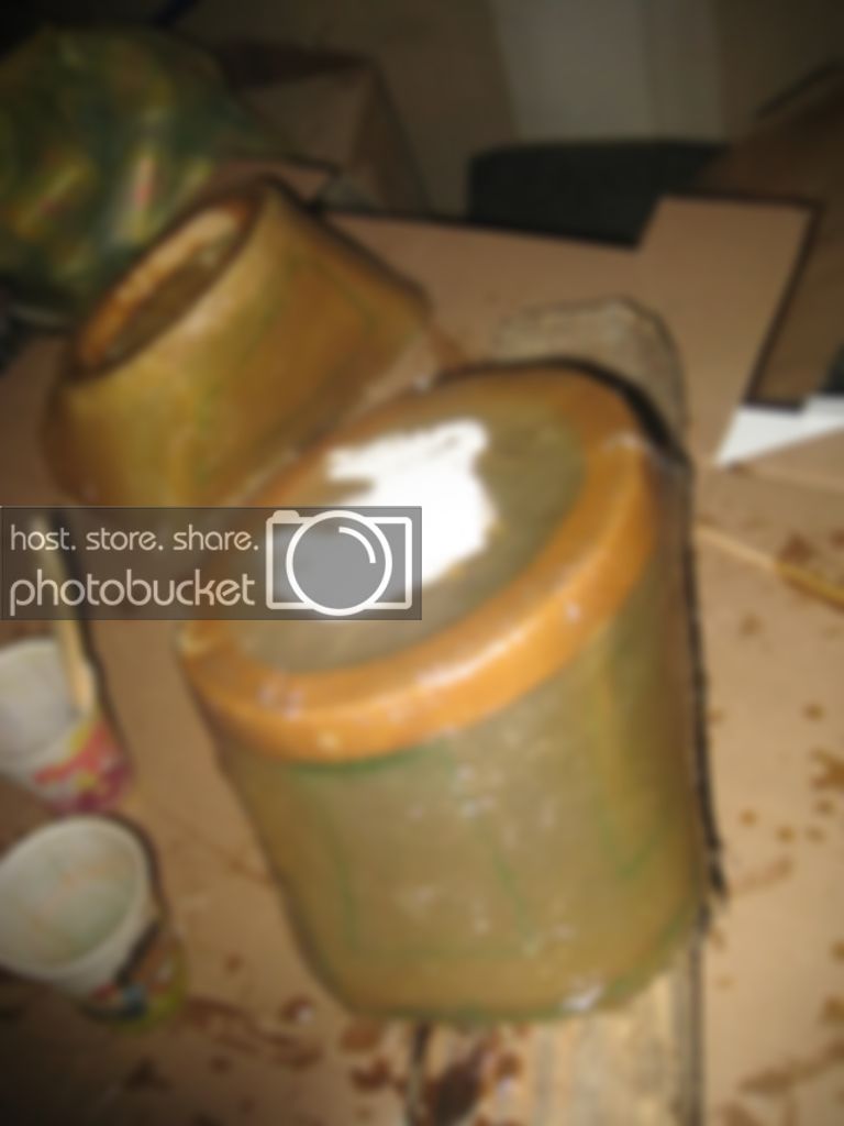

Green boxes are just areas i wanted to build out a little more with fiberglass vrs. bondo.
Time to buy an angle grinder or a 4" grinder to trim it a bit before i start to cover it with filler. Also need atleast 2 more layers of mat on the passenger side pod.

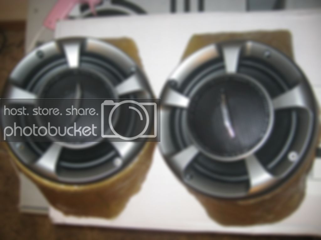

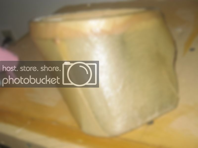

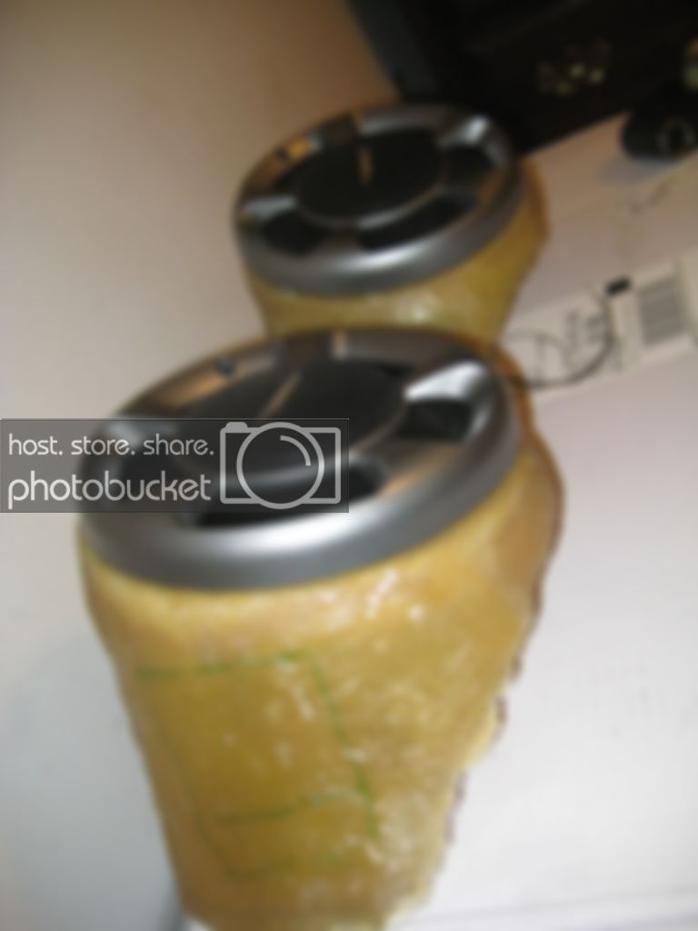

I got the hole cut for the mid, As well as cleaned up the "mating surface" as much as i could with a pair of Dikes and a Razor blade. Still gotta clean it up a bit to get the mid's to sit right tho. Here's a few pic's of the "Progress"

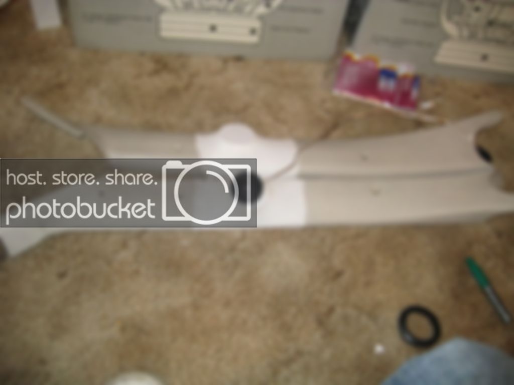

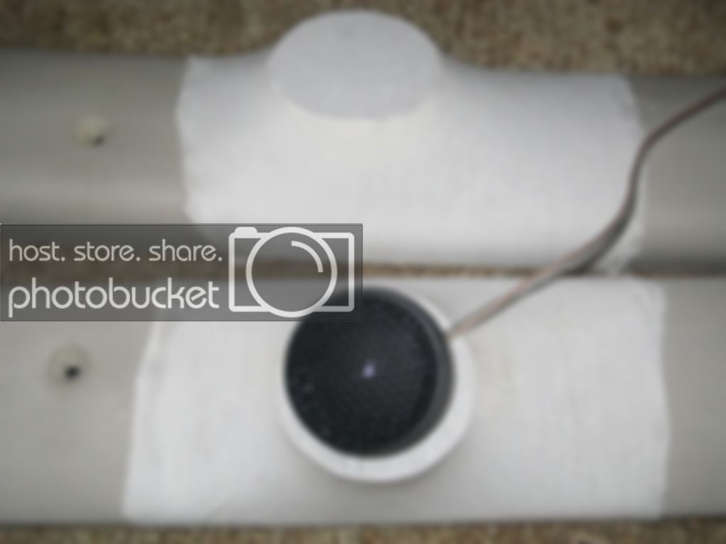

I also got bored, And decided to go at mounting my tweeter cups to my A pillar panels.
Got them glassed up, And curing at the moment.
