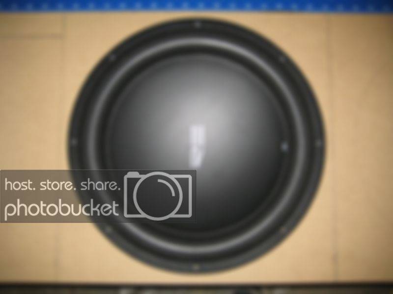

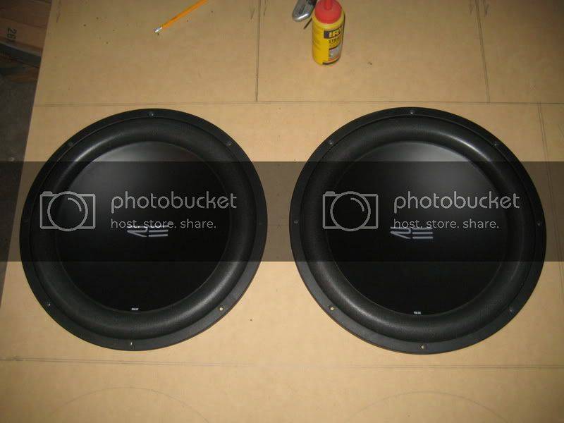

Panels drawn on 3/4" MDF, mounting holes cut out. Between the middle of the subs, There are mark's. This will be the center for the divider wall.

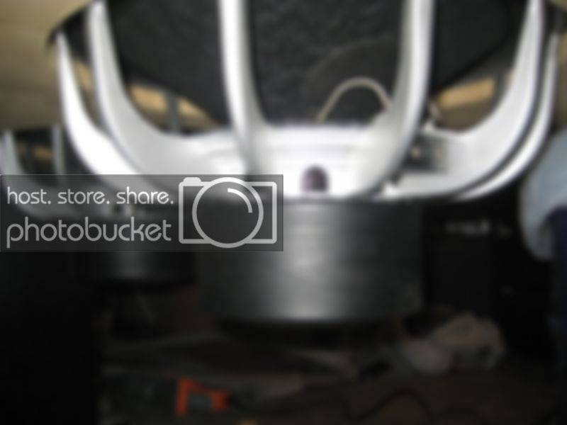

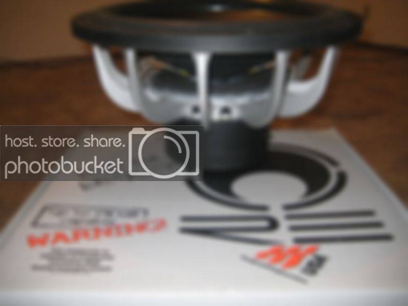

Baskets of these beasts

All of my "Depth walls" are seriously within a 1/2" from my subs mounting holes.
The straight edge in this photo is where the CENTER of the divider wall will be.
